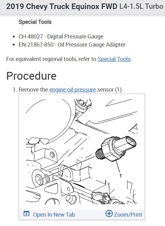

Looking for the location for my oil pressure sensor on my vehicle listed above.
Thanks!
Jan 27, 2024 at 12:43 AM
  • 55,748 POSTS
The oil pressure sensor is right above the starter motor, you might need to remove the starter to get at it. Check out the images (below). Let us know if you need anything else.
