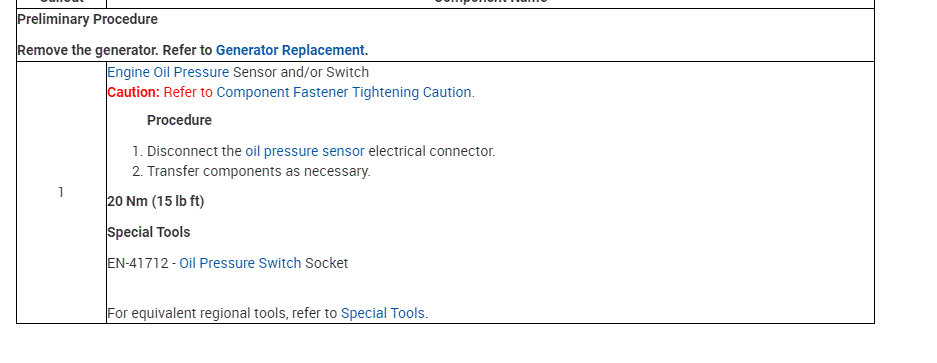

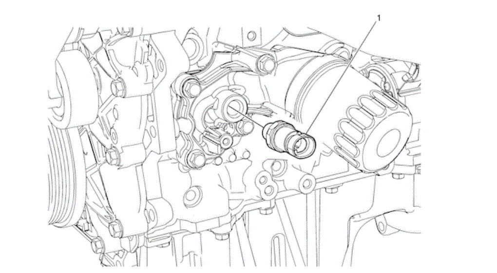

Where is oil pressure sensor located?
Aug 11, 2020 at 5:05 AM
Good afternoon,
I attached a picture of the location and the procedure for you.

I am replacing the sender because of a "low oil pressure/turn off engine immediately" warning.. engine sounds fine. changed oil recently.. so I replace the filter again to make sure it wasn't a faulty filter.. warning came back after a week. I didn't hear anything strange or feel any difference while driving and after research saw that this could be the issue. Thanks so much for your quick response.
Aug 11, 2020 at 5:33 AM
Change the sensor ans see if it stops. If it does not then you will need to have someone check the oil pressure manually with a gauge to be sure there is no issue.
