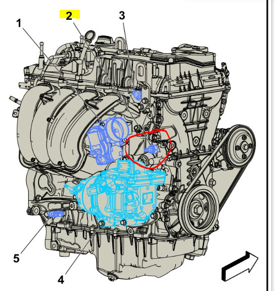

Code P05321, where is the oil pressure sensor located?

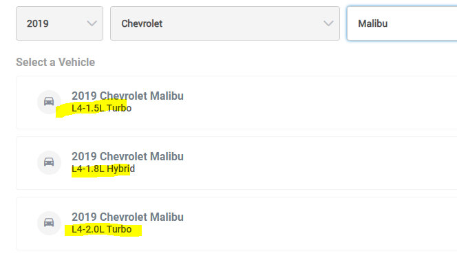

Please confirm the engine size for me. Is it a 1.5L? They offered three different engines. See pic 1 below.

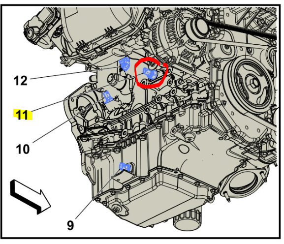

If it is the 1.5L, it could be in one of two places. I attached pics showing locations. Take a look and let me know if they help. Additionally, the code should be a P and then 4 digits. Please confirm that for me as well.
Take care and I'll watch for your reply.
Take care.,

RODPDP
Yes, it meant to type 1.5 liter.

No problem. I just wanted to make sure I was getting you the right information.
If you have a chance, let me know if you can find it. If you do, the connector can be a pain because there is a locking tab that you will need to slide out before you can release the connector. Just take your time so nothing breaks.

So it is under the alternator, right?
Jan 12, 2024 at 8:59 PM
  • 110,194 POSTS
Yes, it may not be directly behind it, but it should be in that general area.
Let me know if you find it.
