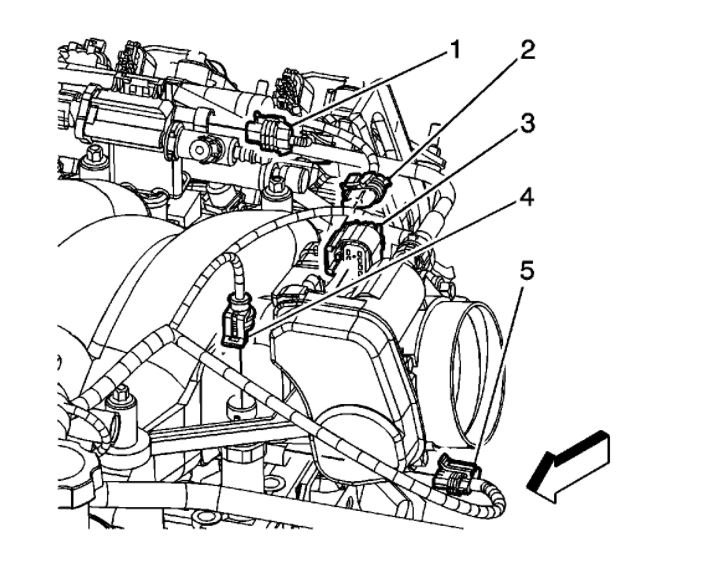

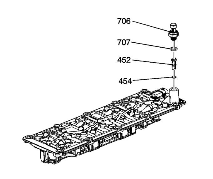

I need to know where the oil pressure sensor is located and how to remove it
Oct 19, 2020 at 10:28 PM
Good morning,
I attached the procedure for you for replacing the sender unit.
Engine Oil Pressure Sensor and/or Switch Replacement
Tools Required
J 41712 Oil Pressure Sensor Socket
Removal Procedure
1. If necessary, remove the engine sight shield. Refer to Upper Intake Manifold Sight Shield Replacement (See: Intake Manifold > Removal and Replacement) .
2. Disconnect the oil pressure sensor electrical connector (4).
3. Using J 41712 , remove the oil pressure sensor (706) and washer (707).
