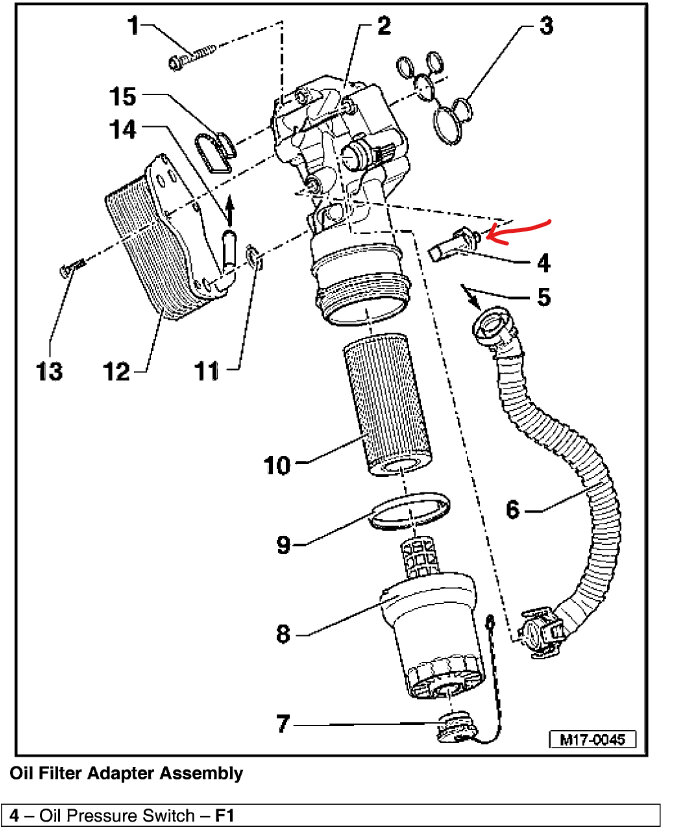

I just bought this car used with 80,000 miles on it might bring it home and I started looking over the car giving her a normal tune up and I saw that there was a sensor just hanging there it happen to be the pressure sensor but even with all the information online came seem to locate the actual location.

The oil pressure sender is usually near the oil filter. Please check the image below to see what I am talking about, check out the images (below). Please upload pictures or videos in your response of any problems so we can see what to help you with.
