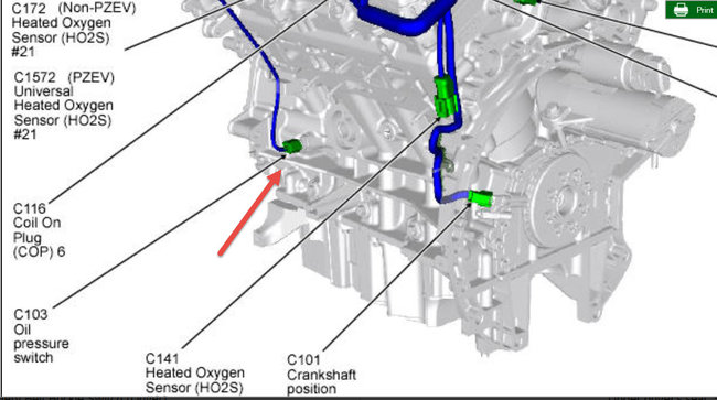

I am looking for the oil pressure sensor on my car listed above it has the v6. The engine oil light stays on so I want replace it.

see picture for location A/C compressor may be in way so check as picture is no accessories on it. Check out the diagrams (Below). Please let us know if you need anything else to get the problem fixed.

Oil Pressure Switch (3.0L 2V)On right rear of engine block.
Oil Pressure Switch (3.0L 2V FFV)On right rear of engine block.
Oil Pressure Switch (3.0L 4V)On left front side of engine block

where is the oil presure swith located and is this a simple replacement?

It should be near the oil filter.

Thanks for the answer, I did find it on the top of the engine, on the right rear (facing from front), close to the firewall.
