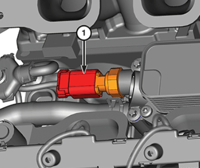

Trying to find the oil pressure sensor/switch to replace

Yep, you cant find it because it is under the intake manifold, so the intake will need to be removed. Also, if the engine is leaking oil the oil filter adapters have a high failure rate so while you are there replace it as well. Check out the images (below). Let us know how it goes. Ken
