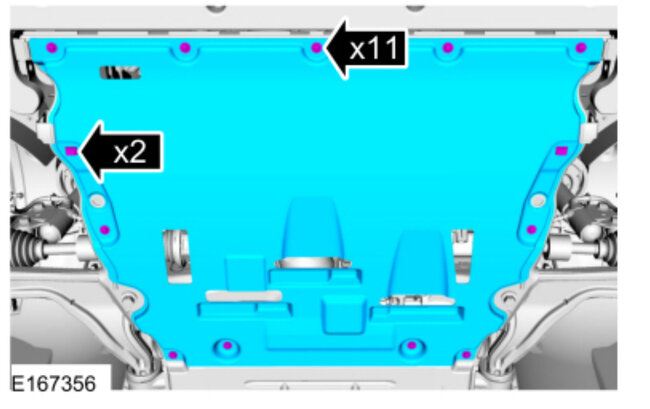

Location of oil pressure sensor?
Mar 8, 2025 at 6:21 PM
CANNON1349
  • 861 POSTS

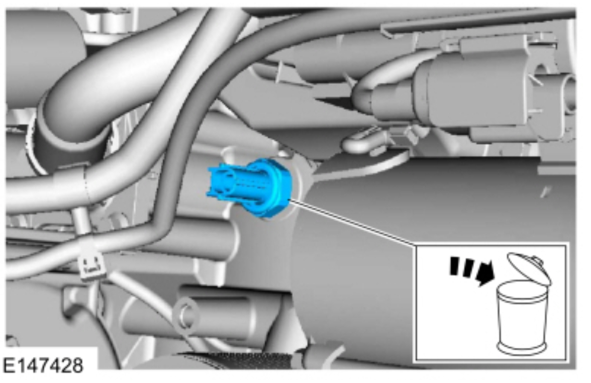

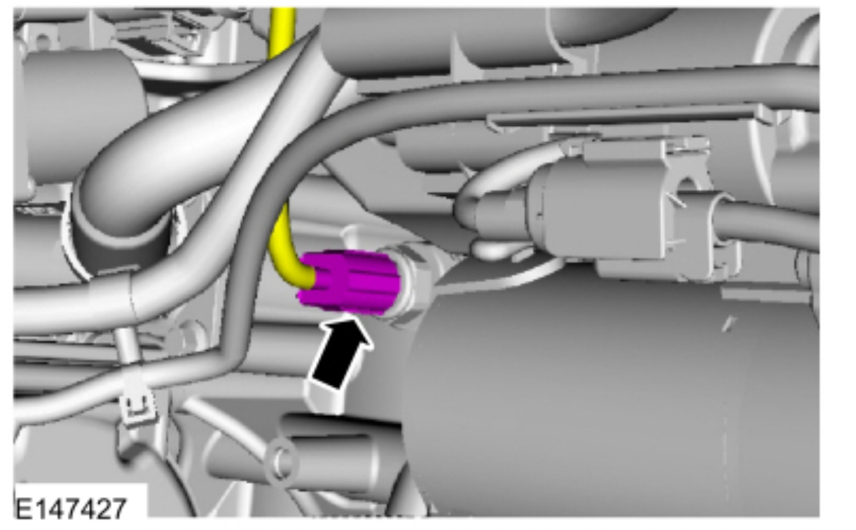

Hello, it seems like the pressure switch is behind the oil filter. I would prepare to change the oil during this repair. Please refer to the instructions and pictures attached.
Removal
With the vehicle in Neutral, position it on a hoist.
Remove the retainers and the engine under shield.

Remove and discard the engine oil filter.
Disconnect the engine oil pressure switch electrical connector.
(image 2)
Remove and discard the engine oil pressure switch.
(image 3)
