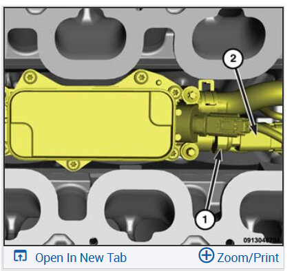

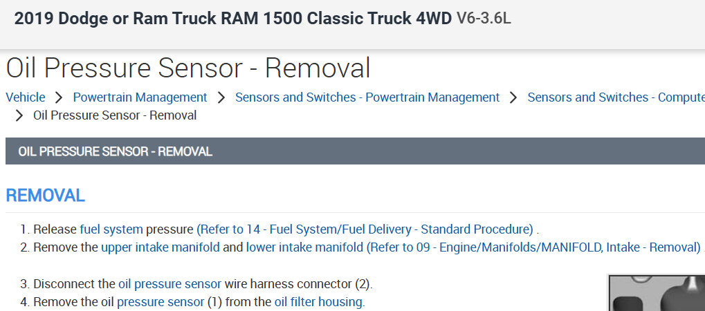

I just want a video on how to replace the oil pressure sensor in the truck listed above 1500, 3.6l VVT.
Dec 5, 2024 at 11:55 PM
  • 55,797 POSTS
The oil pressure sensor is under the intake manifold, I would replace the oil cooler as well because the OEM unit is made of plastic, the after-market units are made of metal. Check out the images (below). Let us know if you need anything else.
