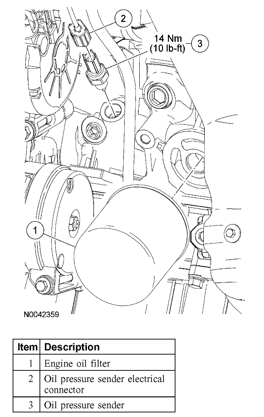

oil pressure sensor location
2006 FORD FUSION
95,000 MILES • 3.0L • V6 • 2WD • AUTOMATIC
FUSIONFIX
locate and replace the oil pressure sensor.

It is just above and to the left of the oil filter. Remove the underbody cover if it has one. Then remove the oil filter to get a bit of room for the wrench. Remove the electrical connector and unscrew the sender. Apply a bit of teflon thread sealant to the new one and screw it in, tighten to around 10 ft lb and reconnect the wiring. Install a new oil filter. Reinstall the underbody cover.
