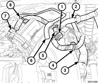

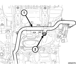

oil pressure sensor location needed
2014 CHRYSLER TOWN AND COUNTRY
125,000 MILES • V6 • 2WD • AUTOMATIC
IRONDAN1965

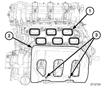

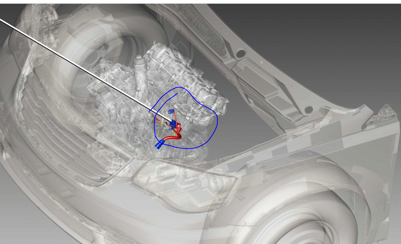

check engine light on, O'Reillys said could be loose connection. where is it located?
Dec 8, 2020 at 3:16 PM
  • 110,194 POSTS
The oil pressure sensor is located under the intake manifold. They have a history of failing. Can you tell me what code was retrieved? Also, if you look at pic 1, it shows location. Note that the pic doesn't show the intake manifold.

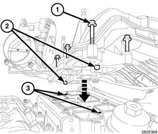

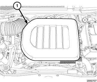

Here are the directions for removal and replacement. The attached pics correlate with the directions.
_______________________________
2014 Chrysler Truck Town & Country V6-3.6L
Oil Pressure Sensor - Removal
Vehicle Powertrain Management Sensors and Switches - Powertrain Management Sensors and Switches - Computers and Control Systems Oil Pressure Sensor Service and Repair Removal and Replacement Oil Pressure Sensor - Removal
OIL PRESSURE SENSOR - REMOVAL
REMOVAL

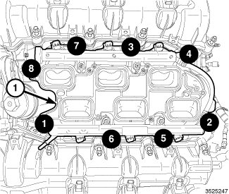

Remove the upper intake manifold and lower intake manifold (Refer to 09 - Engine/Manifolds/MANIFOLD, Intake - Removal) .
Pic 2
Disconnect the oil pressure sensor wire harness connector (2).
Remove the oil pressure sensor (1) from the oil filter housing.
_______________
Installation is the opposite of removal.
_______________

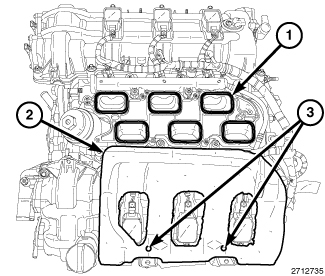

Here are the directions for the removal of the intake manifold. Note there is an upper and lower manifold. I will provide the directions for both.
_______________
Intake Manifold - Removal (Upper)
Vehicle Engine, Cooling and Exhaust Engine Intake Manifold Service and Repair Removal and Replacement Intake Manifold - Removal (Upper)
INTAKE MANIFOLD - REMOVAL (UPPER)
Upper Intake Manifold
pic 2
Disconnect and isolate the negative battery cable.
Remove the engine cover (1).
Drain the engine cooling system (Refer to 07 - Cooling - Standard Procedure)

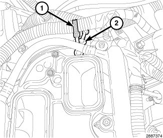

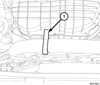

pic 3
Disengage the upper radiator hose retainer (1) from the upper intake manifold.
Remove the engine cooling fan and shroud assembly (Refer to 07 - Cooling/Engine/FAN, Cooling - Removal) .
Remove the intake resonator (Refer to 09 - Engine/Air Intake System/RESONATOR, Air Cleaner - Removal) .

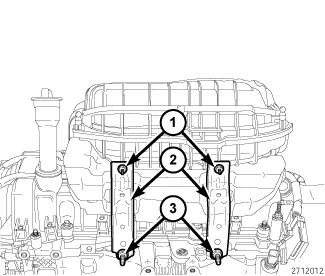

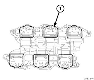

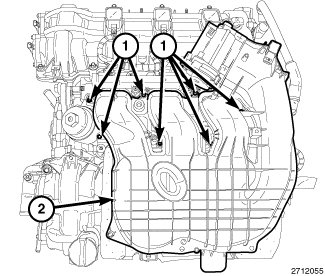

pic 4
Disconnect the electrical connectors from the Manifold Absolute Pressure (MAP) sensor (1) and the Electronic Throttle Control (ETC) (7).
Disengage the ETC harness from the clip (8) on the throttle body. Disengage the wire harness retainers (4 and 5) from the upper intake manifold near the MAP sensor and reposition the wire harness.
Disconnect the following hoses from the upper intake manifold:
Positive Crankcase Ventilation (PCV) (3)
vapor purge (6)
brake booster (2)

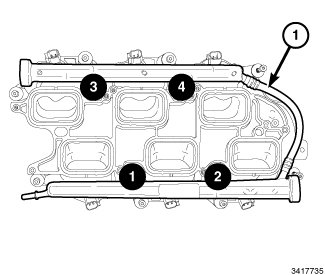

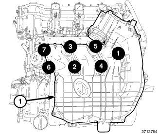

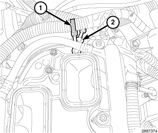

pic 5
Disengage the wire harness retainer (4) from the upper intake manifold support bracket (5).
Disengage the wire harness retainer (3) from the studbolt (2).
Remove two nuts (1), loosen the studbolt (2) and reposition the upper intake manifold support bracket (5).

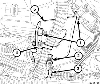

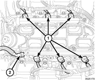

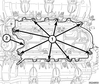

pic 6
Remove the nut (2) from the support bracket of the heater core return tube (1).
