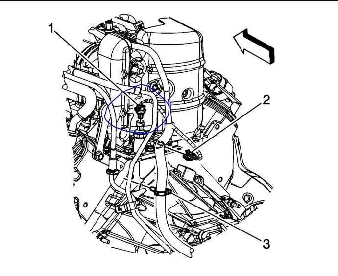

I have changed the oil pressure sensor for the third time and also the screen inside of it. Except the last time I remove it and did not put it back. Can someone explain why it keeps going bad.

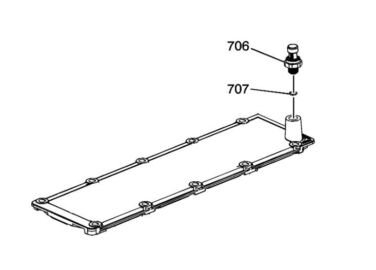

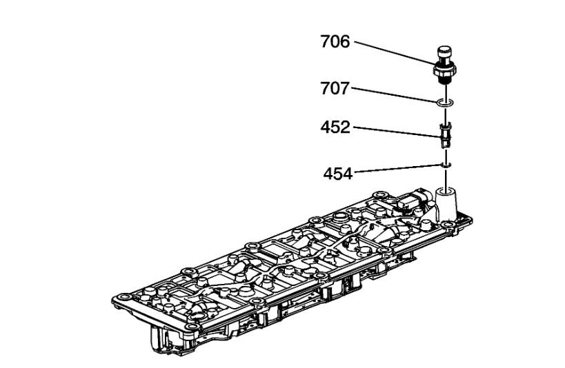

I attached the procedure for you and some pictures.
As far as the constant failure, what brand switch are you using? Quality matters with parts. I would use an OEM from the dealer. That will last the longest.
Engine Oil Pressure Sensor and/or Switch Replacement
Special Tools
J 41712 Oil Pressure Switch Socket
Removal Procedure
1. Remove the intake manifold. Refer to Intake Manifold Replacement (Without AFM) (See: Intake Manifold > Removal and Replacement)Intake Manifold Replacement (With AFM) (See: Intake Manifold > Removal and Replacement).
2. Disconnect the engine harness electrical connector (1) from the oil pressure sensor.
3. If not equipped with active fuel management perform the following step, using J 41712 or equivalent, remove the oil pressure sensor (706) and washer (707).
4. If equipped with active fuel management perform the following step, using J 41712 or equivalent, remove the oil pressure sensor (706) and washer (707).
