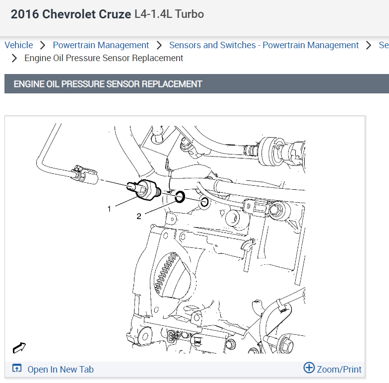

Hi, we just changed the oil filter and are currently trying to locate the oil pressure sensor in my vehicle but I am having a hard time. Can someone help?

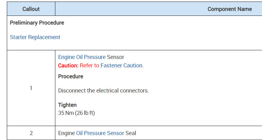

It looks like the oil pressure sensor is on the right side on the engine above the starter motor, here are the diagrams of its location and how to replace it. Check out the images (below). Let us know if you need anything else.
