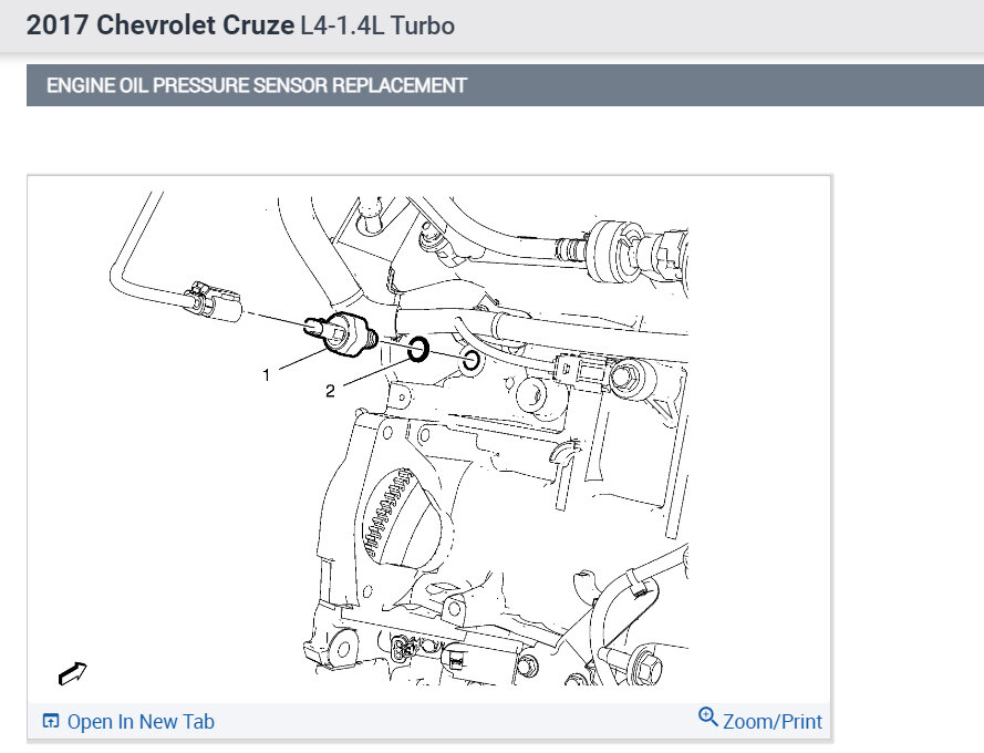

Where is the oil pressure sensor on my car?
Jan 19, 2023 at 4:33 PM
Experienced Mechanic
55,721 POSTS

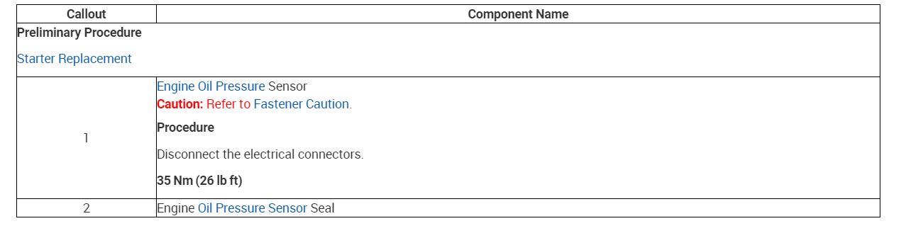

The oil pressure sensor is on the engine block near the rear on the right side of the engine above the starter, check the images below for the exact location.
