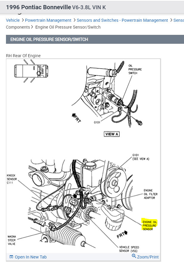

Oil pressure moving on the dash.
Jan 19, 2022 at 8:43 AM
SQM
  • 6,383 POSTS

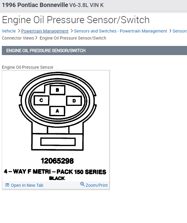

The oil pressure sensor is located right next to the oil filter (see diagram below).
A faulty sensor can make the gauge move at a random rate or fluctuate.
Keep in mind that it is also possible to have a faulty gauge.
Does the pressure read high or low?
As you know there is always a possibility of inadequate oil pressure due to a weak pump.
https://www.2carpros.com/articles/high-or-low-engine-oil-pressure
