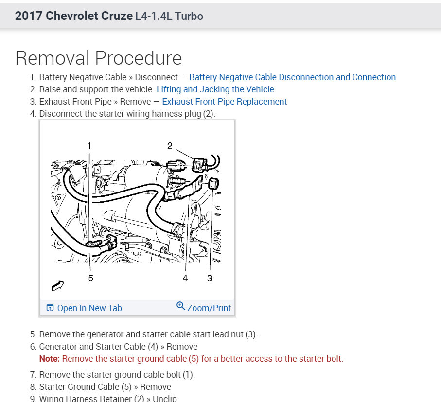

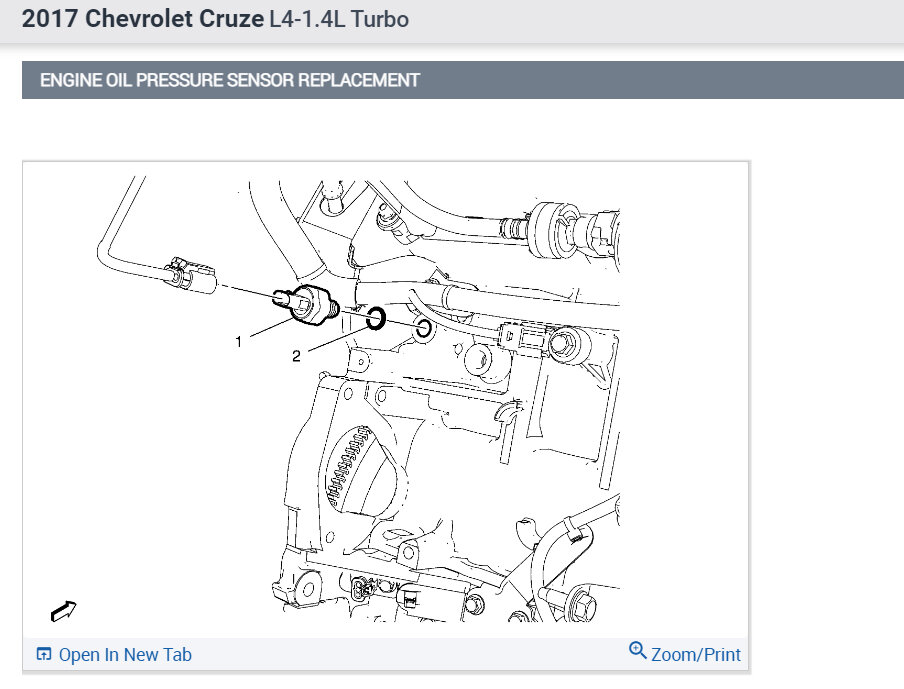

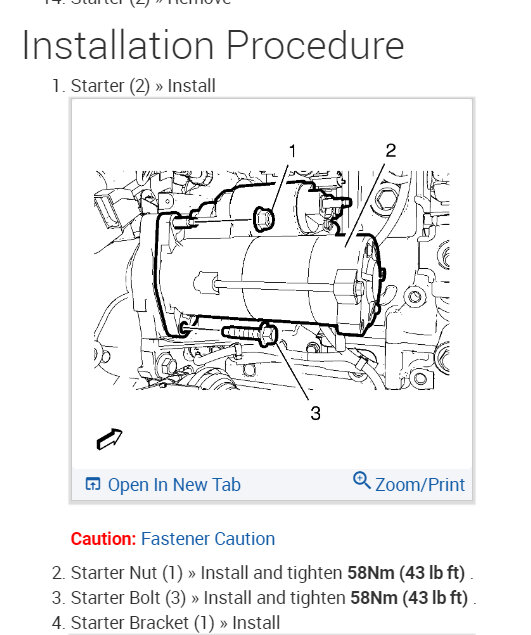

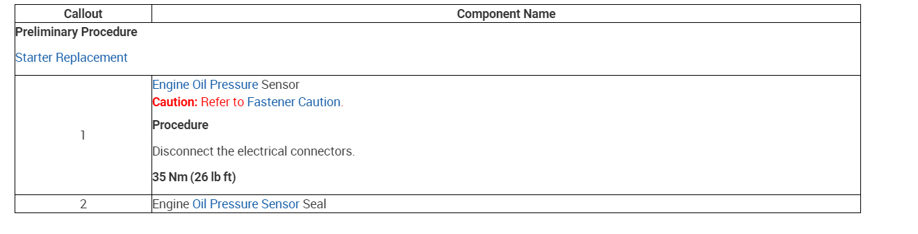

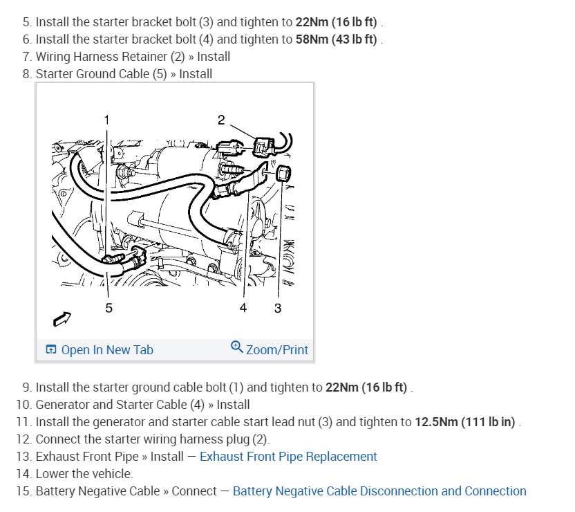

I know where the oil pressure sensor is located, but how do I get it out? I can go in from the bottom but can only get one hand to it. is there any way to come in from the engine bay?
Feb 18, 2023 at 11:15 AM
  • 55,770 POSTS

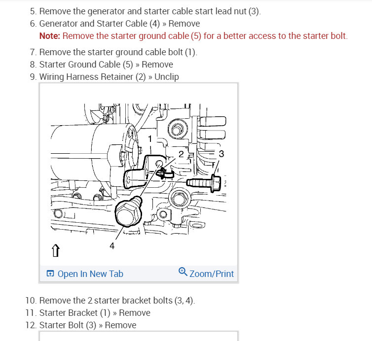

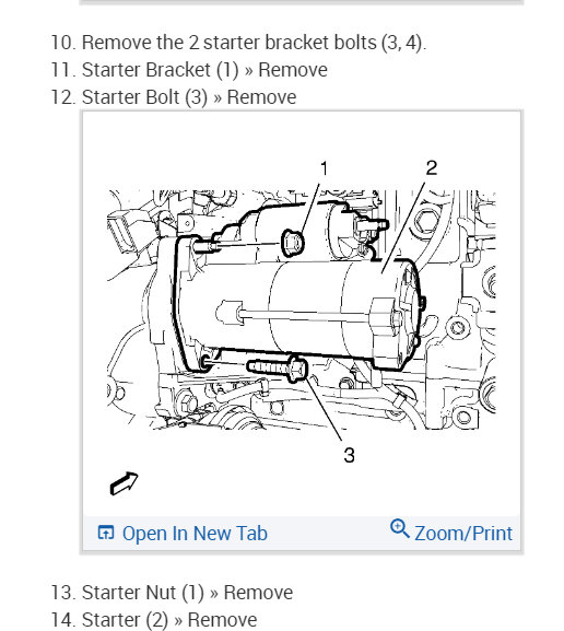

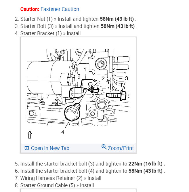

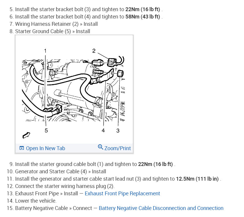

The oil pressure sender is on the passenger's side of the block and slightly above the starter, which will need to be removed prior to the sensor replacement. Here are the instructions on doing the job in the images below. Please let us know if you need anything else.
