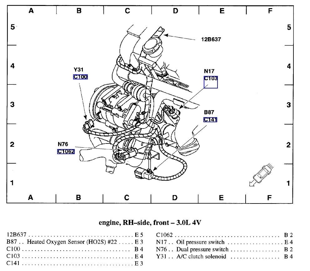

Where is the oil pressure sensor located?

Top, rear of the engine. The side depends on which engine you have. I was able to find a drawing for one version. It is item N17 in this drawing. If this does not appear to be the same, list the details of your engine or the VIN for your car.
