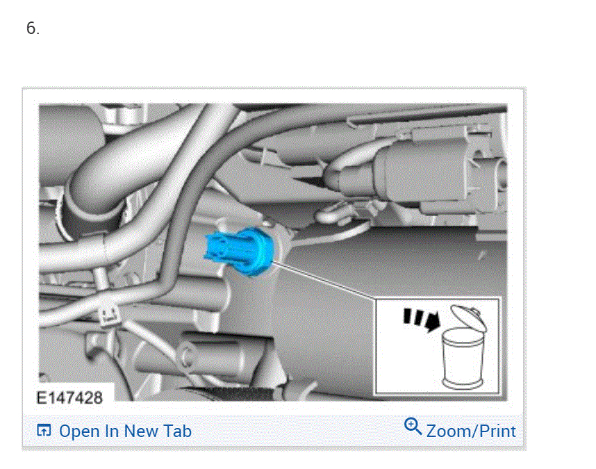

oil pressure sensor location.
Nov 10, 2021 at 10:03 AM
  • 110,251 POSTS

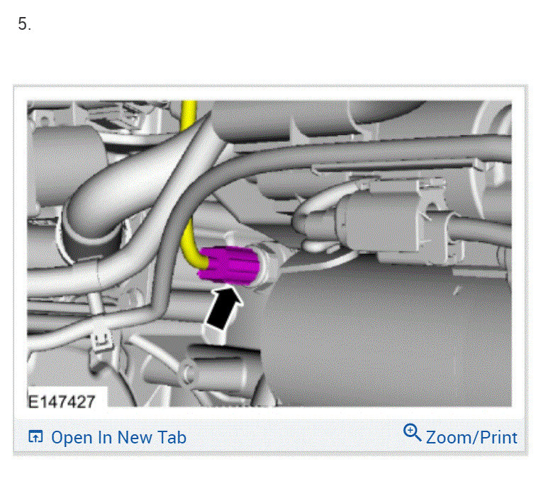

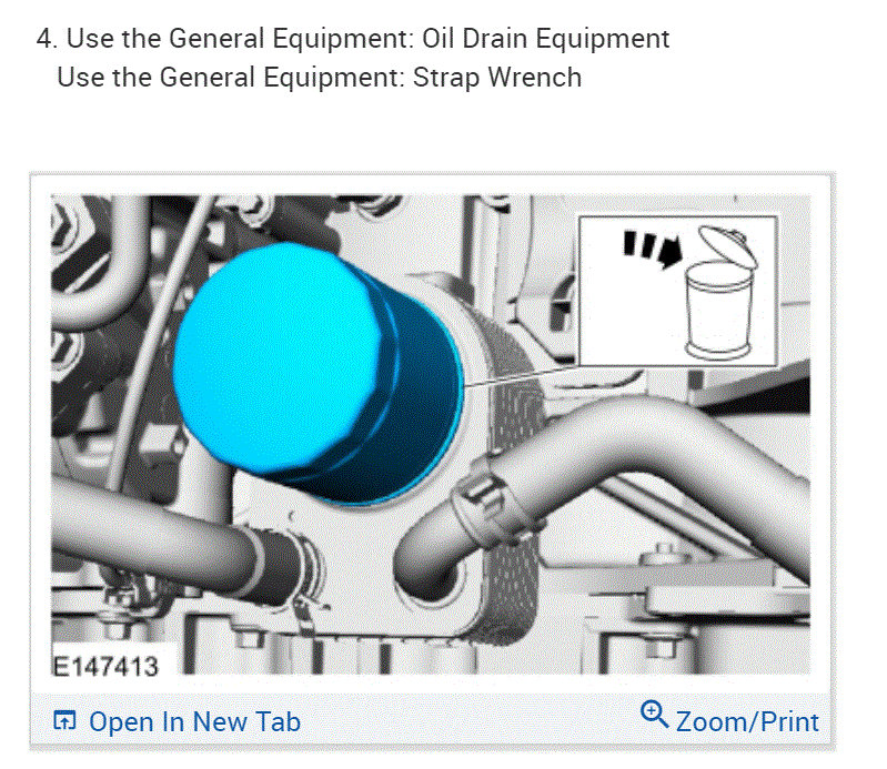

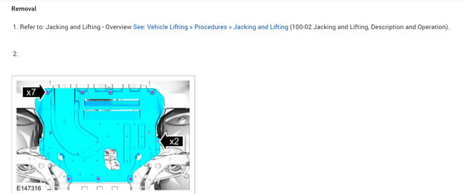

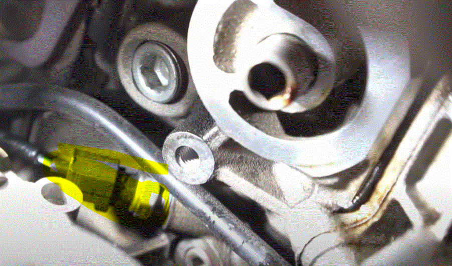

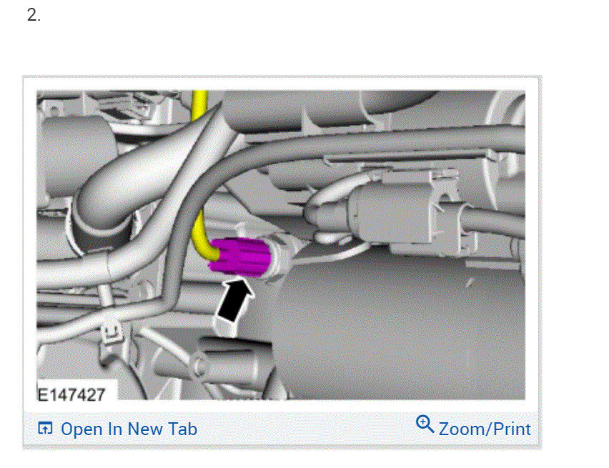

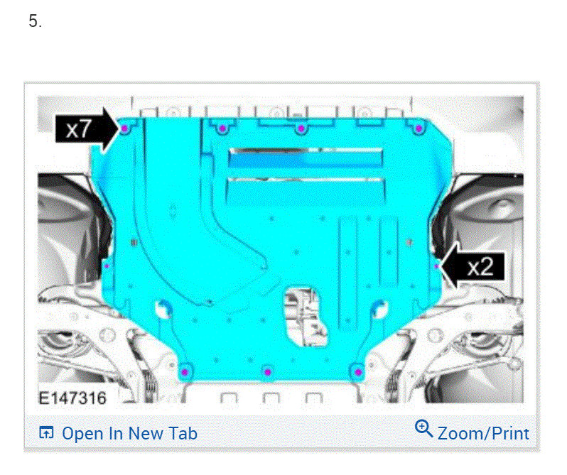

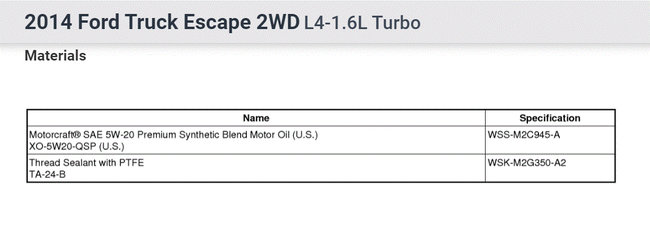

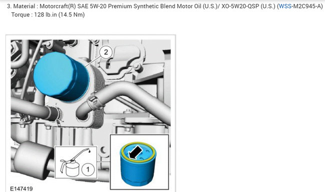

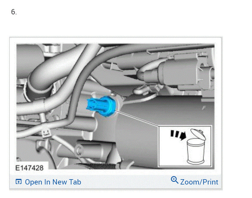

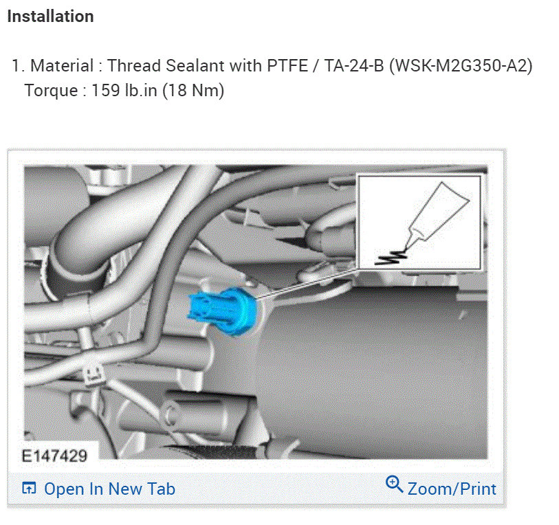

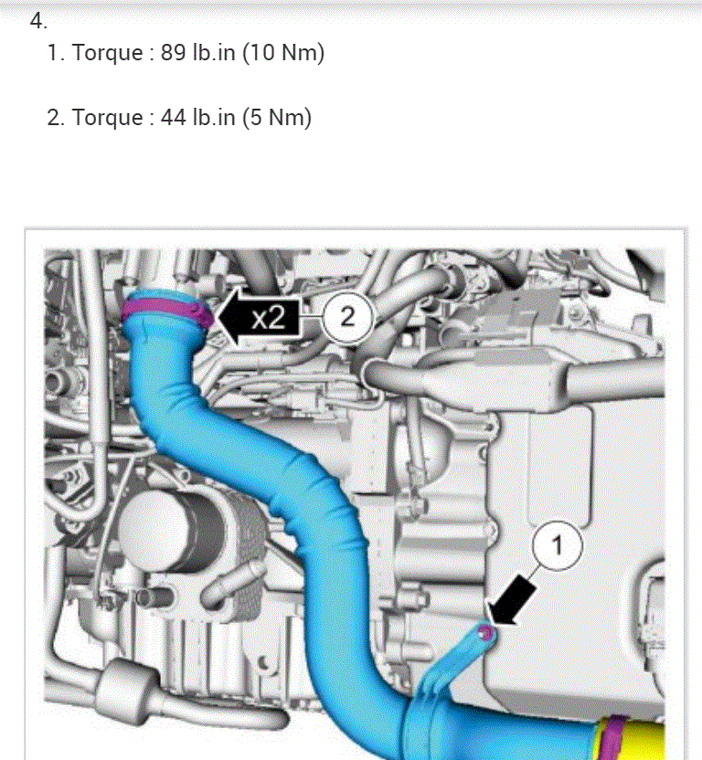

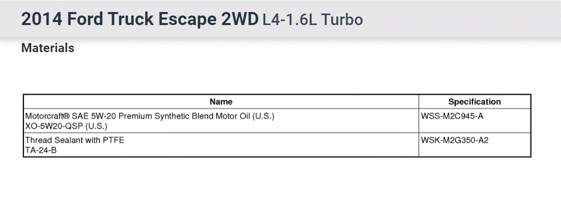

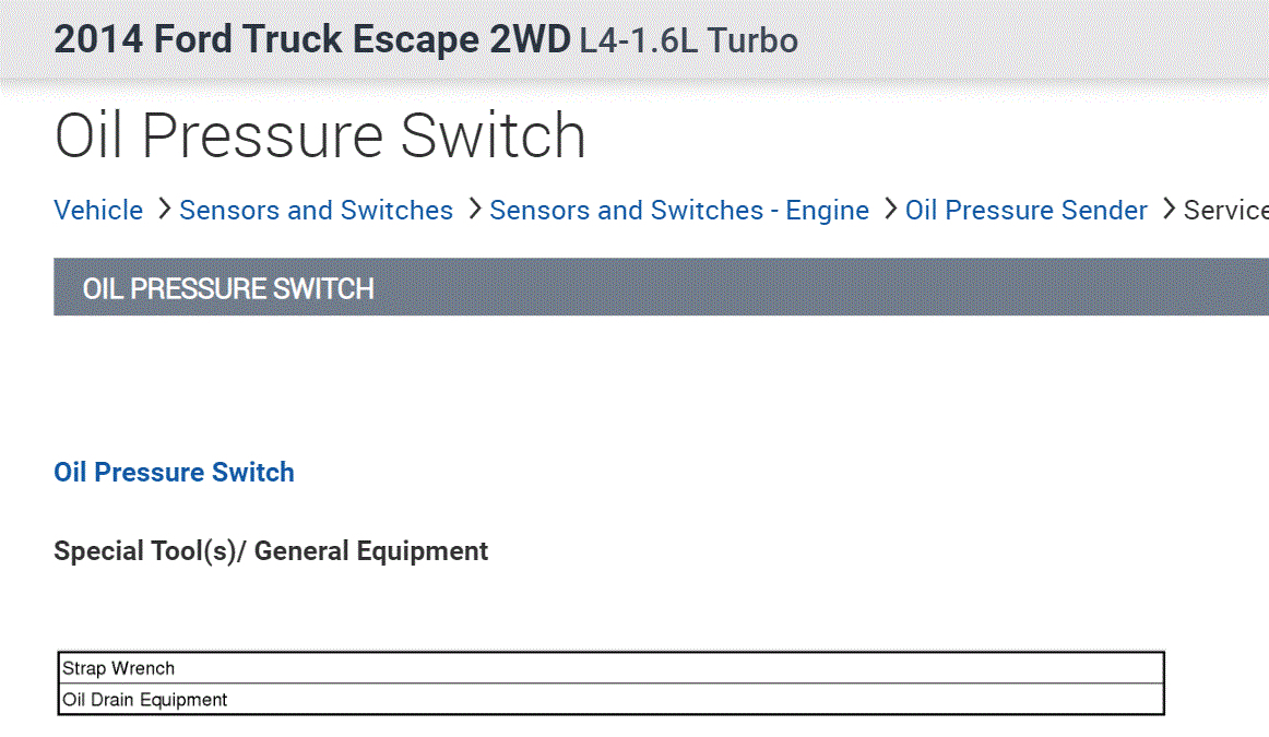

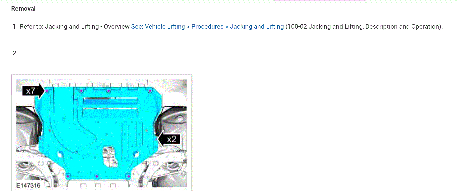

On this engine, it is somewhat hidden behind the oil filter. To replace it, the oil filter will need to be removed, so this is a good time to change the oil.
If you look at pic 1, I attached a picture of its location after the oil filter has been removed. The remaining pics are from my manual that shows the procedure for replacement.
I hope this helps. Let me know if you have other questions or if I can help in any way.
Nov 10, 2021 at 12:53 PM
Suggested Repair
The oil pressure sensor is hidden behind the oil filter. Remove the oil filter to access and replace the sensor, and change the oil at the same time.
