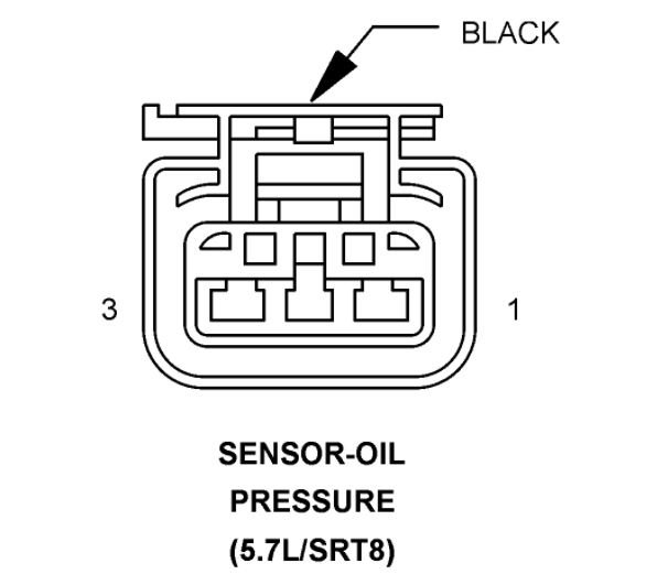

How do I measure output for the oil pressure sensor on my car listed above 300c 5.7l hemi?
Wednesday, January 6th, 2021 AT 3:23 PM
  • 52,797 POSTS
Good evening,
I attached the connector diagram for you. In order to test the output, you need to back probe the signal wire while the engine is running. When you increase and decrease the RPM, the voltage should change between 0 and 5 volts.

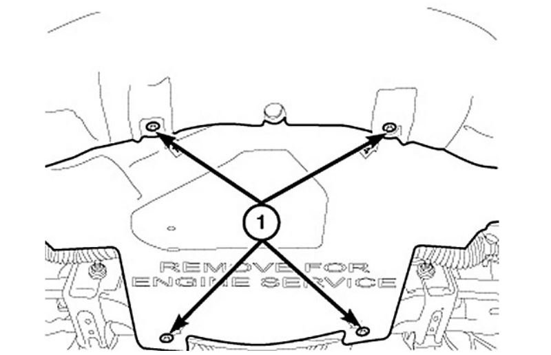

5. Remove the lower splash shield retaining bolts (1) and the splash shield.

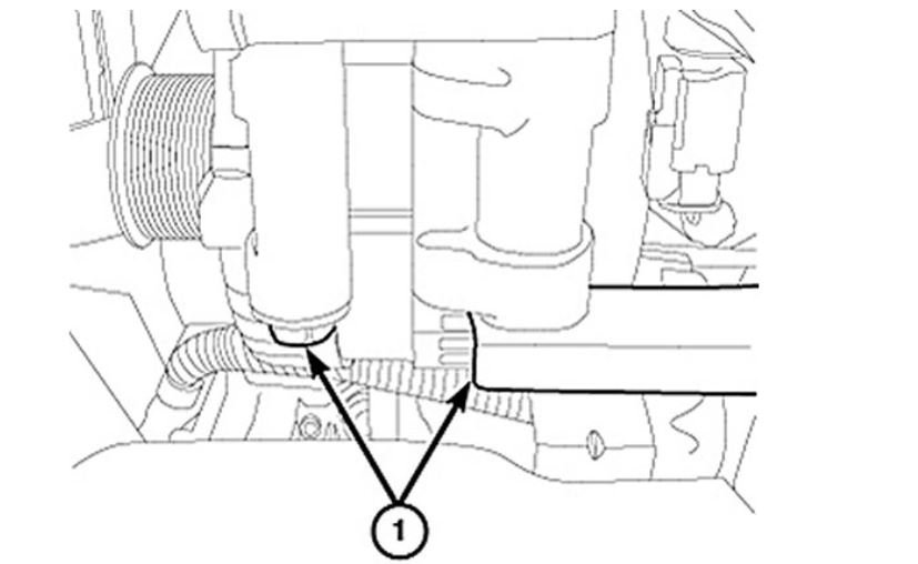

6. Remove the lower generator retaining bolts (1).

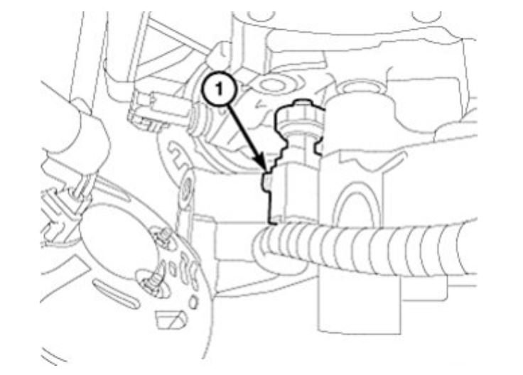

8. Position the generator aside to gain access to the oil pressure sensor.
9. Disconnect the oil pressure sensor electrical connector (1).

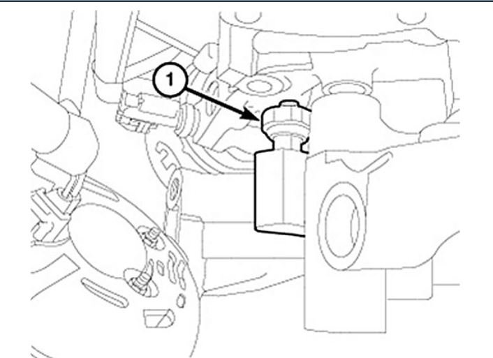

10. Remove the oil pressure sensor (1).
