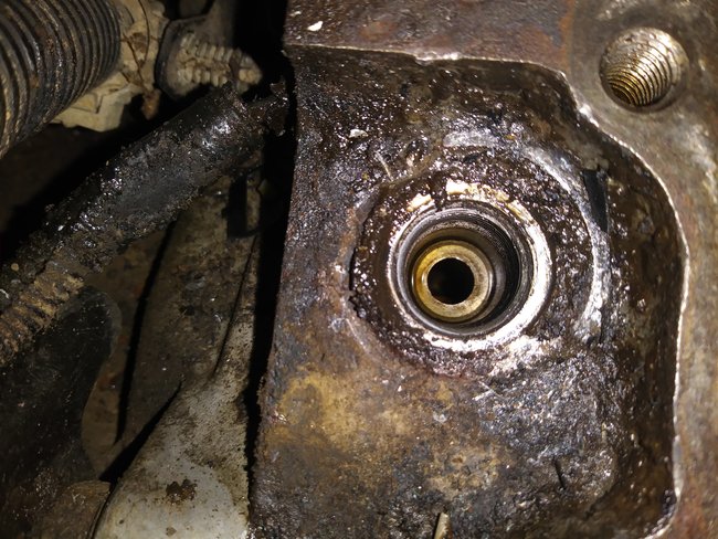

The nut on my oil pressure regulator is rounded off the socket that removes it just slips. I sprayed brake cleaner around it. Would that in anyway compromise the extraction of it?

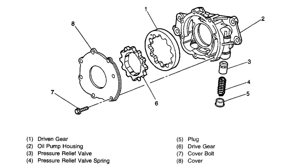

Do you mean the oil pressure switch or the regulator in the oil pump? Number 5 in the picture.

It is the regulator. It is on the back of motor by the crank shaft sensor. I think has a long gated black plug and the nut has a smash washer screws right into the block.

Can you post a picture of what you see?

I got. Ended up braking it at nut mushroom the head of bolt and it grabbed it the socket. Is there supposed to be a screen in there. I know Chevrolet started regularly in 2007 with them I have read it is yes and no with the 99.

Here is another picture of oil pressure regulator.

No, no screen for that one needed.
Why are you replacing this?
