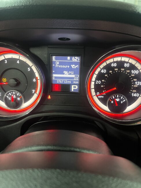

Oil pressure reading stuck on 96 PSI?
176,000 MILES • V8 • 2WD • AUTOMATIC
BHAMDOC1973
  • 2,007 POSTS
It is stuck on 96, and sometimes i get the code for oil sensor circuit.

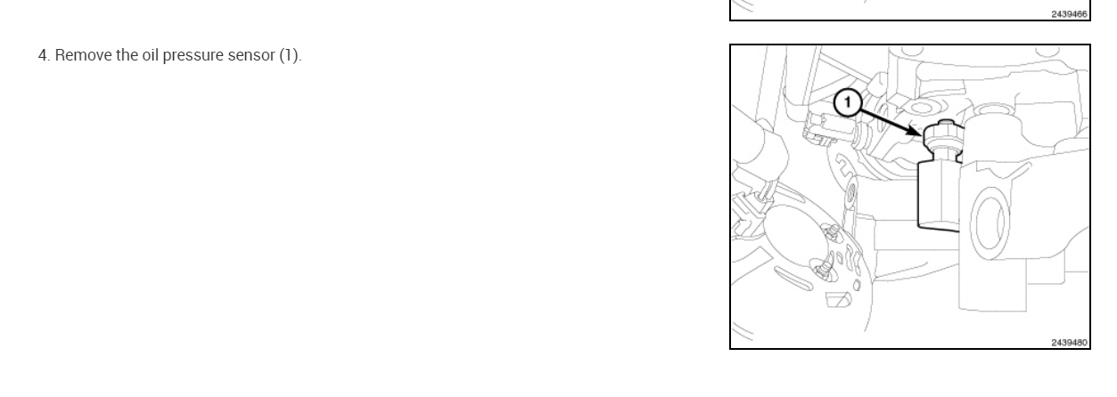

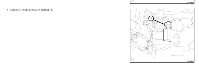

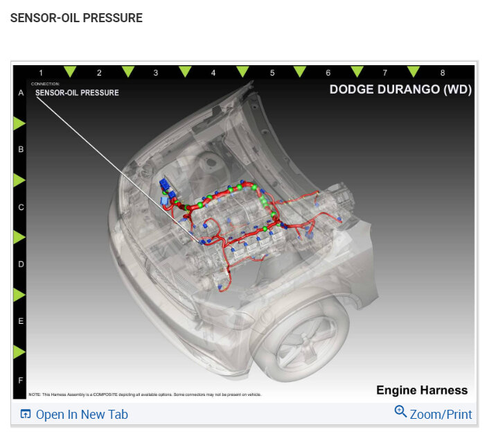

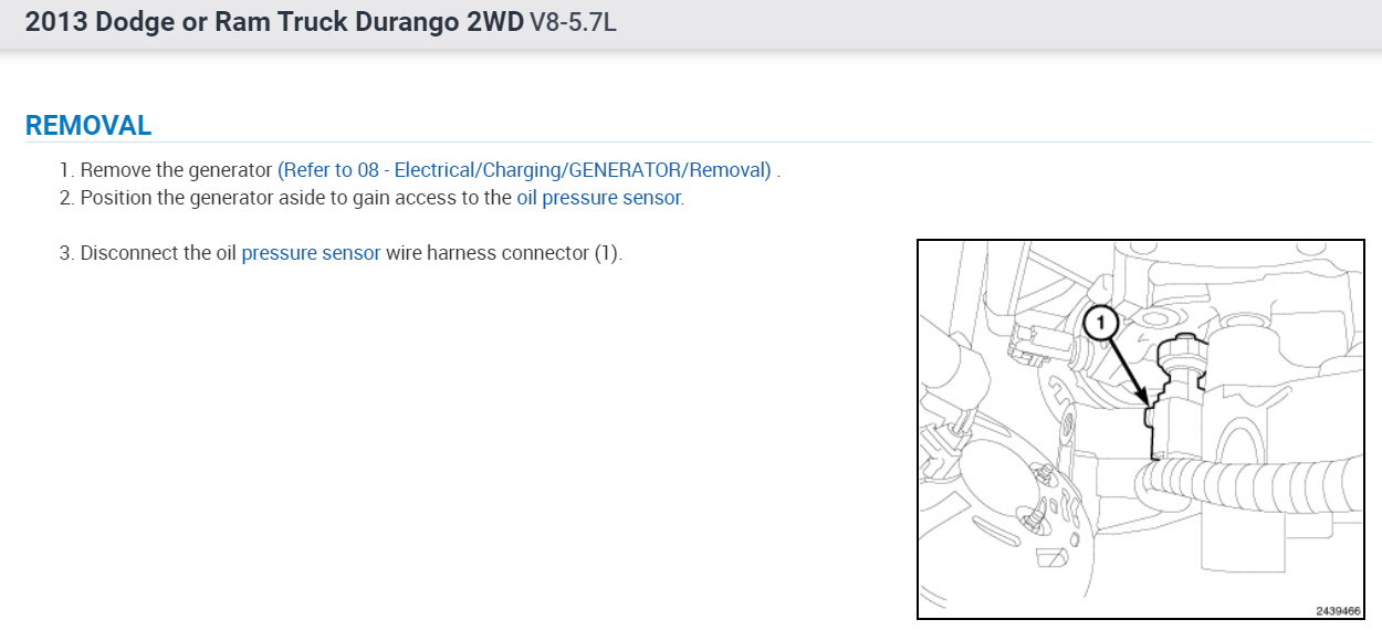

It looks like the oil pressure sensor has gone out, I would swap it for a new one. here is the location in the images below. Check out the images (below). Please let us know what happens.
Mar 21, 2023 at 4:09 AM
BHAMDOC1973
  • 2,007 POSTS
I replaced it and it's now working. Now i have p0198.
