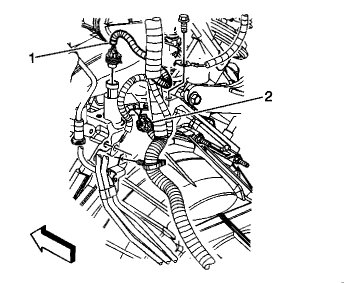

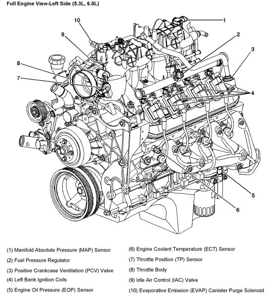

So I changed my plugs and plug wires. Upon starting it the oil gauge now shoots to 80 psi and then drops to zero like it is not working at all. Sometimes it shoots back up to 80 but there is no fluctuation like there would be if it was working. Also, the temperature gauge now refuses to go up. It stays on the cold side and will not rise. Also, immediately the check engine light came on with a p0641 code. 5 volt reference one circuit malfunction. I do not see any sensors I could of knocked loose. I did forget to plug a wire into coil one and it sparked when I started it. But I have heard of people doing that just to test for spark. Could that of shorted something?
Jun 26, 2018 at 9:12 AM
  • 110,244 POSTS

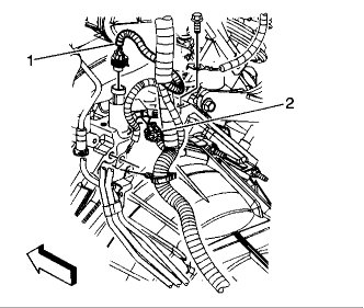

I have to be honest, it is easy to move or disconnect either of those two sensors. I am going to give you the directions for removal and replacement. Look over the directions and check wiring to the switch to see if something was damaged, disconnected, loose.
Here is the oil pressure switch:

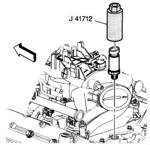

Engine Oil Pressure Sensor and/or Switch Replacement
Tools Required
J41712 0il Pressure Switch Socket
Removal Procedure
If necessary, remove the engine sight shield.
Disconnect the oil pressure sensor electrical connector (1).
Using J41712 or equivalent, remove the oil pressure sensor.

The forth picture is the location of the coolant temperature sensor. You can see how changing plugs can disturb it. Check that, too.
