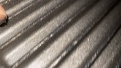

Can't really tell man. Any ideas?
Wednesday, March 20th, 2024 AT 10:25 PM
  • 109,885 POSTS
Is that the transmission pan? Wipe it down the best you can. Make sure the fuel is full and then run the truck a bit to see if you can tell where it is coming from.
