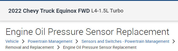

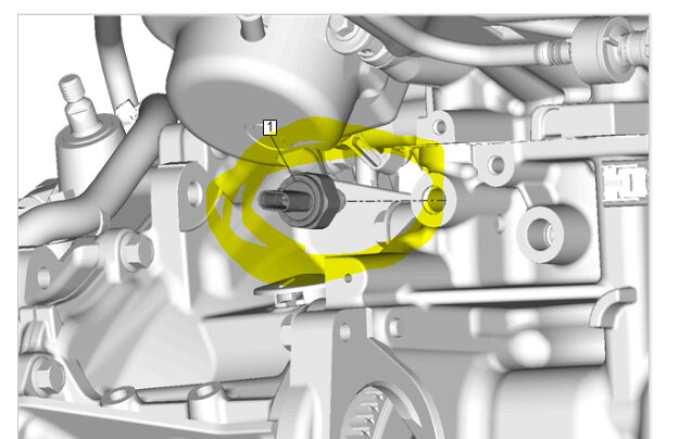

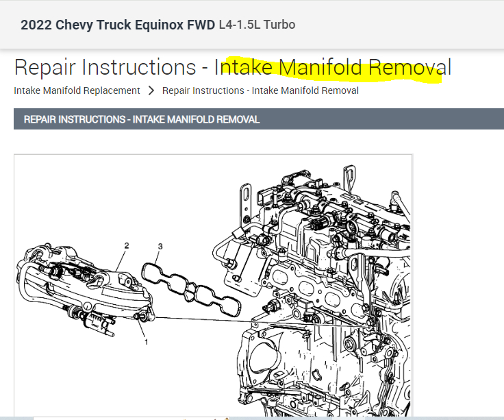

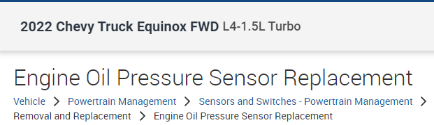

I want to find out how to find an oil pressure switch on the vehicle listed above LT model to replace it and what size socket.
Jul 26, 2024 at 4:28 AM
  • 110,240 POSTS

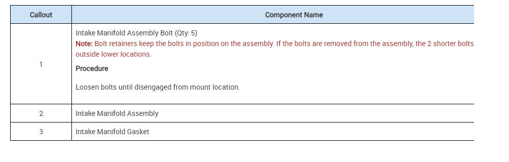

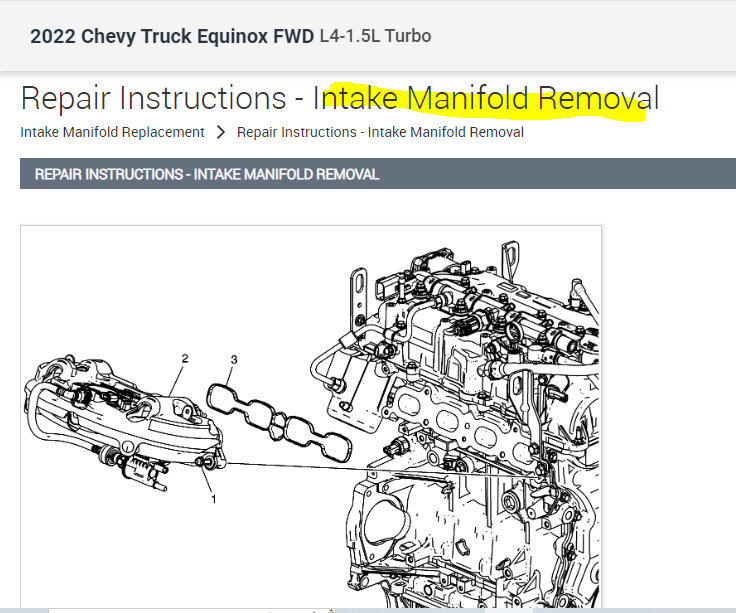

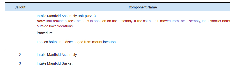

First, to replace the oil pressure sensor, the intake manifold needs to be removed so you can access the sensor. This vehicle should be under warranty 100%. Have you contacted a dealership for repairs?

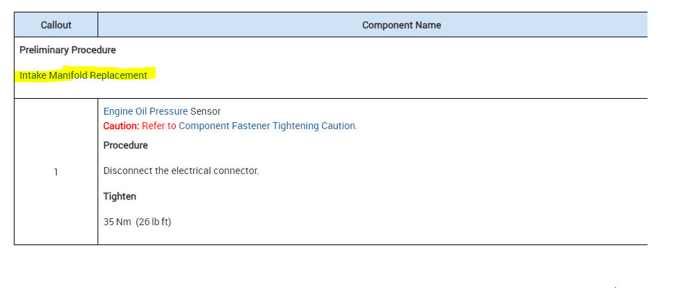

As far as the procedure, I attached the directions below. The first set of directions are the sensor replacement. Some of these require a special socket to fit the sensor. When you purchase the new sensor, ask the people at the parts store to inspect the sensor and confirm the special socket is needed. If so, many parts stores will lend you the tool free of charge.
The second part of the directions where I highlighted in yellow are the directions for the intake manifold.
