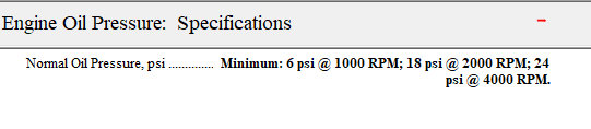

0-10 pounds oil pressure at idle, rises to about 30 when I bring rpm's up to about 3,000. No engine noises at all. any way to bring up oil pressure?

It seems oil pressure is at specified value no oil pressure problem you have. check table attached at 1,000 rpm minimum is 6 psi at 2000 rpm 18 psi at 4000 rpm 24 psi.
let us know if more help needed.
