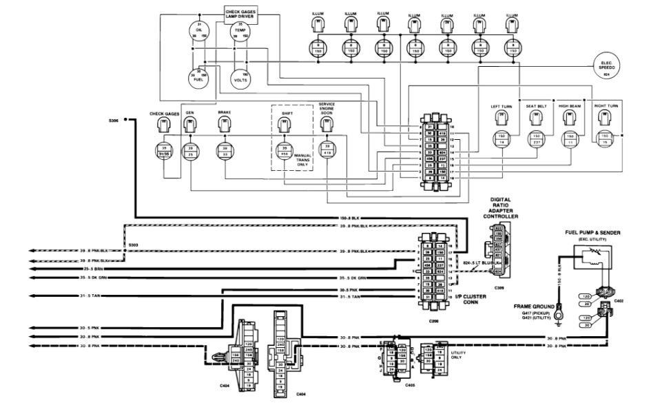

My gauges on the dash board do not work. Why?
Tuesday, May 1st, 2018 AT 2:32 AM
  • 52,797 POSTS
Good morning.
Check all your fuses with a test light or volt meter for power on both sides with the key on.
If all of them are good, the pull the cluster and check the connector at the back of the cluster. If there is no damage or burned pins then the most likely failure is the cluster itself.
