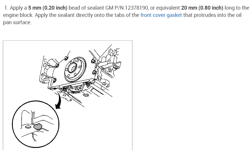

Do I have to tighten every bolt to a specific ft pound? Which bolts should I start with? Do I have to use the silicone if I have a brand new gasket?

Do the oil cooler lines not attach in the same area? Both the 5.3 and 6.0 engine motor oil pans are the same.Only difference would be a 2wd or 4x4 difference. Before you add any type of RTV to a gasket I would need to know what type of gasket and brand you plan on using. I would be glad to send the replacement steps to you if needed including torque specifications for the bolts.Hope this helps and thanks again for using 2CarPros.

Oh yeah, and I will be using a Felpro gasket with black silicone gasket sealer.

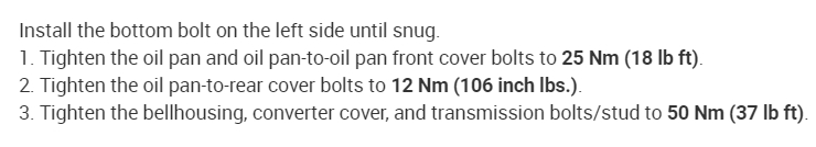

I'm actually working on it right now. is there anyway you could please tell me how many foot pounds do I torque the oil pan bolts down to?

Yeah, it cracked again! I didn't even have any bolts tightened. I don't get it!

That is crazy! Can you use your cell phone to take pictures of the damage and upload here? I've also attached pictures below of the use of silicone and oil pan torque specifications below.Sorry to hear of your bad luck.Let me know if you have any further questions or info needed about your oil pan replacement.Thanks again for using 2CarPros.
