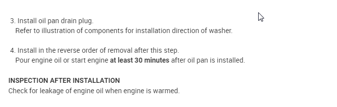

I have all the bolts out and my oil pan is down, but I cannot get the oil pan out of my car.

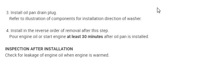

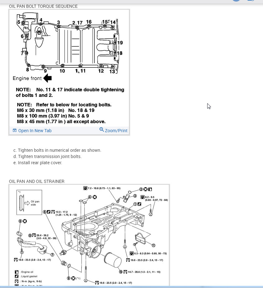

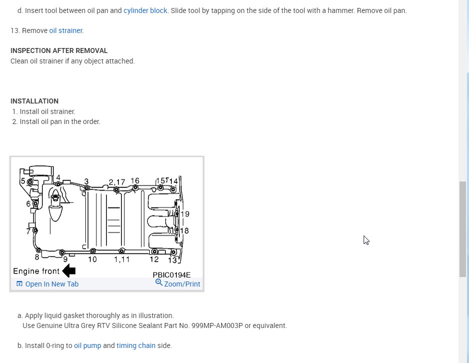

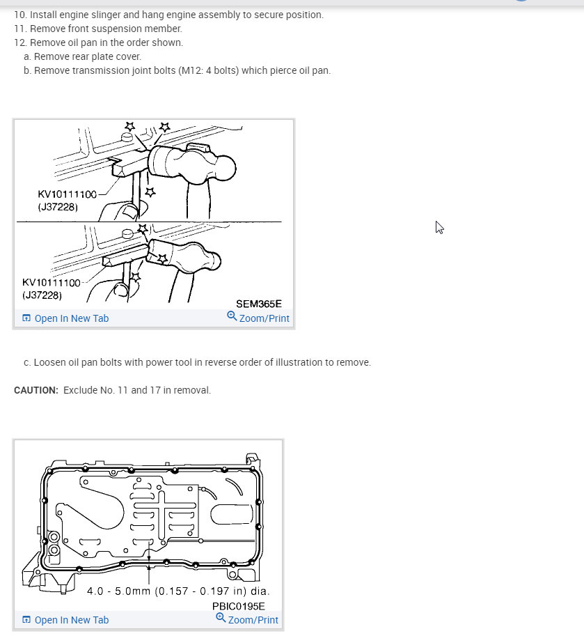

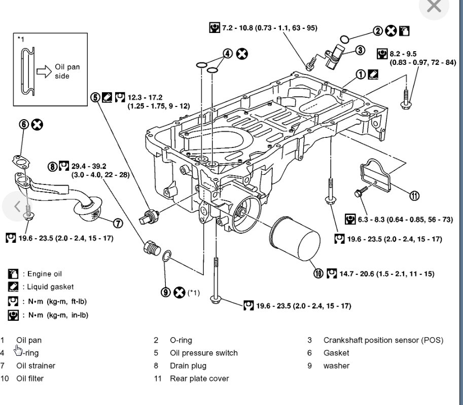

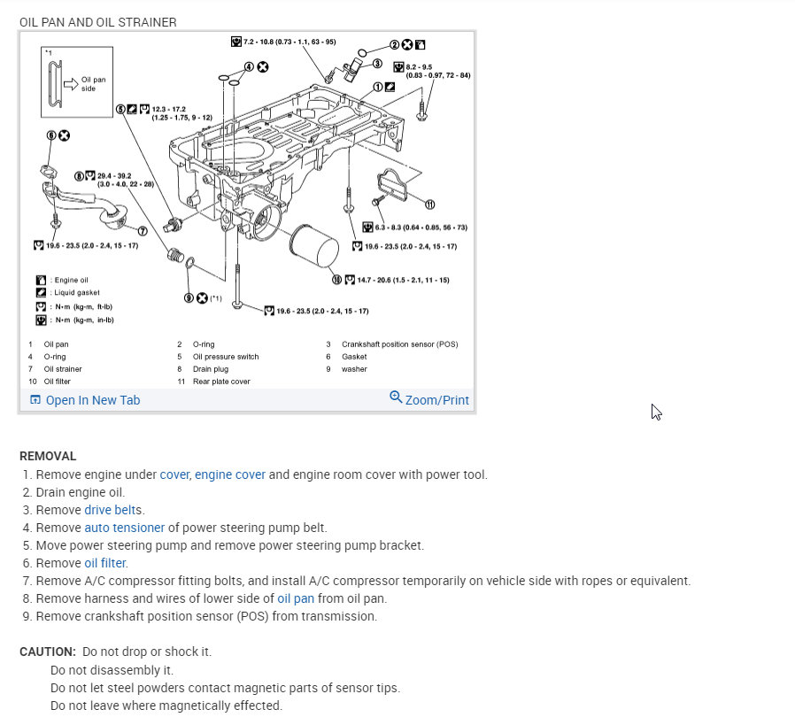

I attached the procedure but you have to support the engine and remove the suspension components in order to get it out.
Let me know if you have questions after you go through this material. Thanks
