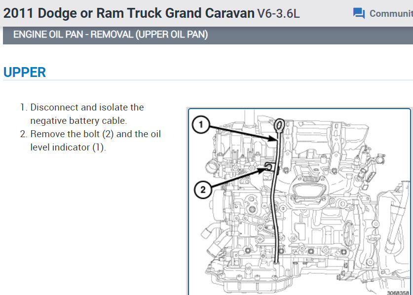

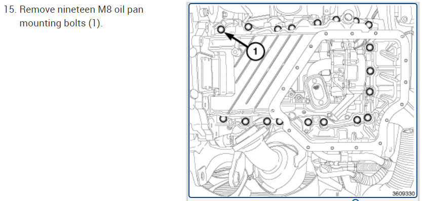

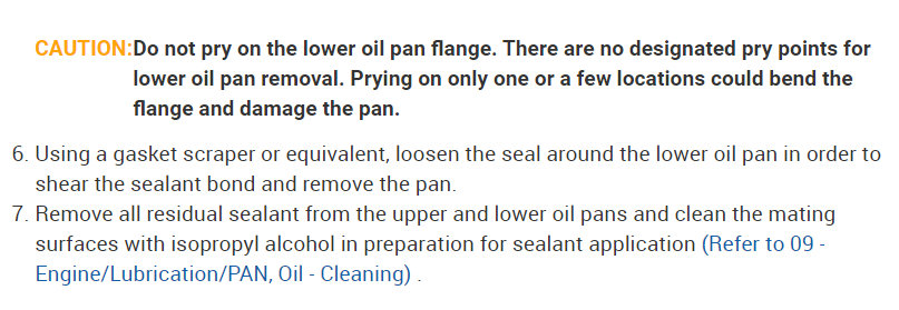

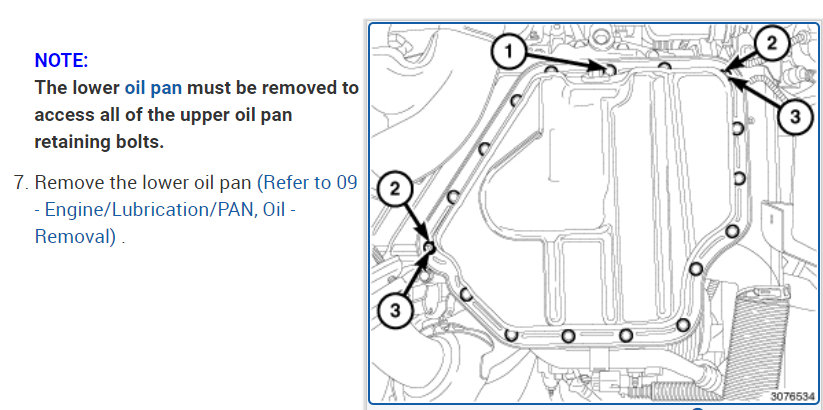

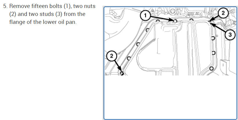

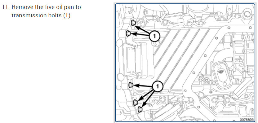

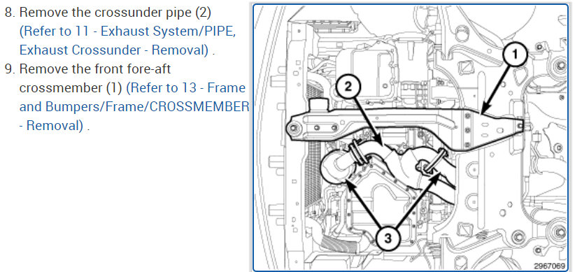

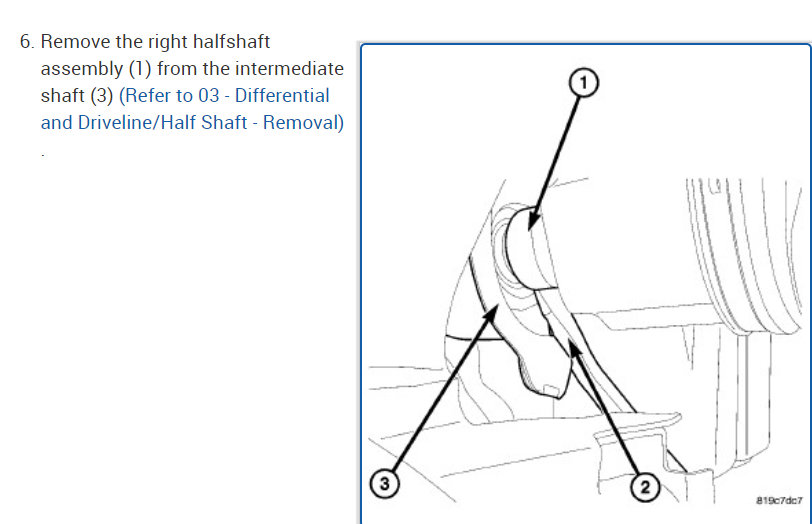

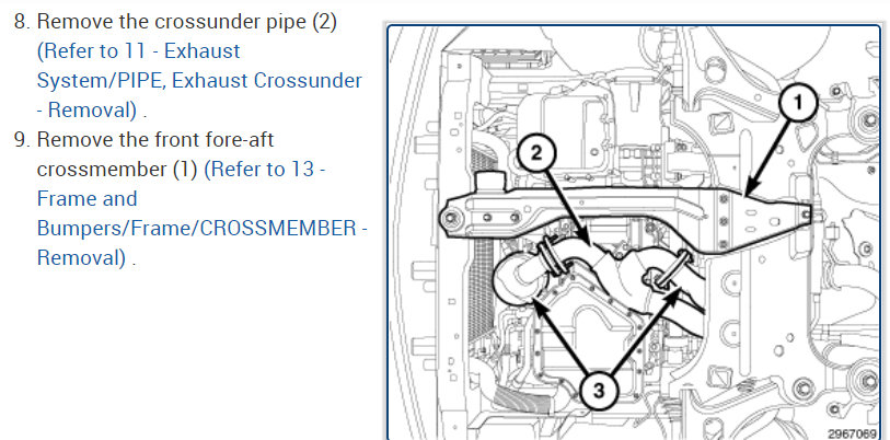

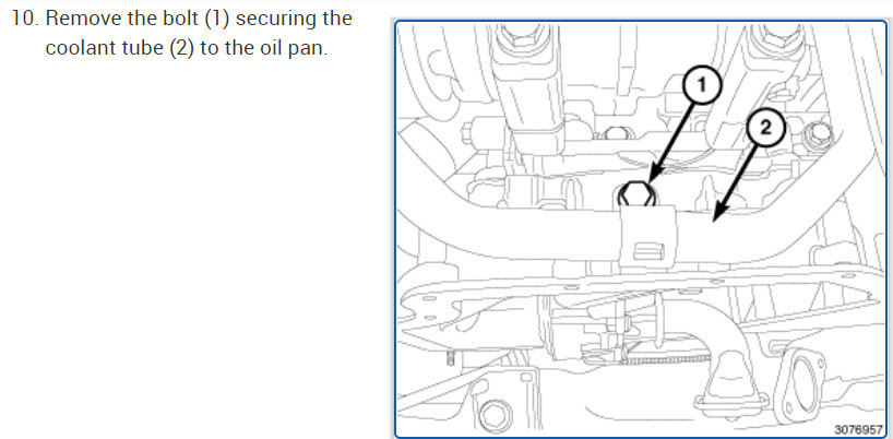

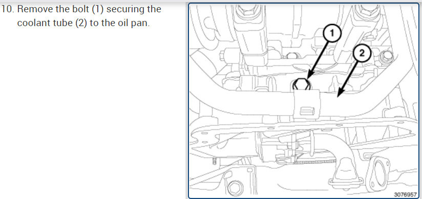

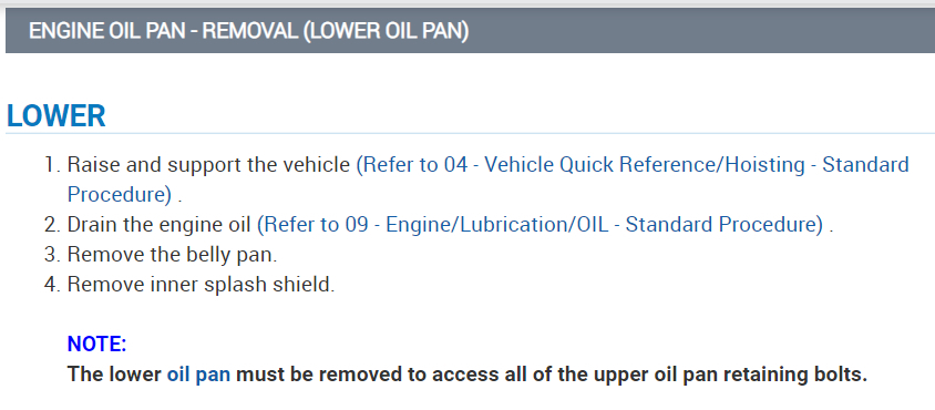

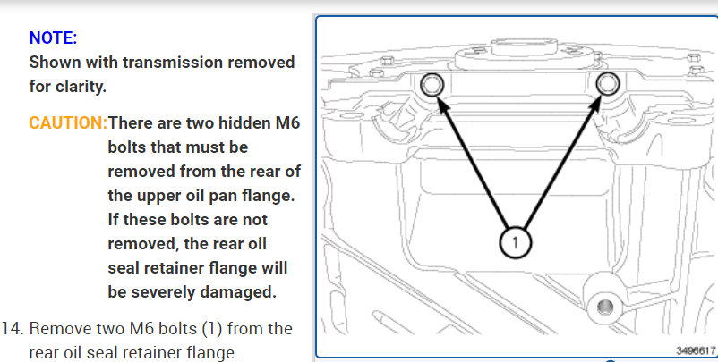

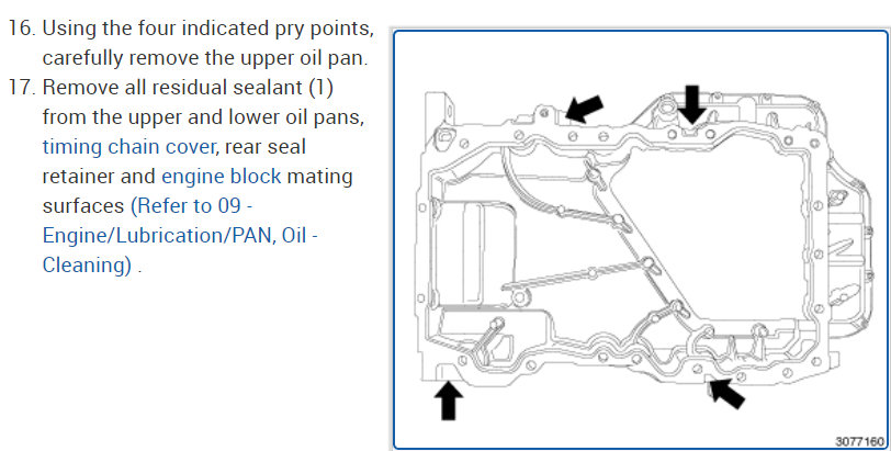

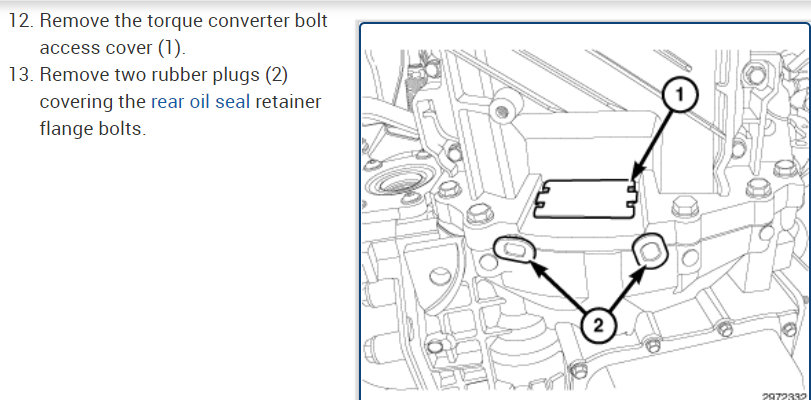

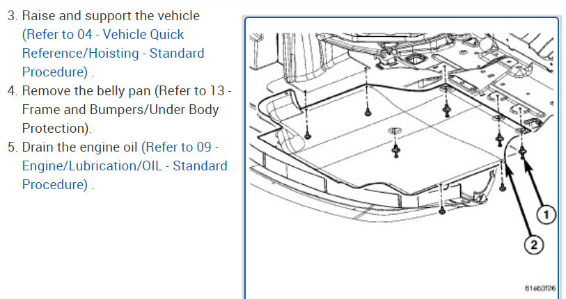

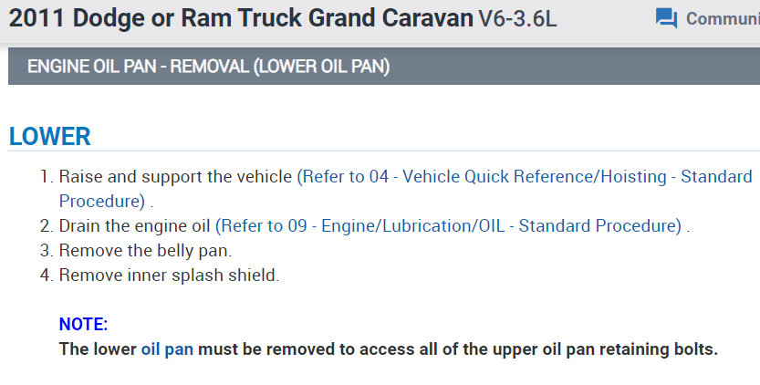

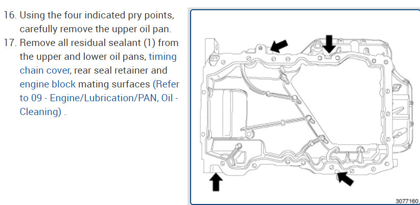

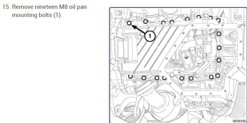

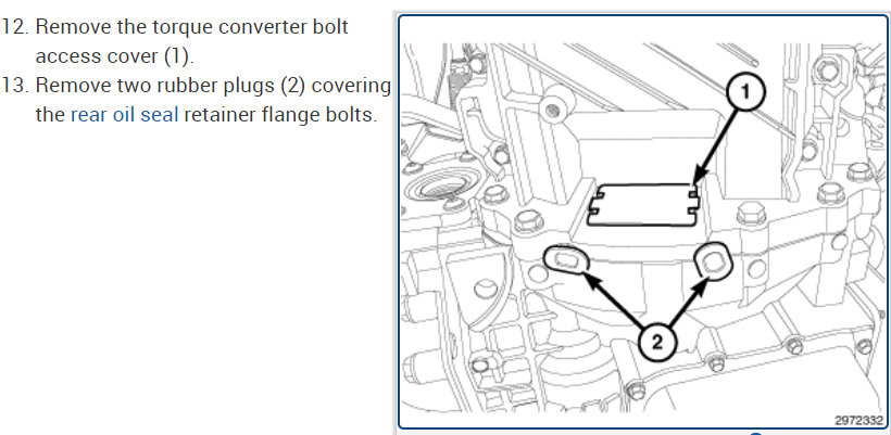

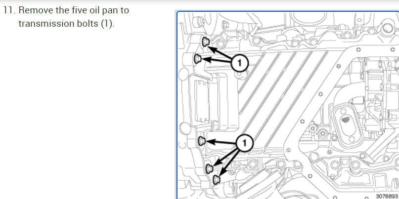

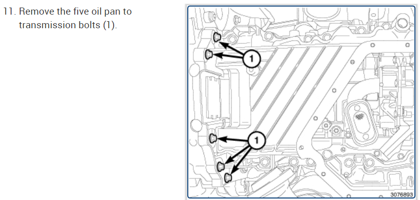

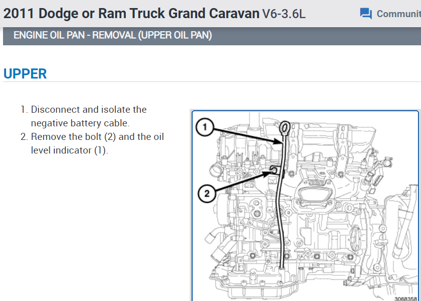

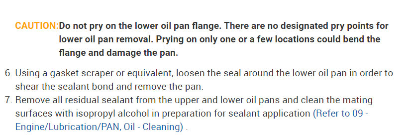

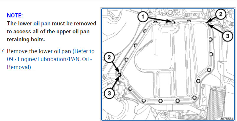

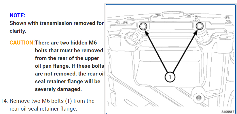

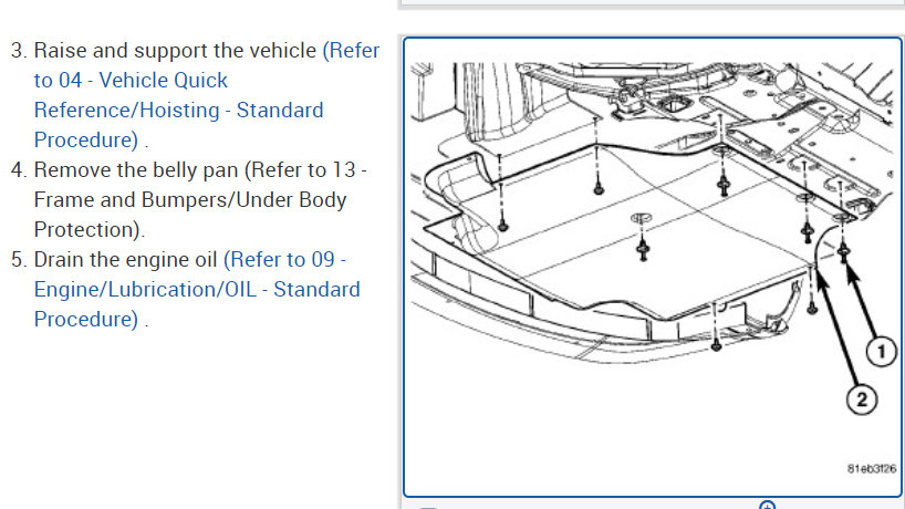

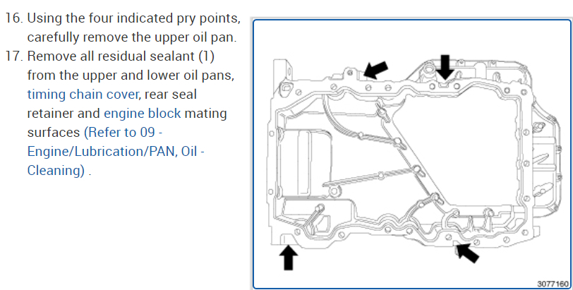

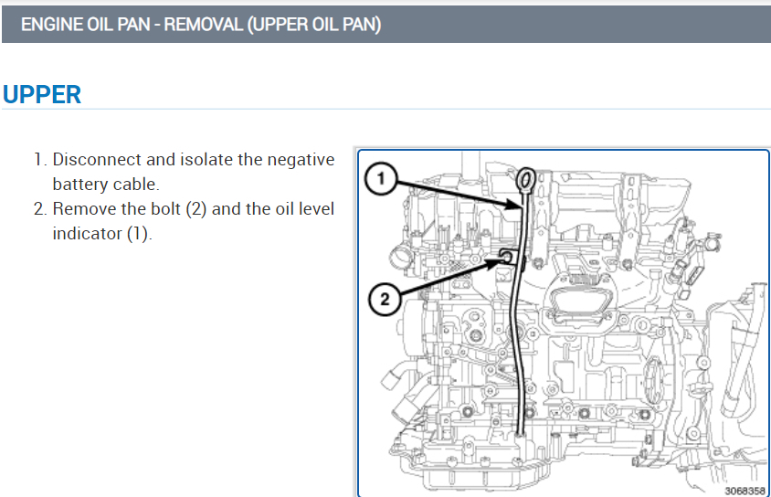

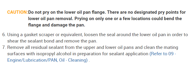

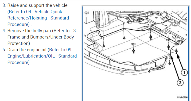

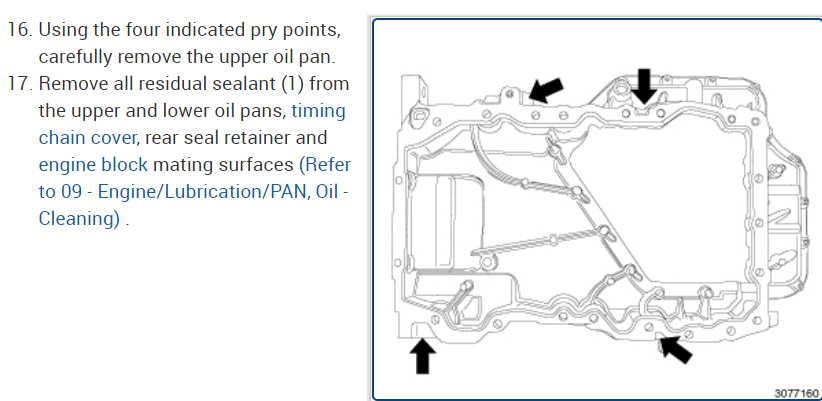

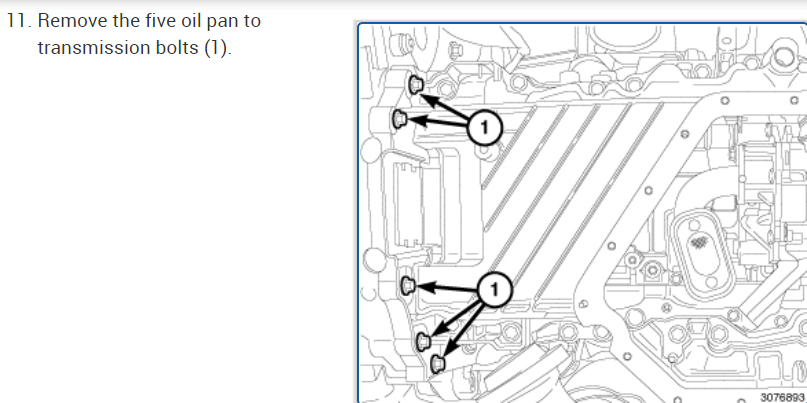

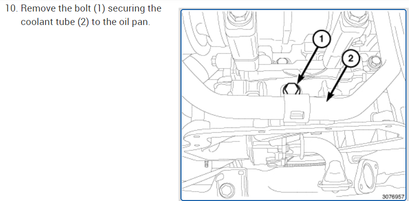

Need help removing oil pan. Took all bolts off and air conditioning line holding bolt. Still won't come off.
May 1, 2016 at 3:39 AM
DANNY L
  • 5,648 POSTS
Hello, I'm Danny.

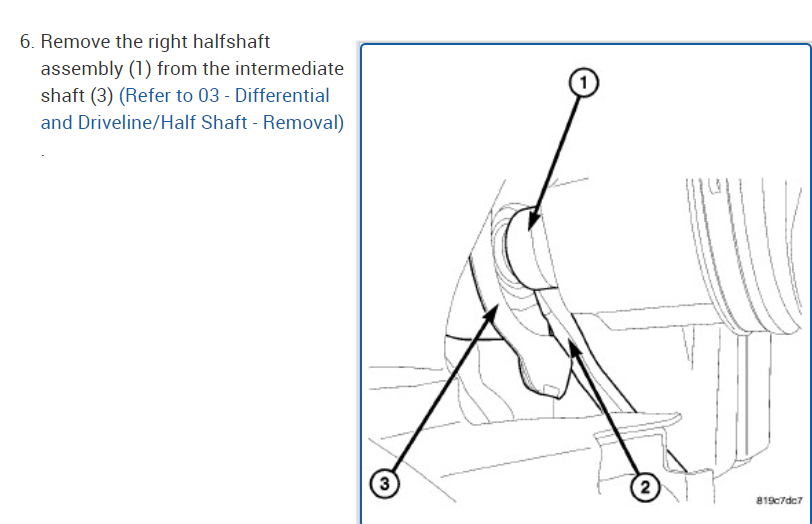

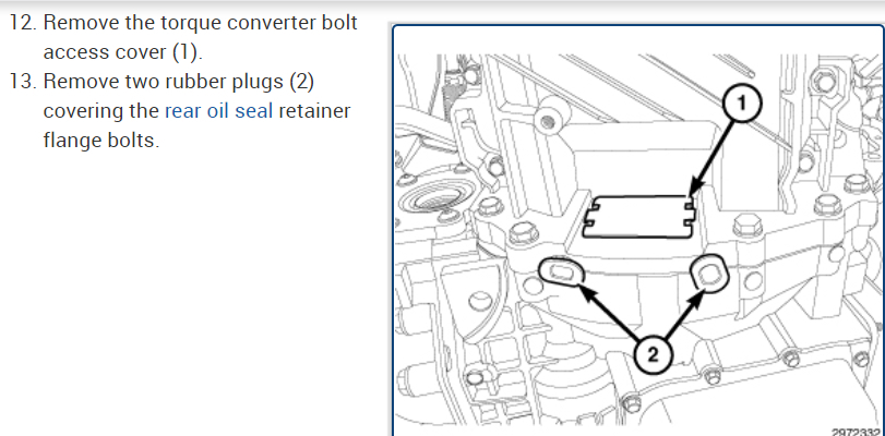

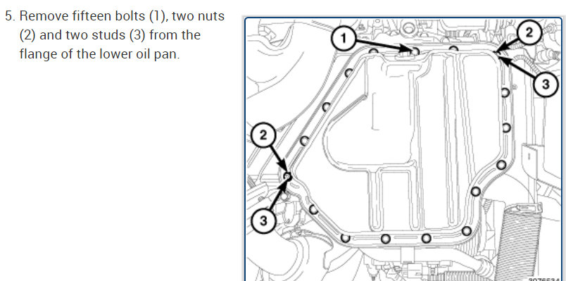

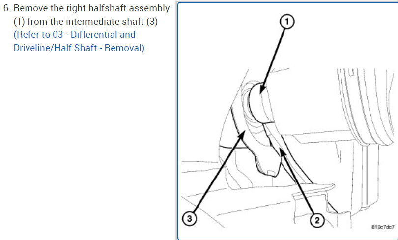

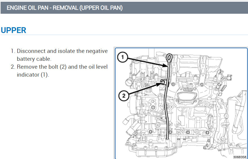

Here is what I found in our repair guides for you. I've attached picture steps below on how to remove and replace both the upper and lower oil pans for your van. Hope this helps and thanks for using 2CarPros.
