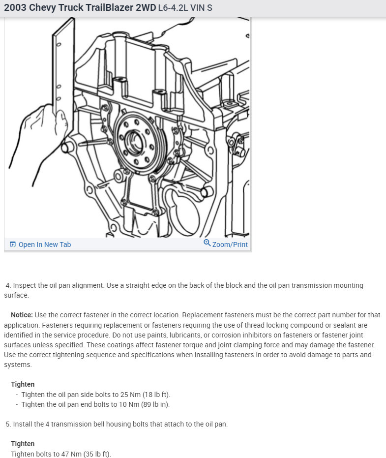

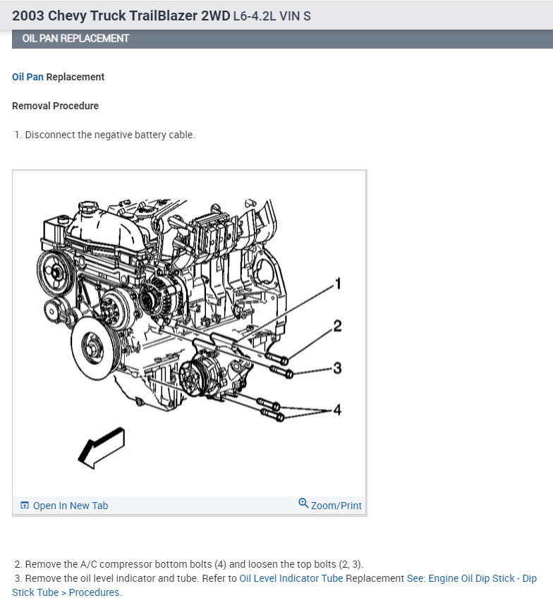

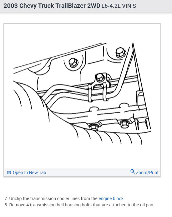

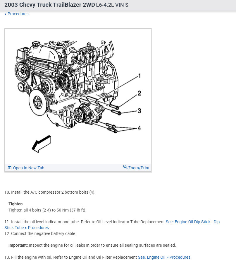

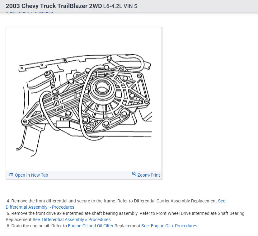

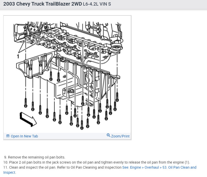

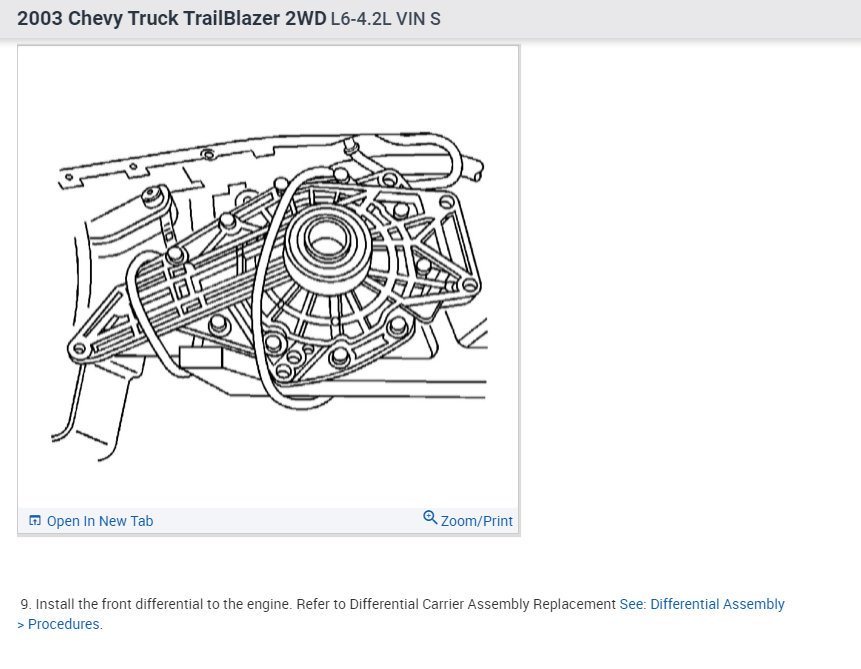

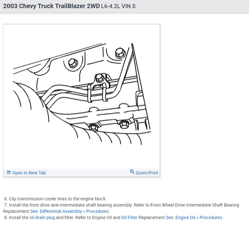

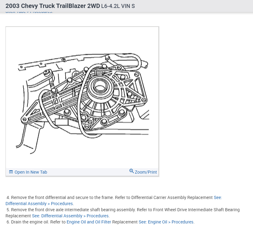

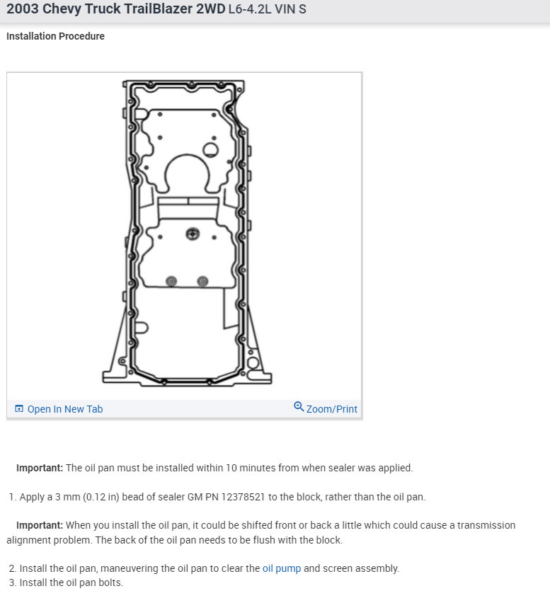

How do I remove the oil pan from this vehicle?
Feb 27, 2022 at 12:57 PM
SQM
  • 6,383 POSTS
On this vehicle in order to remove the oil pan you will first have to remove the A/C compressor. As well as the oil dip stick tube.
I have attached the replacement procedure below including the torque specifications.
