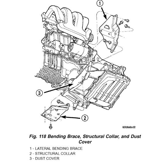

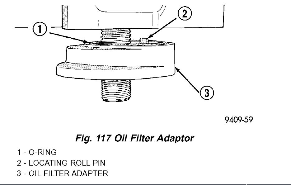

Good morning, my oil pan is leaking oil from the gasket. How do I remove the oil pan?

3. Drain engine oil and remove oil filter.
ImageOpen In New TabZoom/Print
4. Remove oil filter adaptor from engine block (Fig. 117).
5. Remove structural collar.
6. Remove lateral bending brace attaching bolts (Fig. 118).
7. Remove lateral bending brace (Fig. 118).
8. Remove transaxle dust cover (Fig. 118).
9. Remove oil pan bolts.
10. Remove oil pan.
