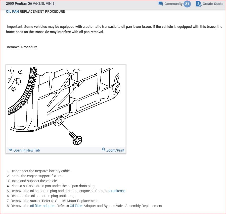

Hello, I'm looking for some information on removal of an oil pan.

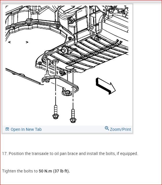

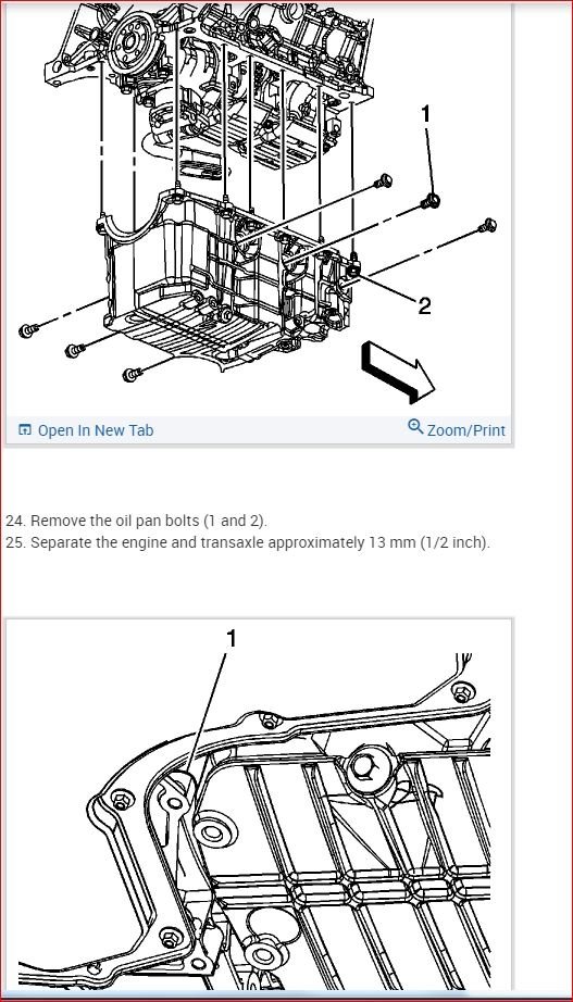

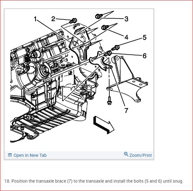

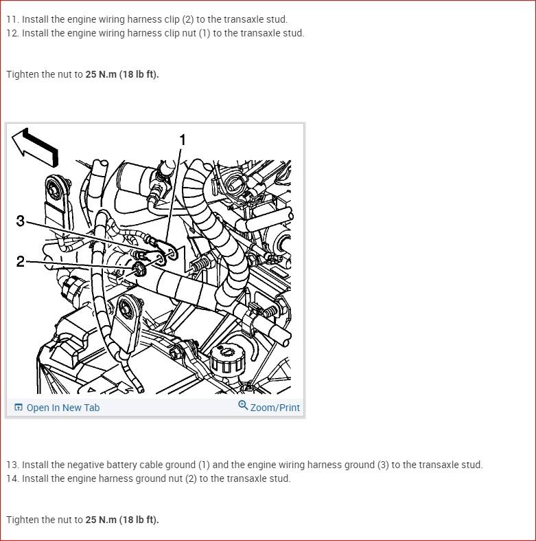

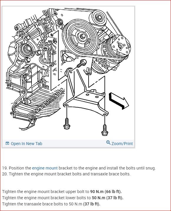

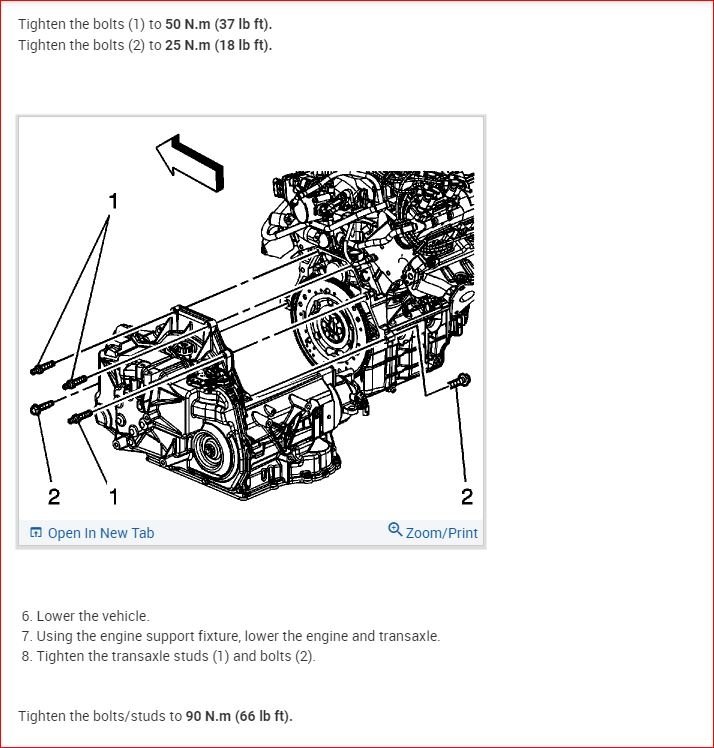

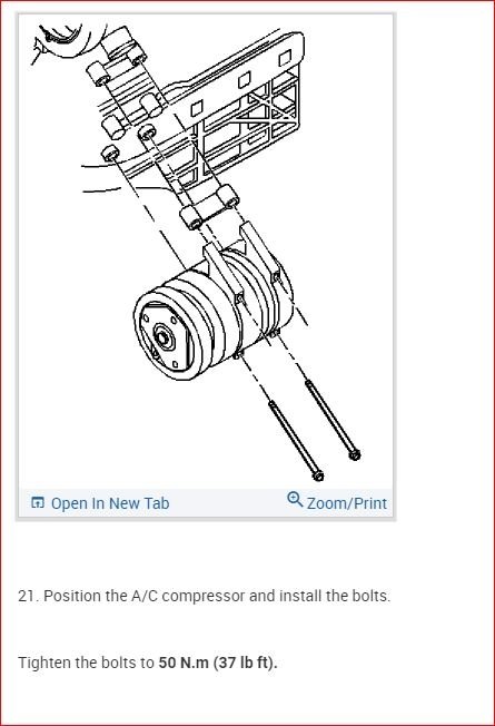

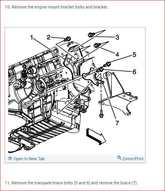

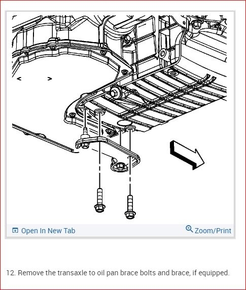

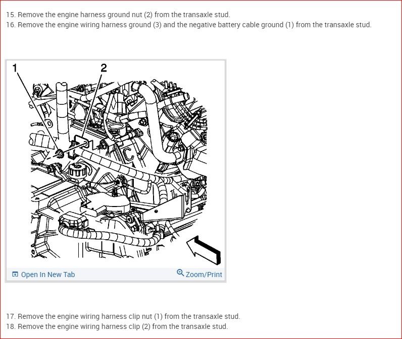

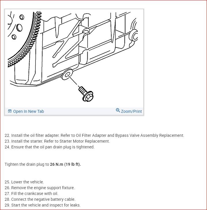

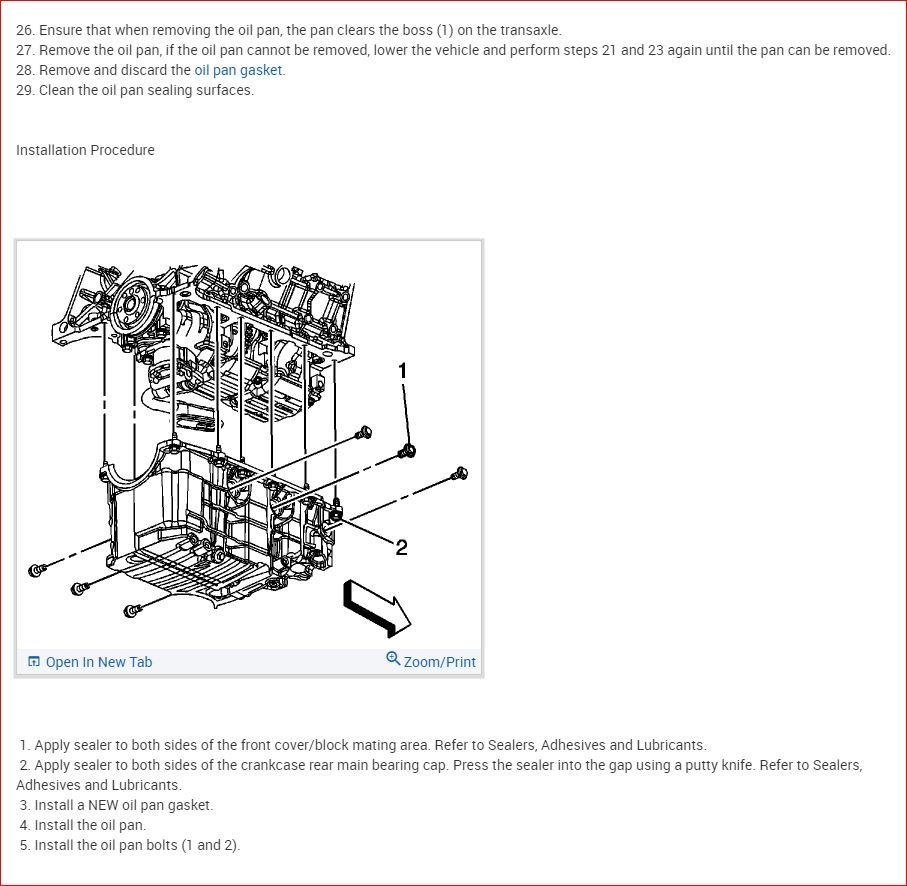

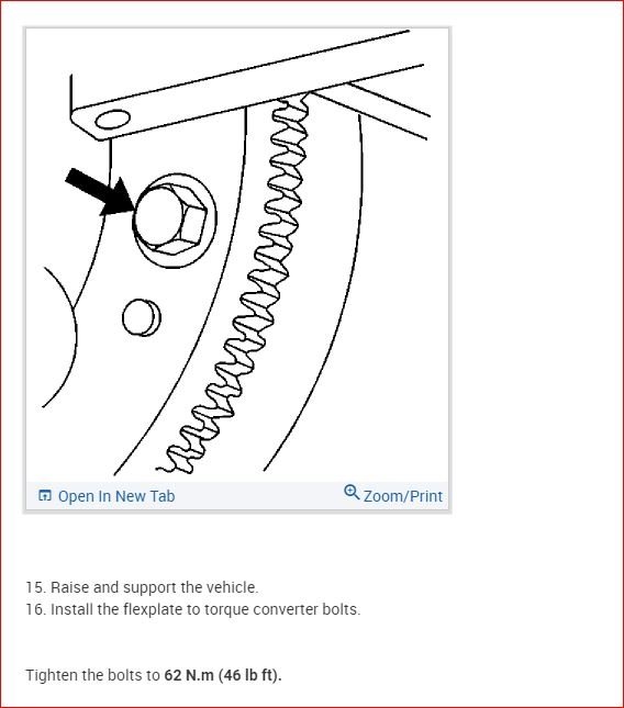

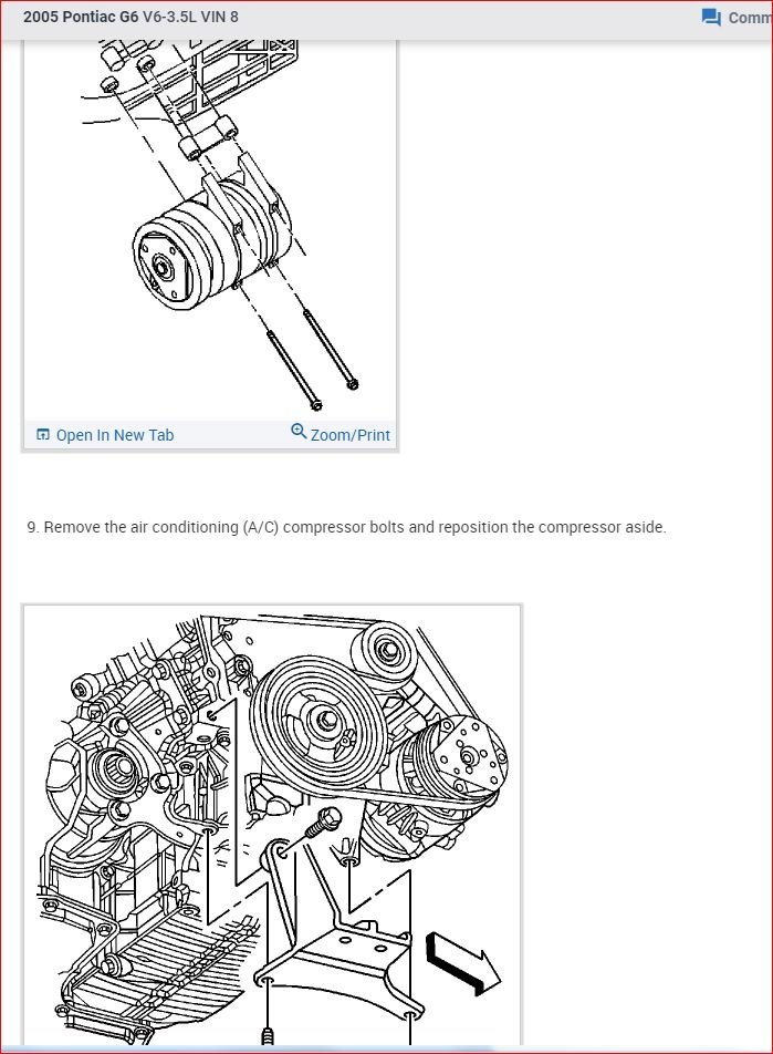

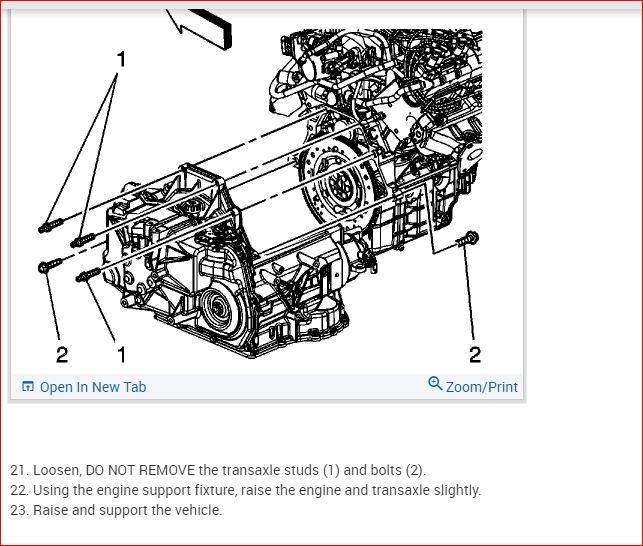

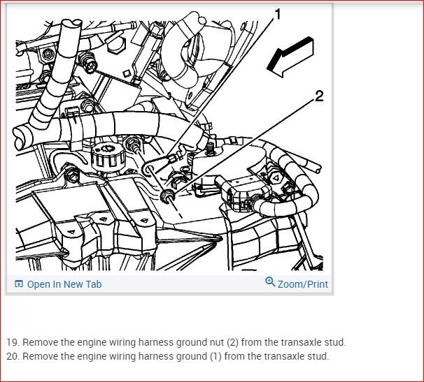

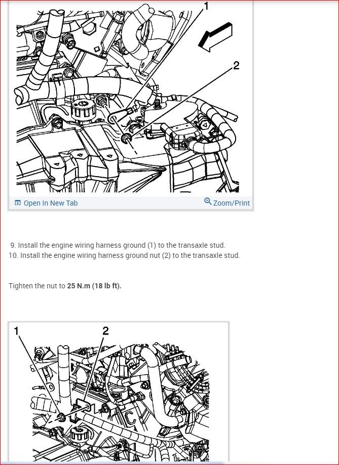

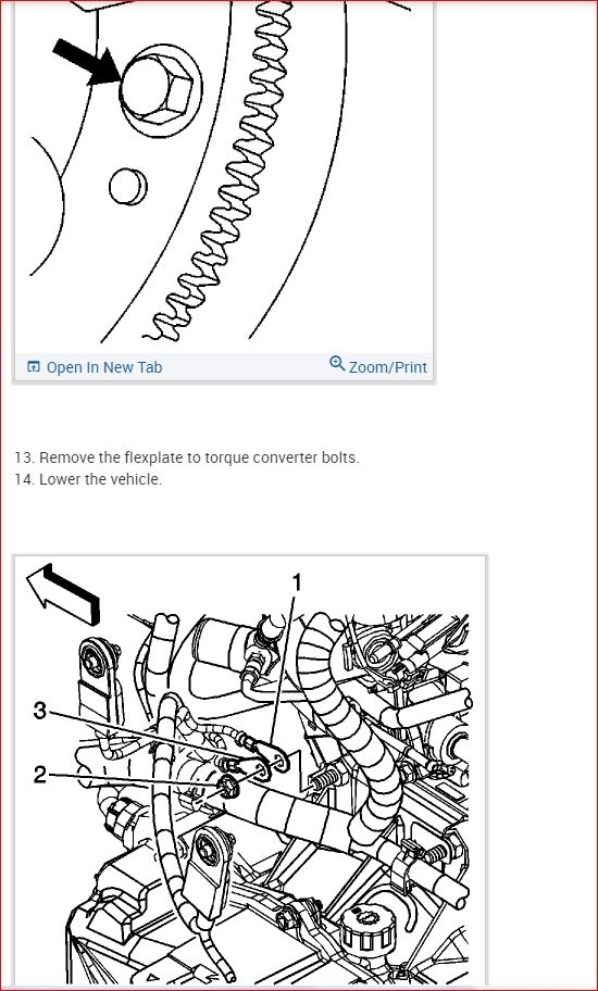

Hi Alex,
Here is the procedure from the manual on how to remove the engine oil pan. Please let me know if you need anything else. Check out the diagrams (Below). Please let us know what happens. Thanks
