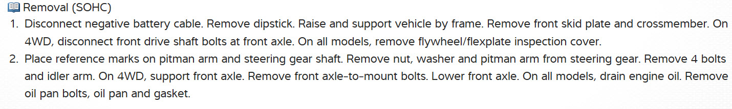

Any chance I can get Step by step instructions for removing oil pan for my car?
Need to clean sludge from screen

if this is a dual overhead cam we have no instructions for it and are not provided. see pic for instructions but your problem may not be helped by cleaning
