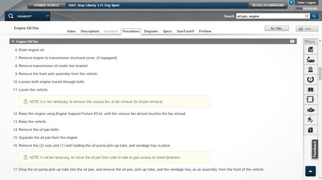

Hi, Does anyone have a trick to removing the oil pan? this thing is all wheel drive for 1, 2 the oil pick up is in the pan, is bolted to the pan, and i can only get it to drop to drop 1/2 inch. Looks like a motor pull? thanks

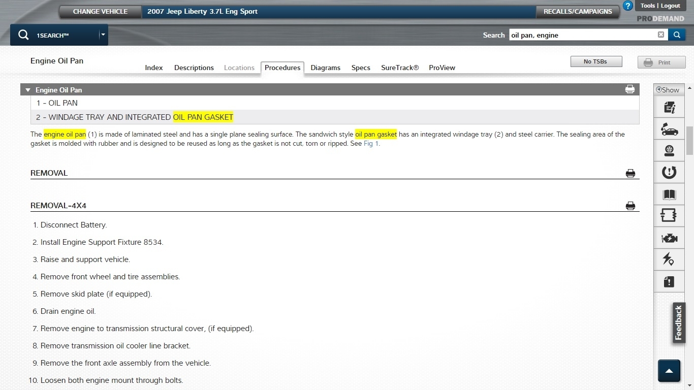

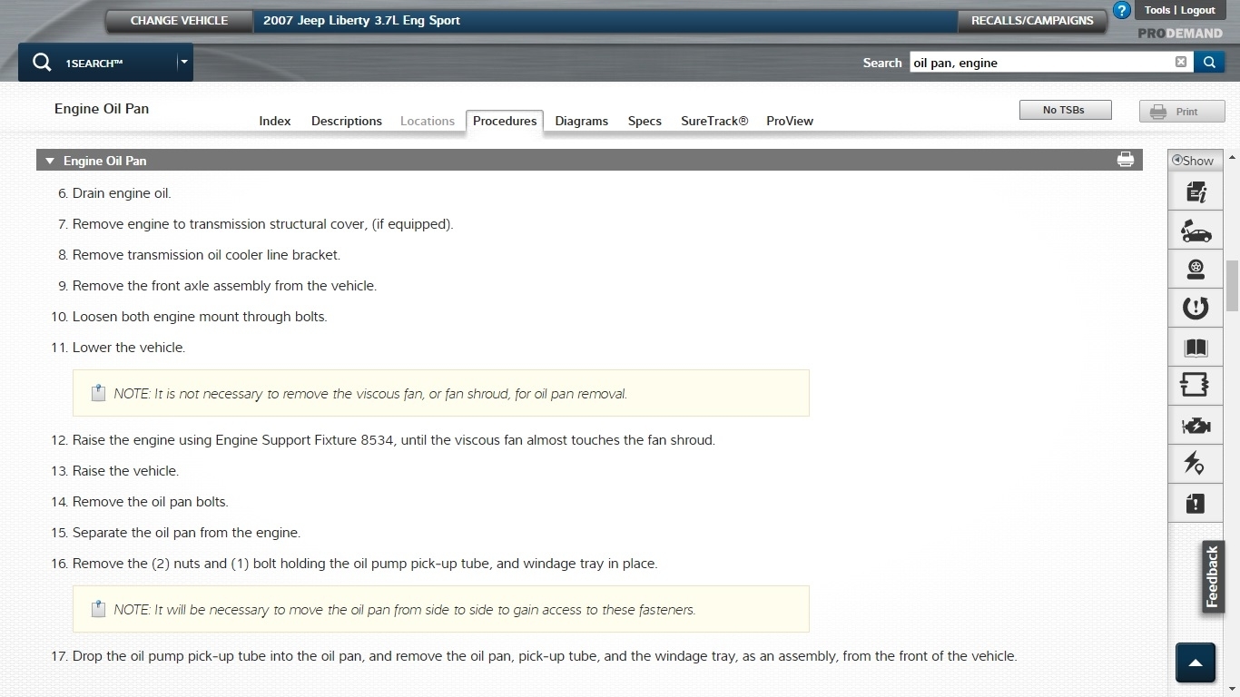

THIS IS WHAT "PRODEMAND" SAYS
I HAD TO MAKE SCREENSHOTS TO GET THIS
2WD AND 4WD (WHAT I USED) WERE MY ONLY OPTIONS, THERE WAS NO AWD
LET US KNOW IF THIS HELPS
THE MEDIC

AL514
  • 5,659 POSTS
THANKS CJ, LOOKS LIKE I'M GOING TO RAISE THE ENGINE. TAKING THE FRONT AXLE ASSEMBLY OFF WILL TAKE LONGER.
