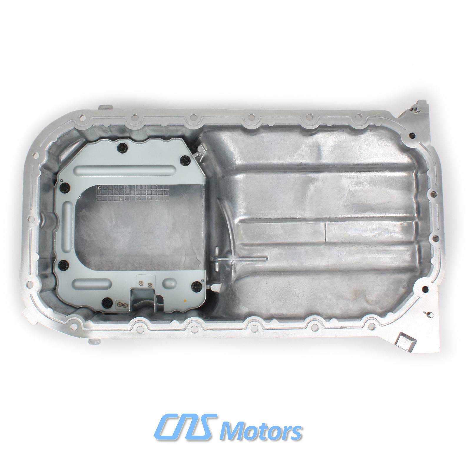

my car kia spectra , i will remove the oil pan to check pistons
so i need diagram for 19 bolt tighten sequence when installed and removed oil pan

about your question, i will check the pistons to change the old rings, so i need diagram for 19 bolt tighten sequence when installed and removed oil pan see the image.

Tightening sequences are always the same. You start in the middle and alternate sides while working toward the ends. I would do it in 2 sequences bringing them all snug first before final tightening.

thanks for your answering but there is 19 bolt if you have diagram for oil pan bolt sequence , this make it more clarify and so easy for me to do it with my self

No, I don't have a diagram. The manufacturer didn't see a need to publish one.
