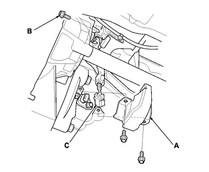

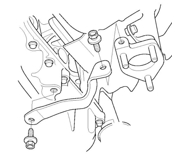

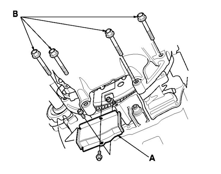

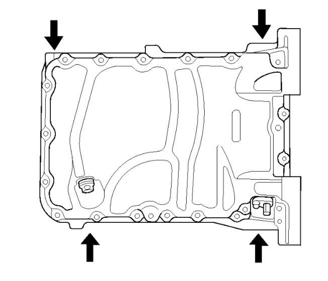

Looking to replace my oil pan on my car listed above EX-L (V6 w/vcm), but as i understand it, Honda didnt use a gasket, but a Honda-specific silicone sealant only..
Is there a compatible RTV product or something i can use for that?
Appreciate you!
-BH
Jan 11, 2021 at 1:41 AM
Good morning,
Yes, it is called Honda Bond. The parts counter carries this sealer.

6. Remove the rear warm up three way catalytic converter (rear WU-TWC) bracket.
7. Remove the crankshaft position (CKP) sensor cover (A) and the bolt (B), then disconnect the CKP sensor connector (C).
8. Remove the clutch/torque converter cover (A) and the four bolts (B) securing the transmission.
9. Remove the bolts securing the oil pan.
10. Using a flat blade screwdriver, separate the oil pan from the engine block in the places shown.
11. Remove the oil pan.
