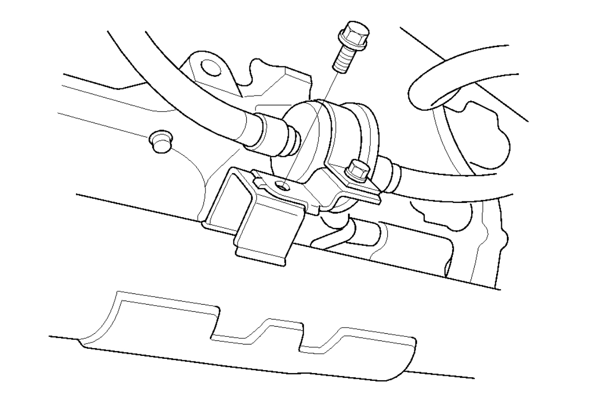

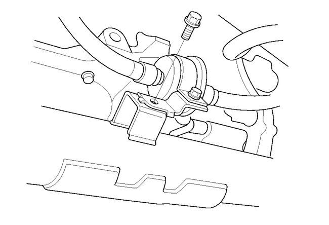

11. Remove a bolt securing the P/S fluid line bracket, and unclamp the P/S fluid line clamps on the front subframe. See: Engine > Removal and Replacement > Engine Removal

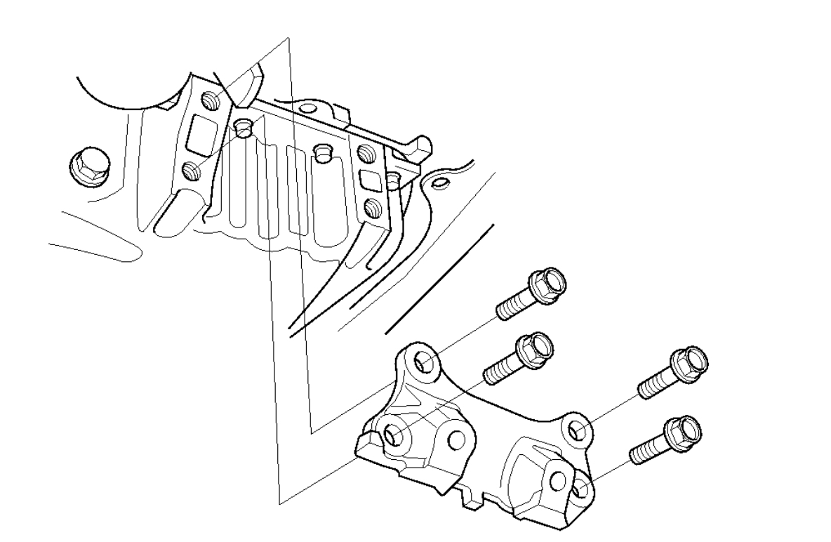

21. Remove the lower torque rod bracket.

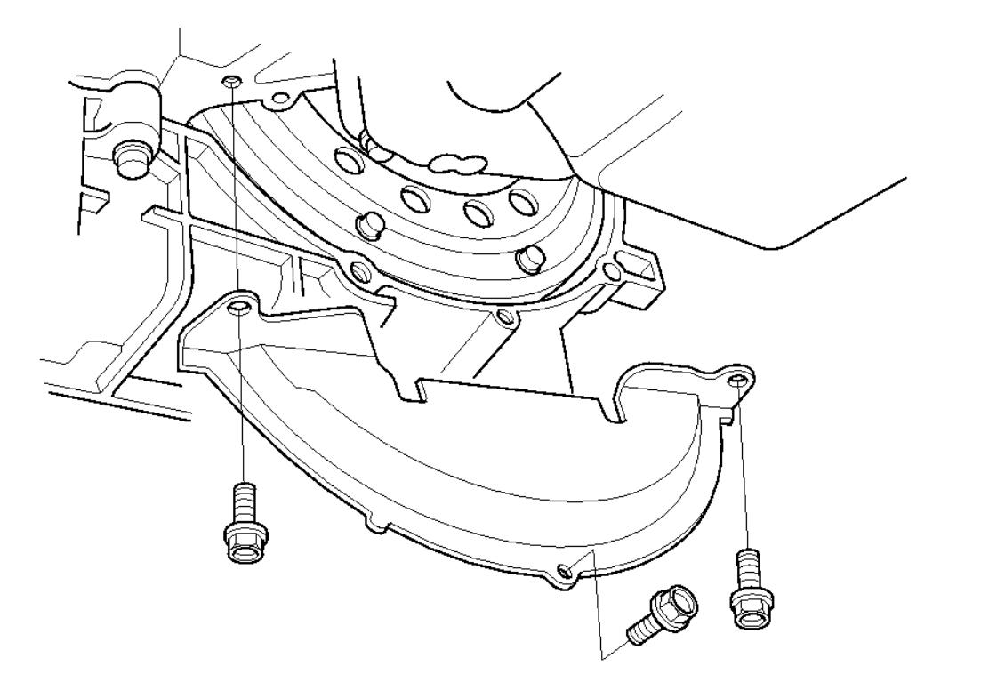

22. Remove the torque converter cover.

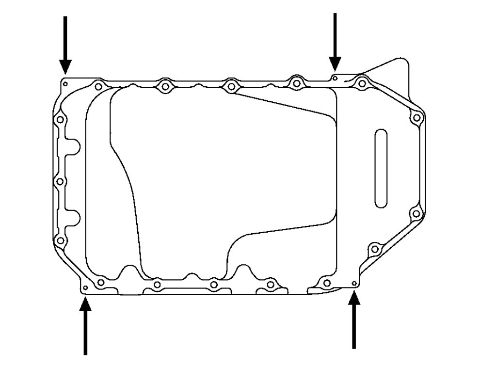

23. Remove the bolts securing the oil pan.
24. Using a flat blade screwdriver, separate the oil pan from the block in the places shown.
25. Remove the oil pan.
