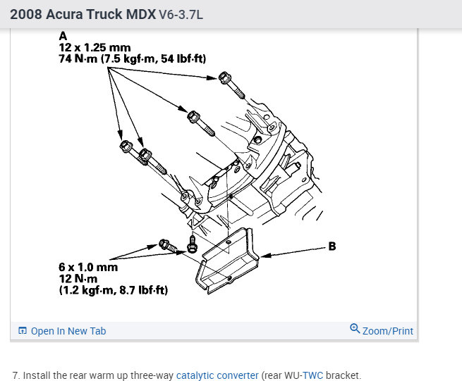

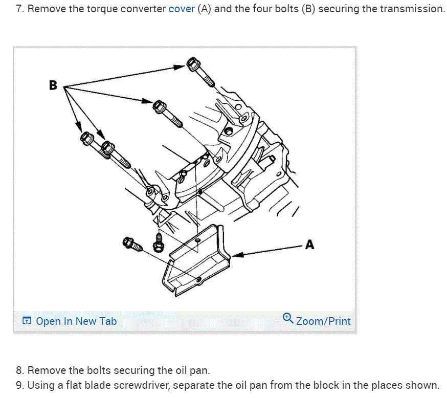

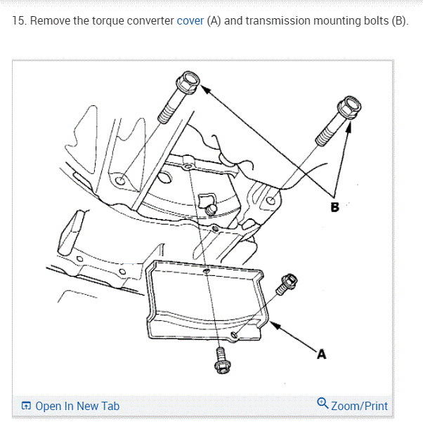

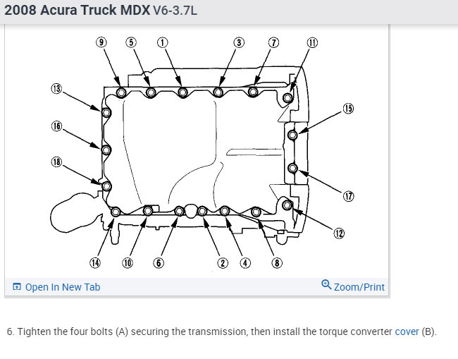

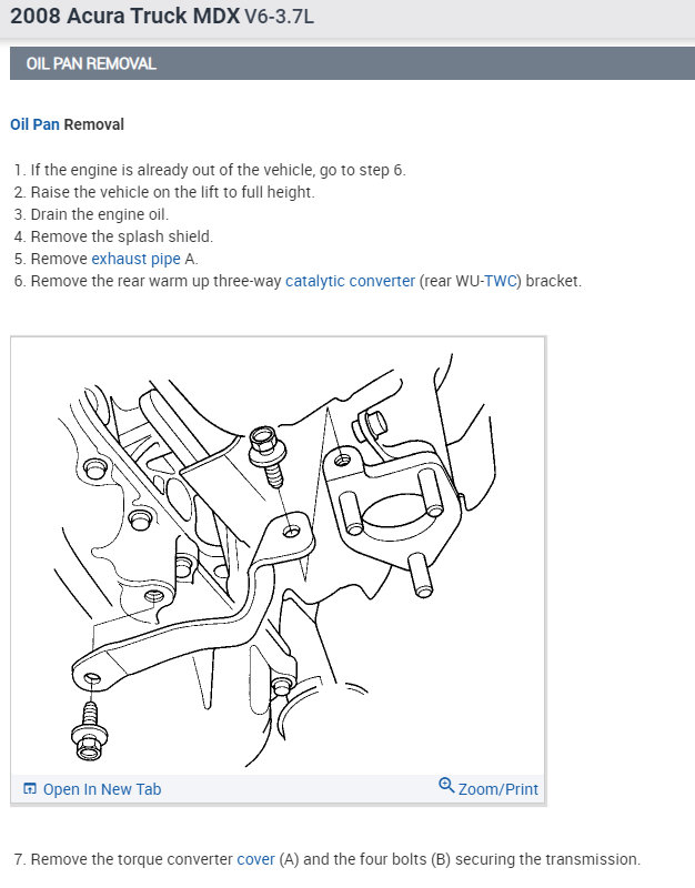

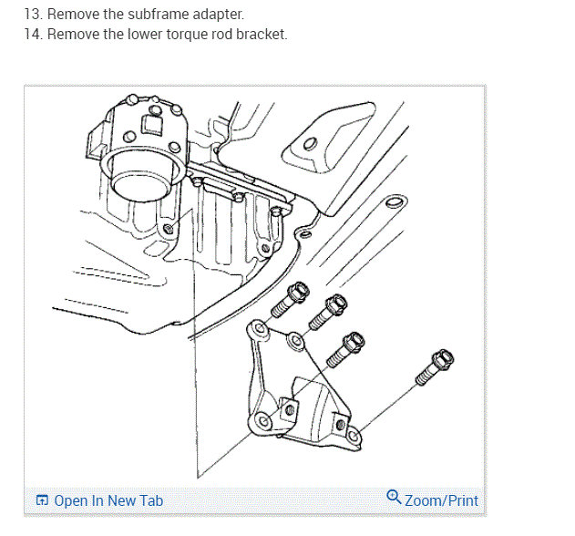

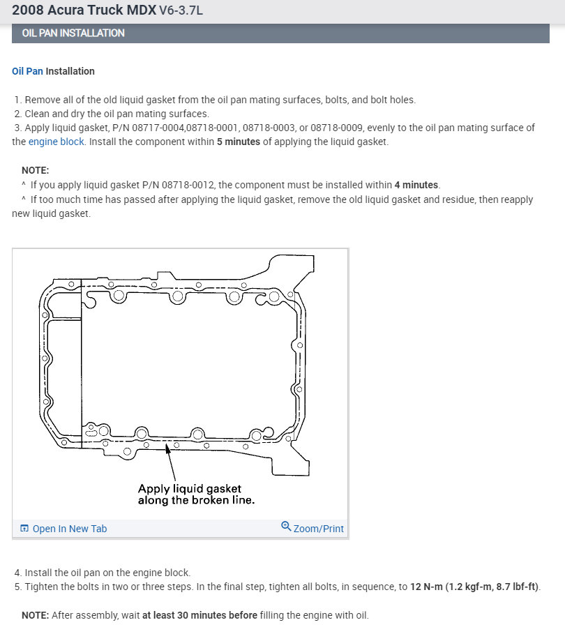

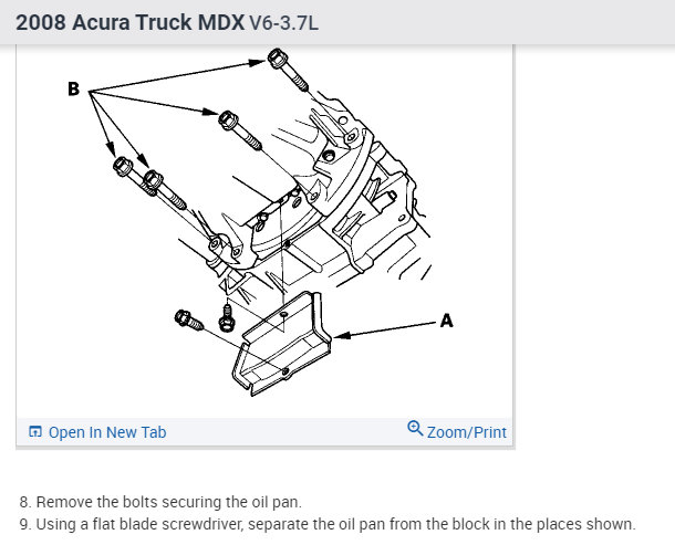

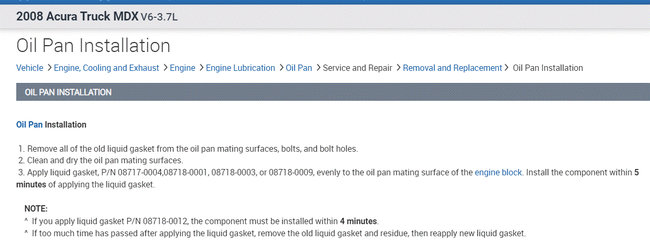

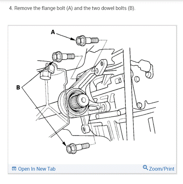

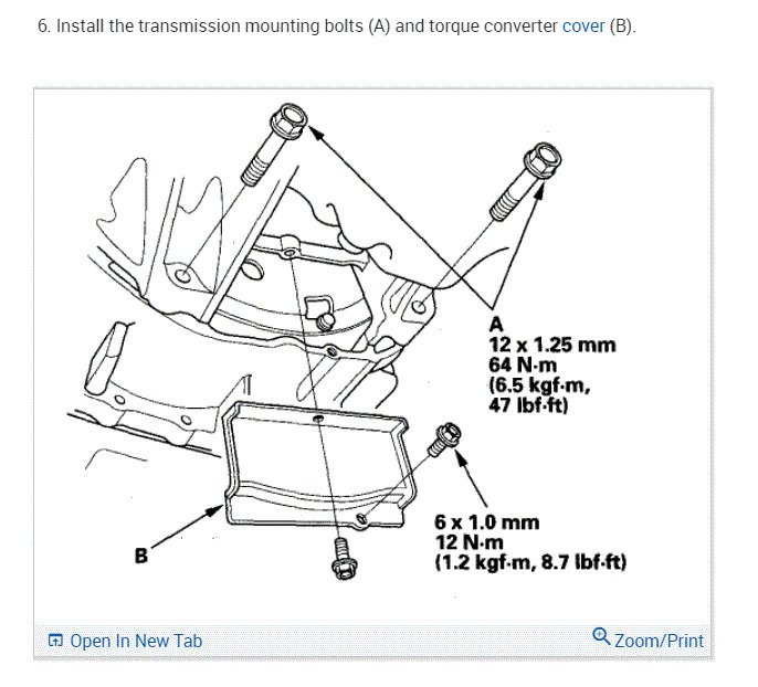

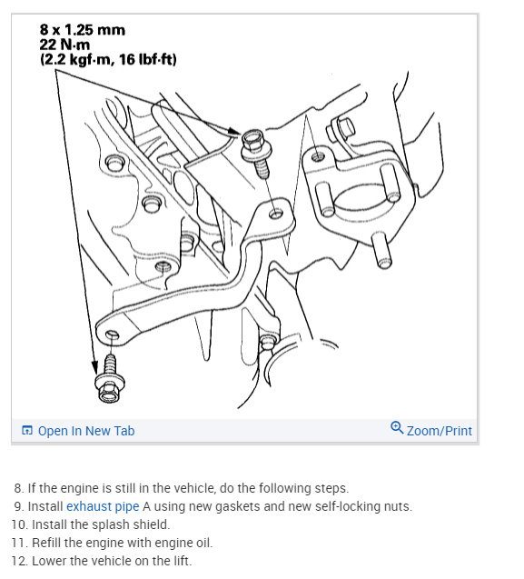

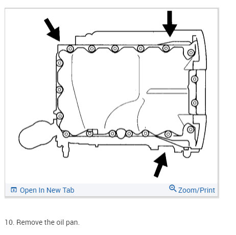

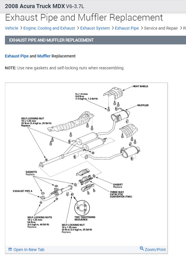

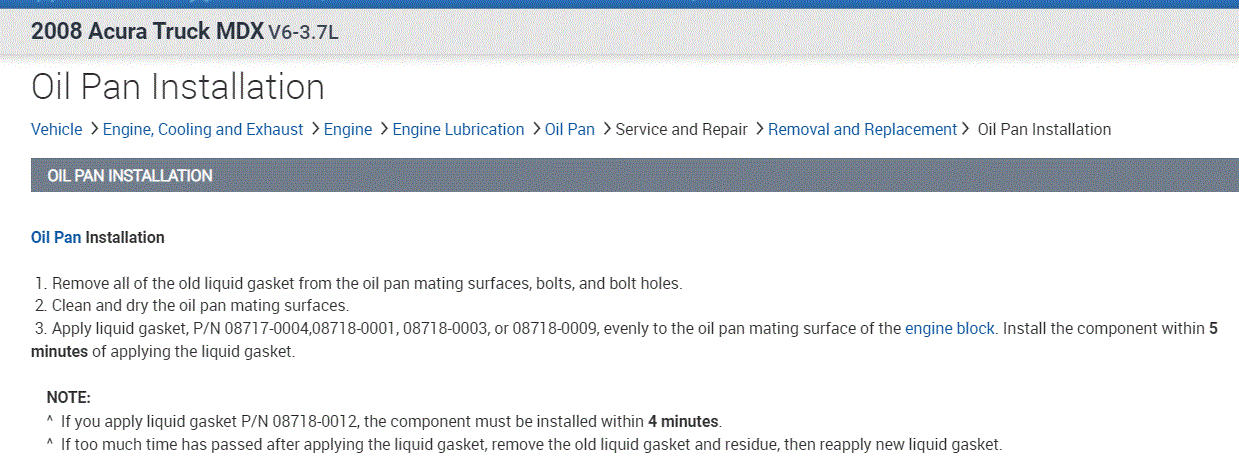

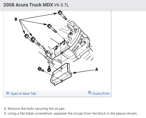

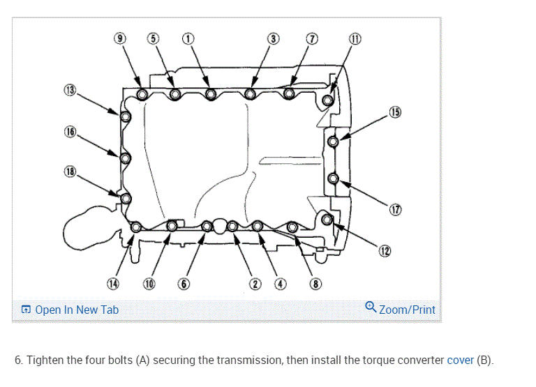

What needs to be removed before getting to the oil pan?
Feb 18, 2022 at 7:33 PM
SQM
  • 6,383 POSTS

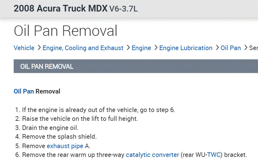

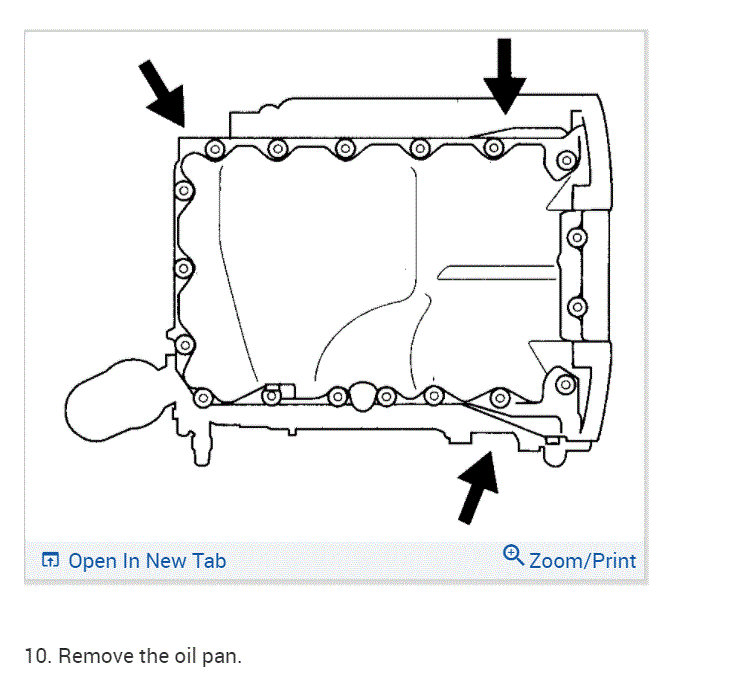

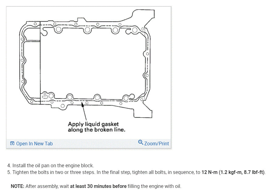

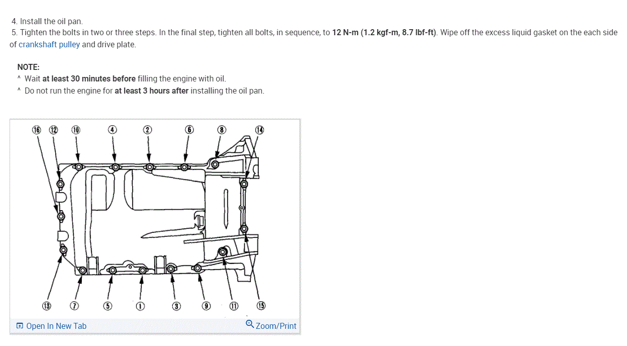

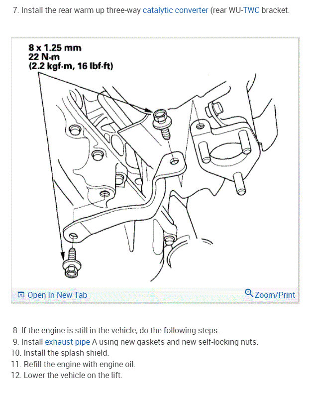

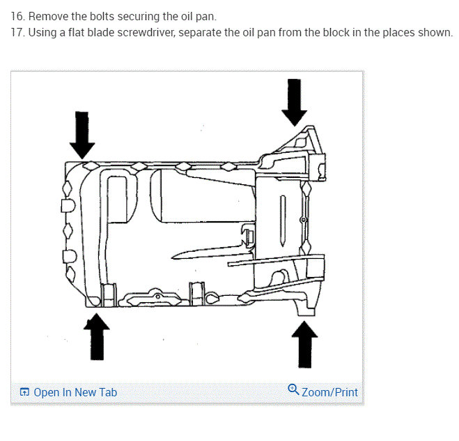

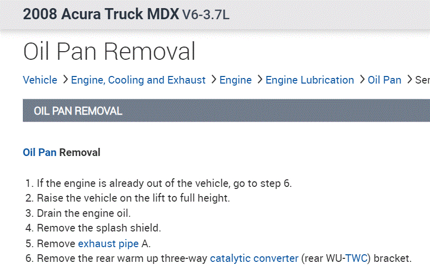

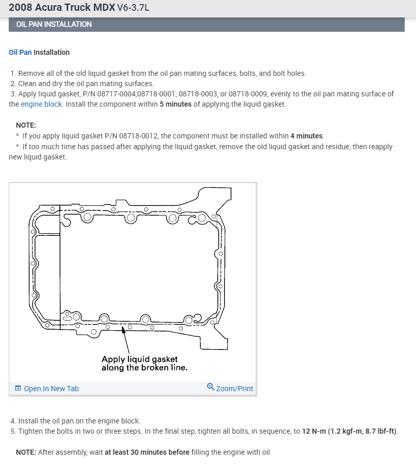

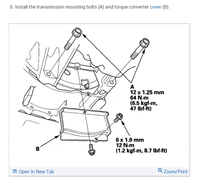

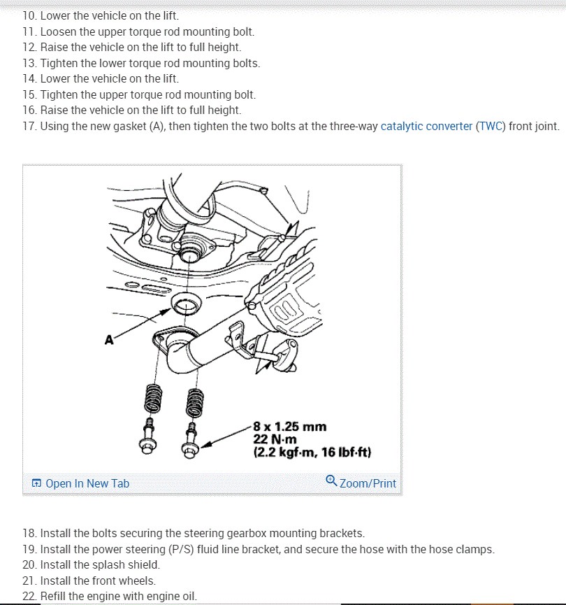

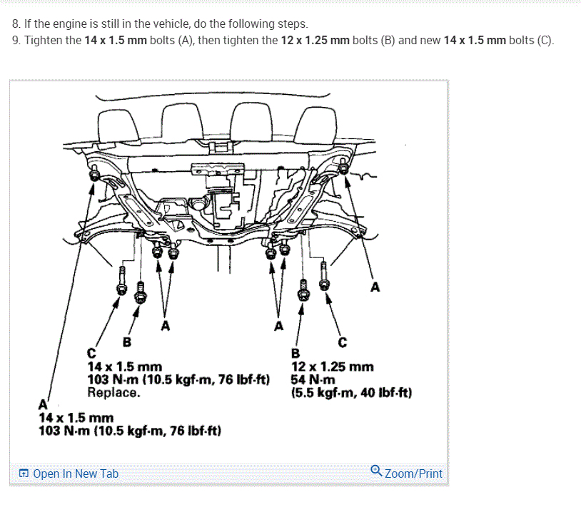

In order to remove the oil pan, you will first have to remove the splash shield, exhaust pipe, the three-way catalytic converter and the torque converter cover.
I have attached diagrams below for your reference.
It has torque specifications as well as the sequence for the oil pan.
Feb 18, 2022 at 9:17 PM

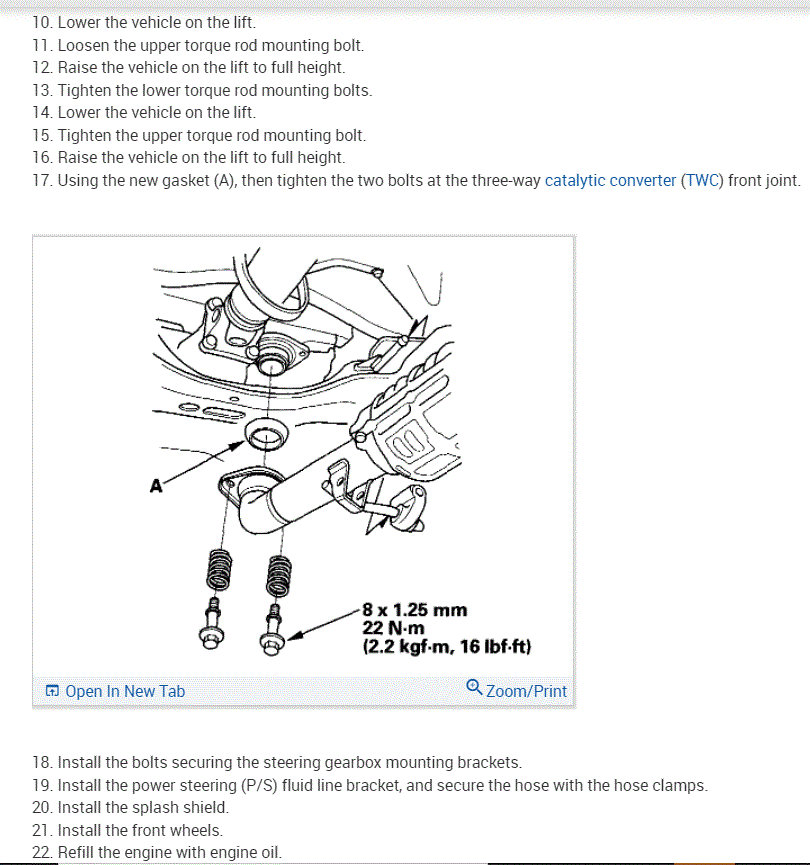

  • 110,194 POSTS

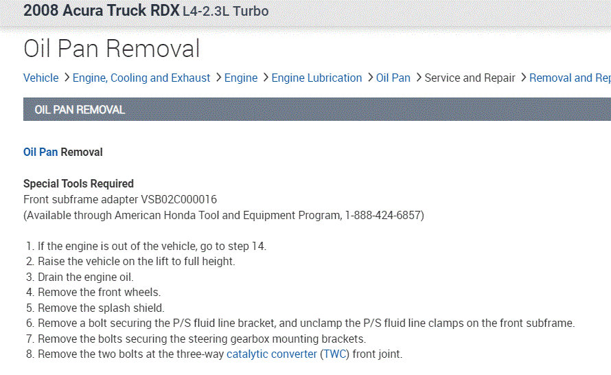

A portion of the exhaust needs to be removed, the inspection plate on the transmission, the three-way catalytic converter, the splash cover under the vehicle, and a few other small things.
I attached the directions below that are specific to the removal and replacement of the oil pan. Take a look through them and let me know if you have questions.

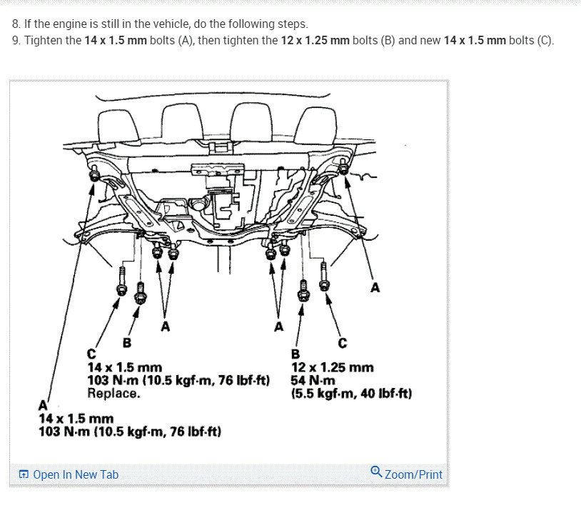

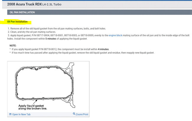

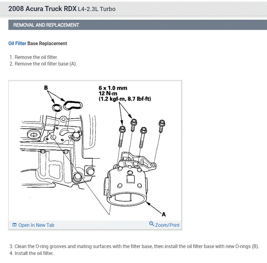

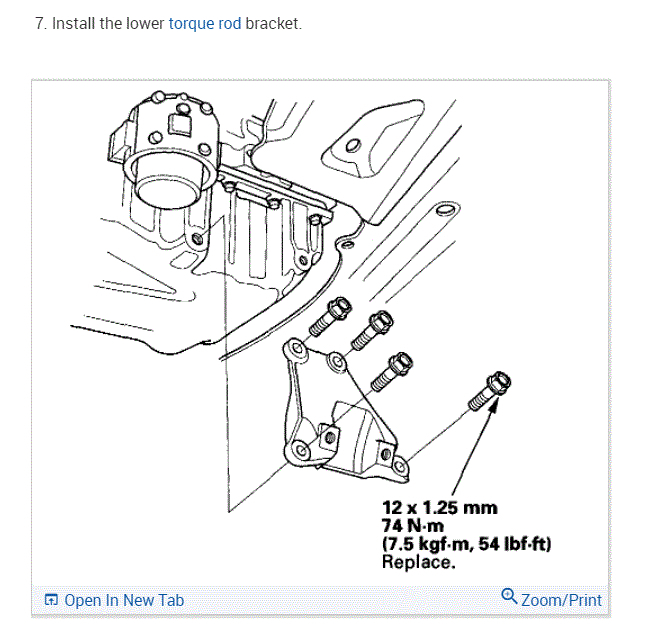

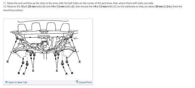

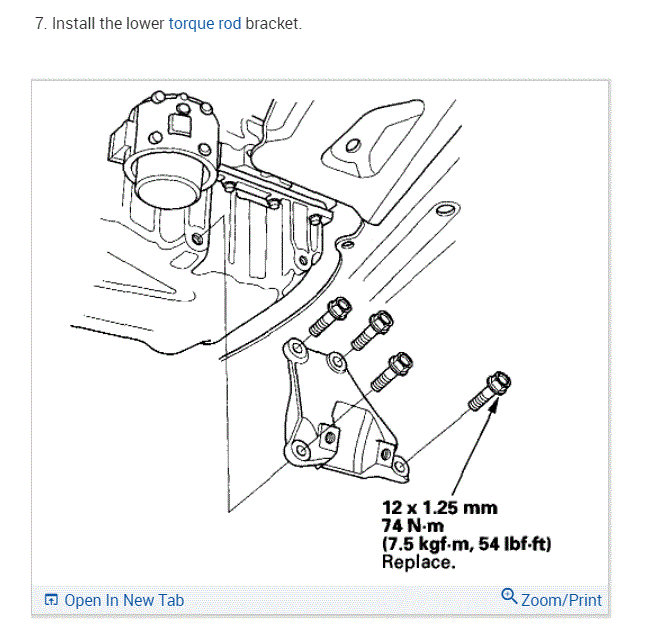

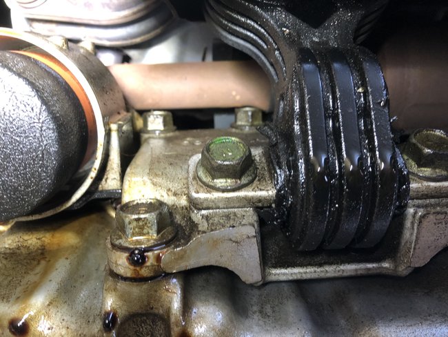

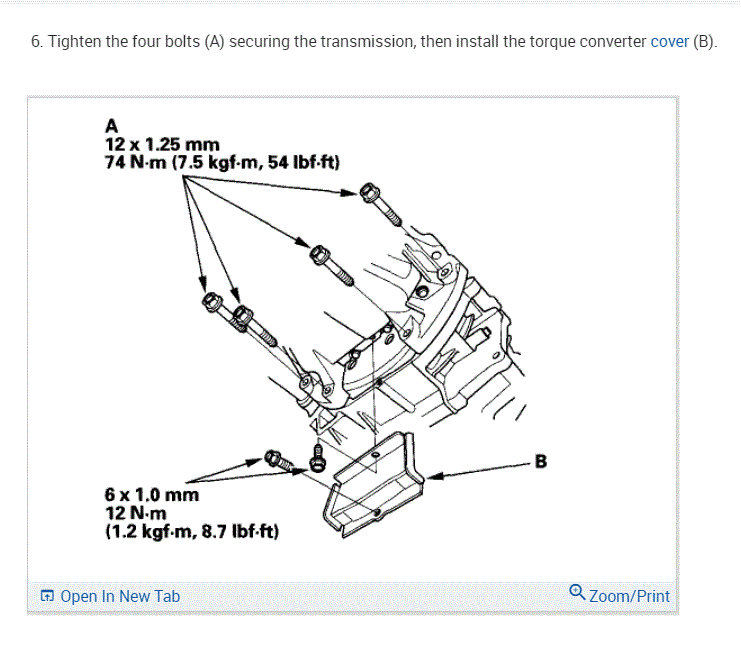

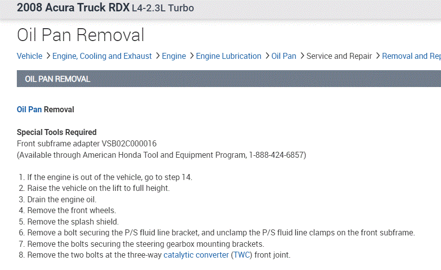

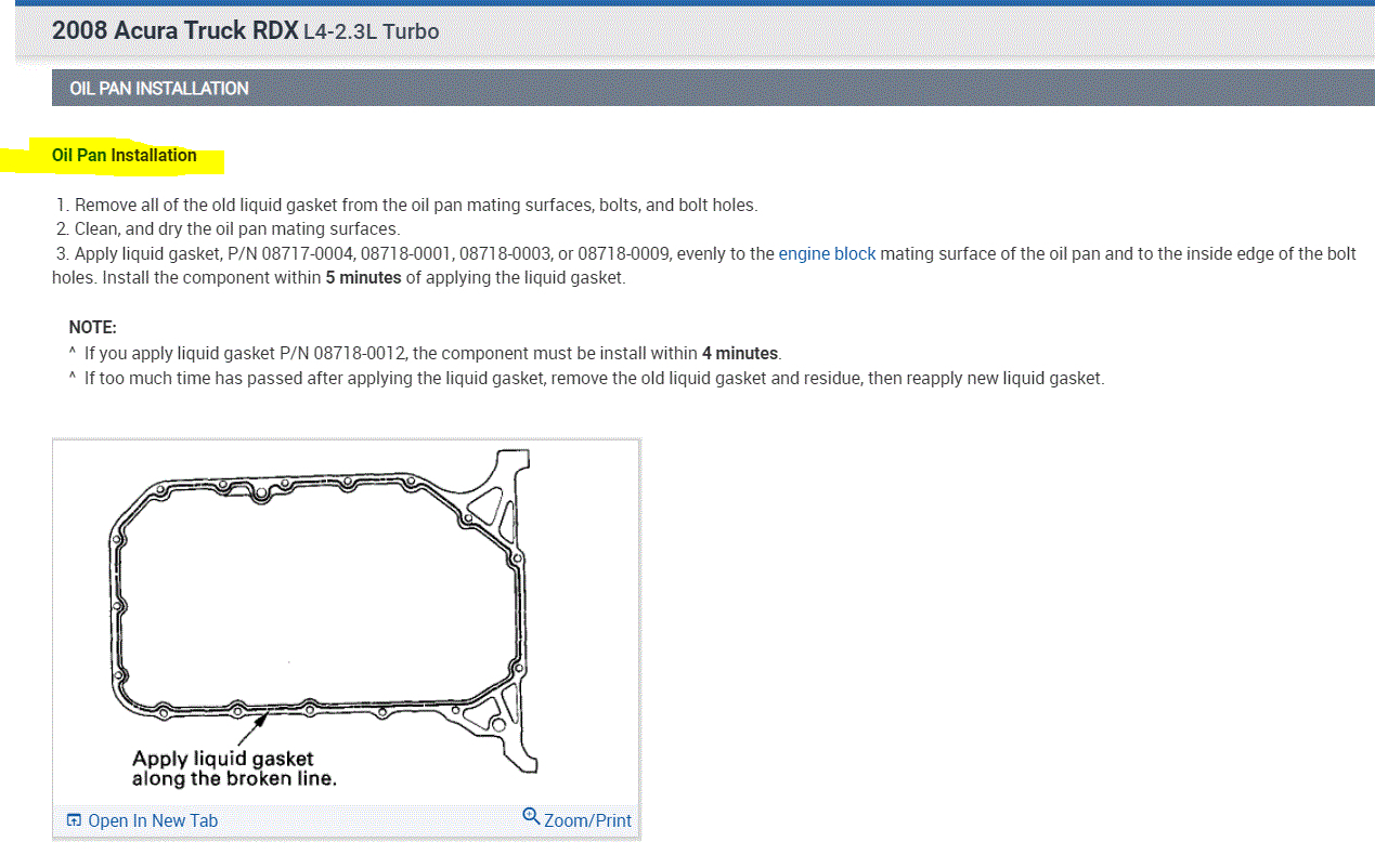

Hi, the car is an Acura RDX 2008. The images you've sent in are similar to several videos I have seen on YouTube, however when I took a close look at it, it seemed quite different. In addition to four bolts going to the transmission on the left, I also what appears to be an engine mount with the rubber isolators on the right side held on with very large bolts. On closer inspection, there were no pan gasket leaks on the rear pan but there was quite a bit of oil around the oil filter housing near the front side of the pan, which leads to to believe it is leaking from the housing or the filter itself. Would you have pictures on how to remove the housing?
Thanks!
Feb 19, 2022 at 1:03 PM
  • 110,194 POSTS

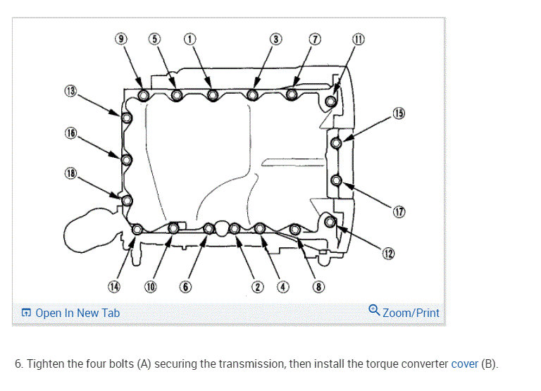

Yep, there is a difference between the MDX and RDX. I attached the directions for the RDX below.
If the pan isn't leaking, that's a good thing because the RDX is a bit move-involved.
As far as the oil filter housing, there are two O-rings between the base and engine block. They can leak. The last pic below shows how it's removed/replaced.
Feb 19, 2022 at 1:53 PM

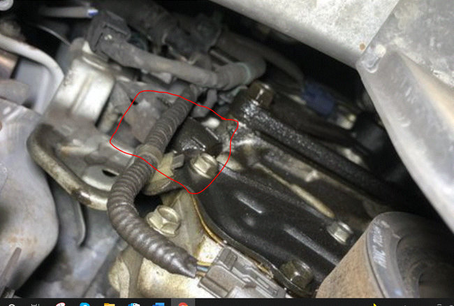

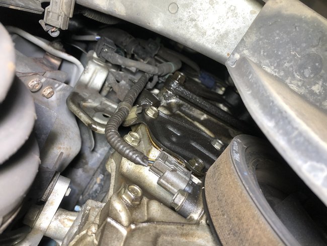

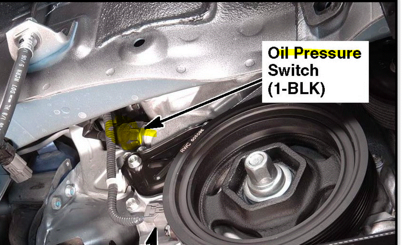

My bad, the bolt was there. I think I can get to the problematic bolt using an s-shaped 12 pt 10mm box wrench. Just order it from amazon as well as dye kit to really be sure. On another note, I see a minor oil leak on the upper right-hand side of the engine midway up above the harmonic balancer. Would you know what the source it? Is this the oil pressure sensor location or cam seal?
Feb 19, 2022 at 6:18 PM
  • 110,194 POSTS
That sounds like a plan. Let me know if you can get it off.
Also, the pic above leads me to the oil pressure sender switch. I attached a copy of your pic below and circled it. Also, I attached a pic from the manual.
When they start to fail, they will leak. Remove the connector to it and see if there is oil in the connector. If there is, replace it.
Let me know what I can do to help.

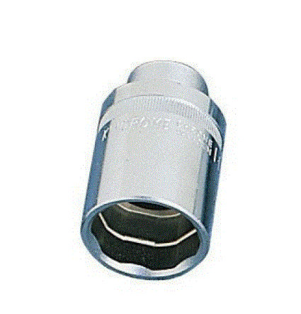

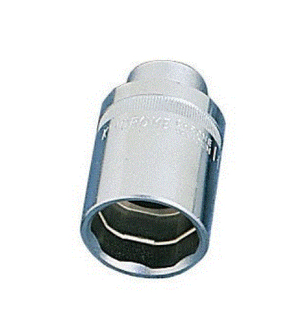

Hi, I am looking at the pic of the oil pressure switch you sent me. Do I require a special socket for it? It looks a little strange. Do I access it from above with an extension?
Feb 21, 2022 at 8:25 PM
  • 110,194 POSTS
Some do require a socket designed for the sensor. I attached a pic below. When the new one comes, take it with you to a parts store and they will have what you need. It's really common.

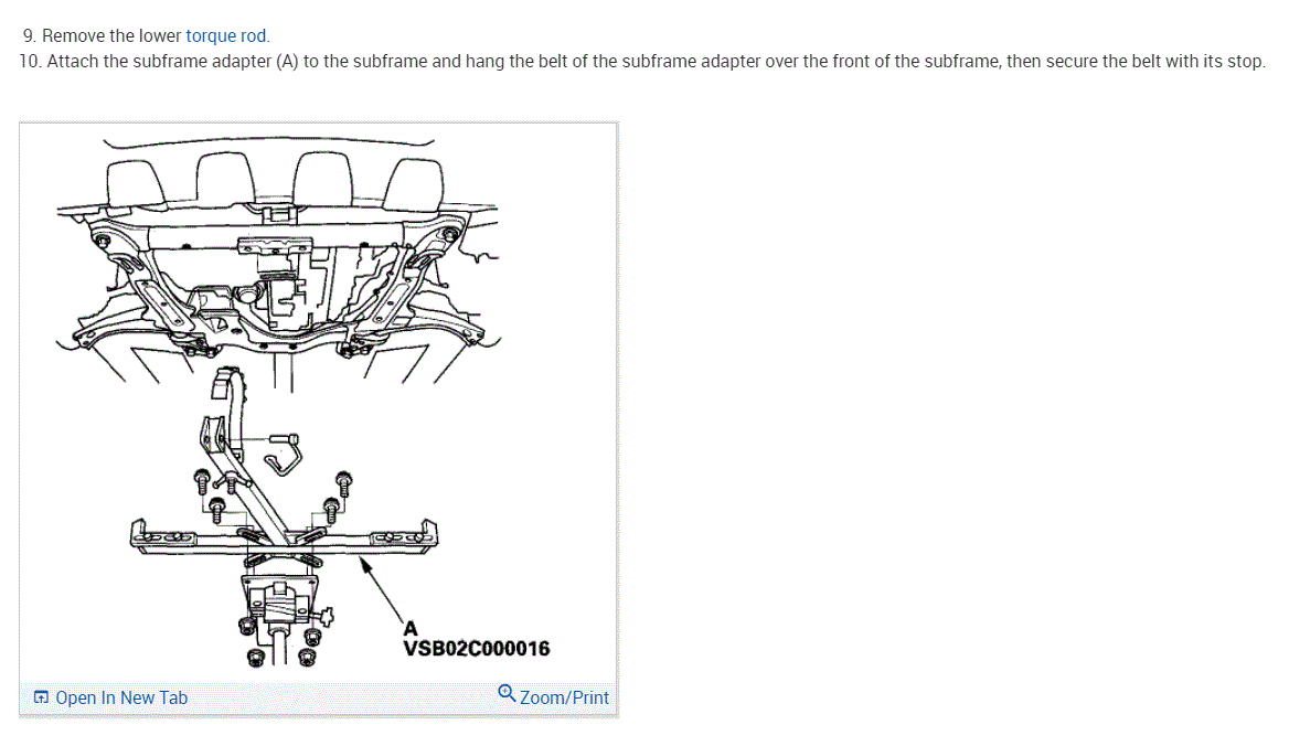

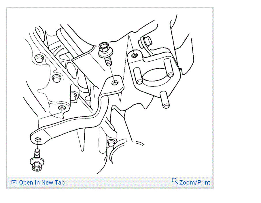

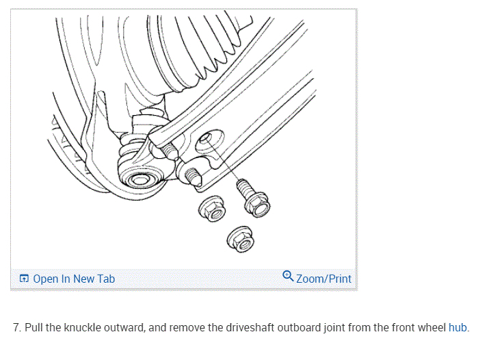

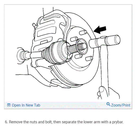

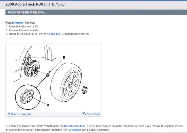

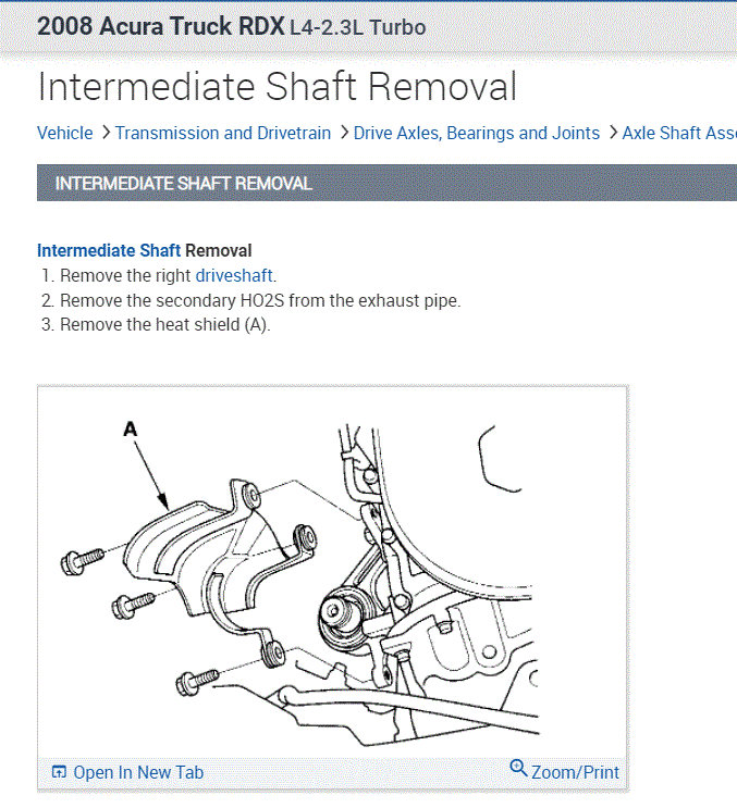

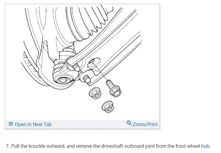

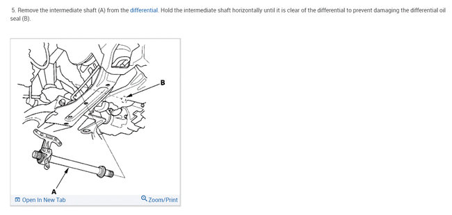

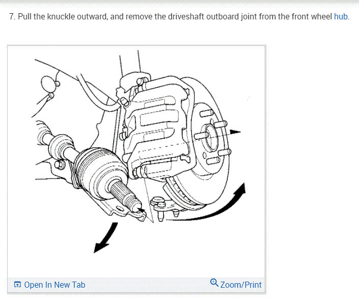

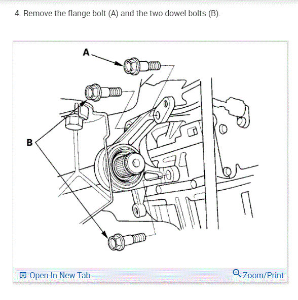

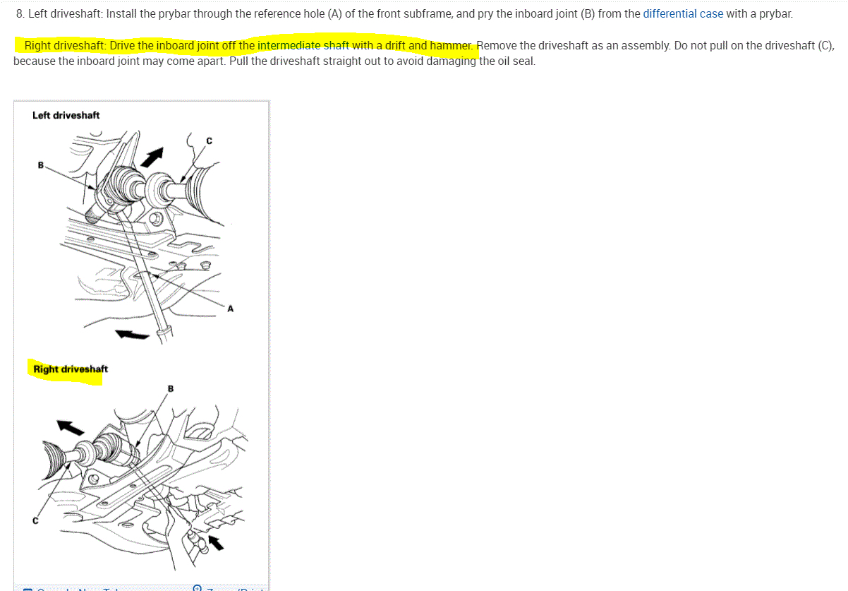

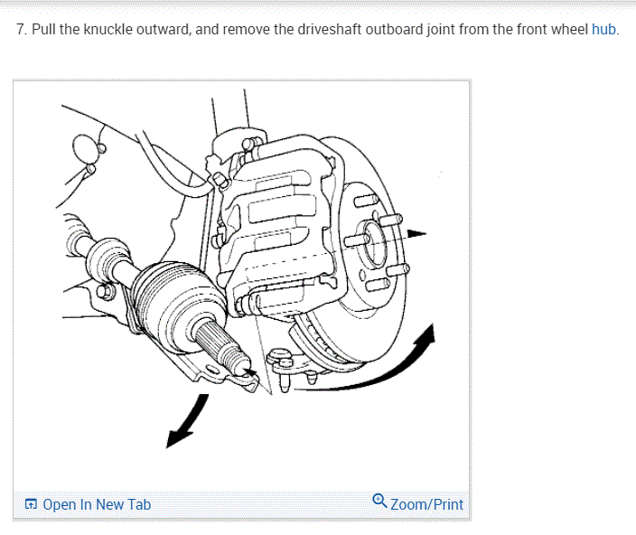

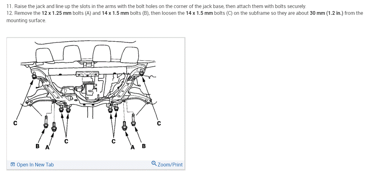

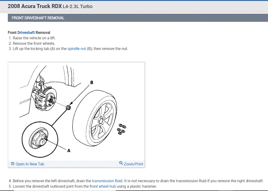

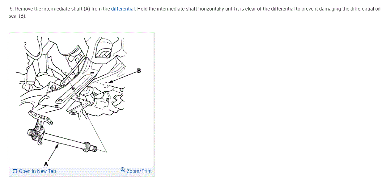

Hi, unfortunately the curved 10mm wrenches do not work for the oil filter housing so I will have to remove the intermediate shaft. Would you have instructions and diagrams of what entails to do this? Initially I am thinking I have to remove the strut bolts, the lower ball joint bolts and the axel nut to get the outer shaft out. I am not sure how to remove the intermediate shaft. I see several 12mm top and bottom but not sure where the intermediate shaft bearing support bolts are. I can see only one from the wheel well.
Thanks
Mar 5, 2022 at 4:11 PM
  • 110,194 POSTS
If you look below, the first three pics are specific to the intermediate shaft removal. The remaining pics are general directions for the removal of the axle shafts.
When you remove the axle nut at the hub, it should be replaced with a new one when you put it back together. If you can't get a new one, I recommend using Loctite.
Mar 5, 2022 at 7:48 PM
