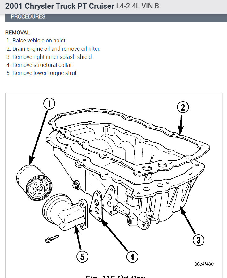

I just discovered an engine oil leak at the oil pan rear mating surface, so I need to replace the pan gasket.
I have searched around the net but curiously find nothing, which makes me wonder whether anyone has replaced this gasket. Has anyone done this before?
Any and all comments would be appreciated.
Jan 25, 2023 at 5:12 AM
  • 55,616 POSTS

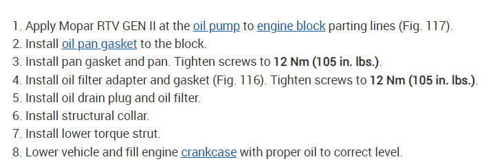

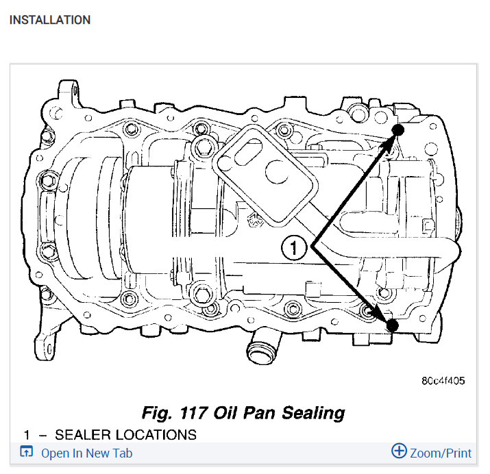

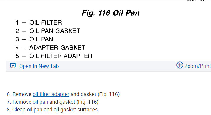

The oil pan gasket is pretty easy to change on this car here are the instructions below and the part number for the gasket.
42 - Oil Pan Gasket - #4777994AA
Check out the images (below). Let us know if you need anything else.
