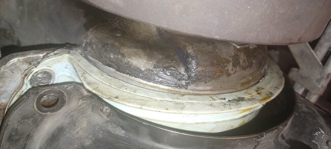

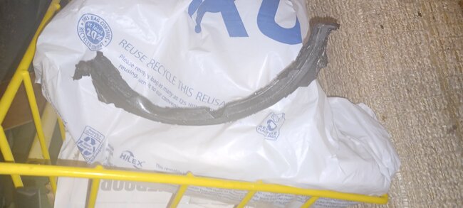

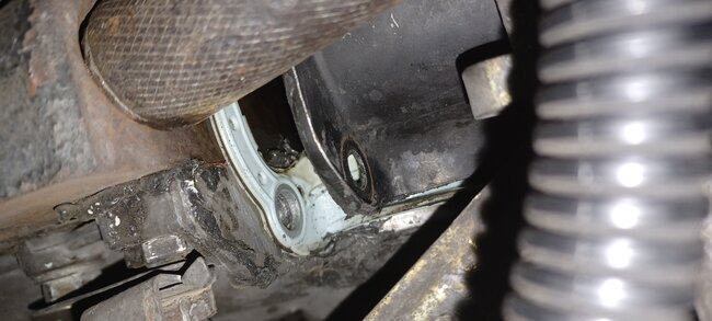

I saw that there was rubber hanging at the transmission side of the oil pan. I replaced that gasket 6 months ago with Fel-Pro. I then pulled out or removed part. Looked like seal came apart. I jacked up motor and lowered the pan some, an entire blue part that you see, that bottom of gasket was fully intact all around it including the curve at that end.
Some how the lip edge separated at far end from main flat gasket.
Is there any way to reattach that part? I did notice mesh or metal felt at that end. I may need to replace it all but wanted to ask if I can RTV rubber to rubber there...
I know replace is best but wasn't sure if RTV to rubber will hold. Wondering why it separated.

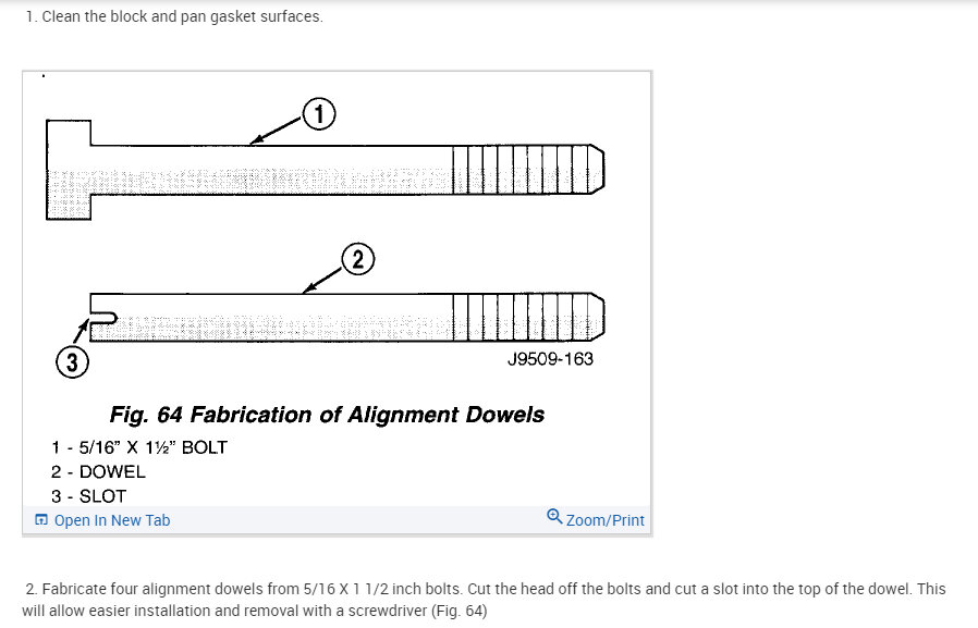

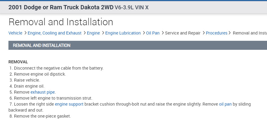

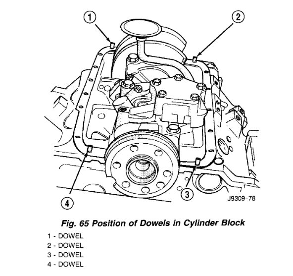

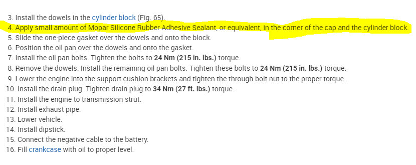

It appears it moved while you were installing the pan. Also, they recommend using a silicone rubber adhesive sealant, or equivalent, at each corner of the block along with dowels to hold the gasket in position.
Take a look at the directions below and let me know if they help. Also, based on the pics, it should be replaced.

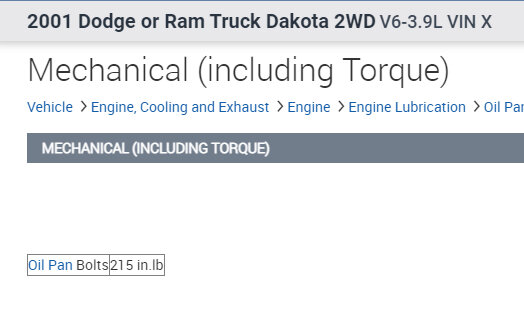

The last pic provides the torque specs. Please Note that the specifications are inch-pounds and not foot-pounds. As far as a sequence, it isn't provided. I always snug them all and starting from the center of the pan, work outward equally on each side.
Let me know if this helps.

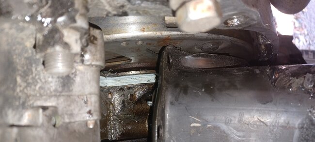

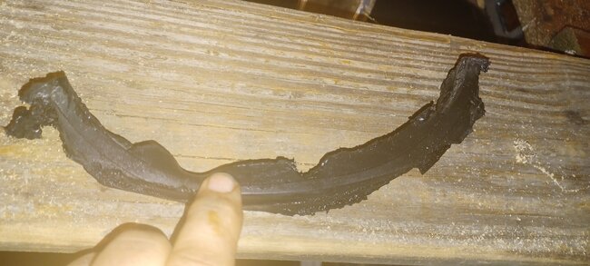

I just now got to it and jacked motor up, and found out somehow the old part that was installed 5 months ago before new one, was maybe still lodged in it at front of pan? That is a front gasket part. Seems crazy. i did my best to get everything out and i see the entire new blue Fel-Pro from 5 months ago is fully intact! And all four corners where RTV is intact.
Can i get away with reinstalling pan back since there were no breaks in gasket and it's still in place?
Of course, I'll feel in pan for any loose pieces and wipe surfaces clean first.
And is 17.9 ft correct in a zigzag from middle out?
Oct 17, 2022 at 11:08 AM
  • 110,194 POSTS

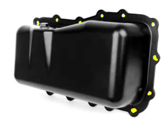

It really matters what type of gasket it is. Some rubber ones can be reused. Anything that has cork in it shouldn't be reused. Just make sure it isn't crushed or damaged in any way. Also, since the engine needs to be lifted and this isn't the most enjoyable job, you may want to consider just replacing it. And yes, the torque is 17 ft/lbs. Actually, it works out closer to 18, but 17 will be fine.
Here is a recommendation. When you tighten the steel oil pan, by nature where the bolts enter through the pan and pull upward toward the engine, that spot will become convex. You want that to go in the opposite direction, away from the engine in a concave manner.
What I always do is inspect the bolt holes and make sure they are either flat or slightly bent away from the engine so the gasket can completely seat. On my workbench, I have a section with plywood. Using a ball peen hammer, I gently tap the bolt holes away from the engine side of the pan.
Don't laugh, but the pic below shows the side of the pan that the bolt holes should be peened toward.
See pic below.

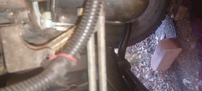

Do i have a second seal on timing cover or does that oil pan gasket seal it? Note the timing kit i bought w the gaskets had no bottom rubber part. online a few kits did include it but it may have been on different engine..
Oct 17, 2022 at 8:09 PM
  • 110,194 POSTS
The pic you attached appears correct. At the bottom of the timing chain cover, the oil pan gasket should seal against the cover.
