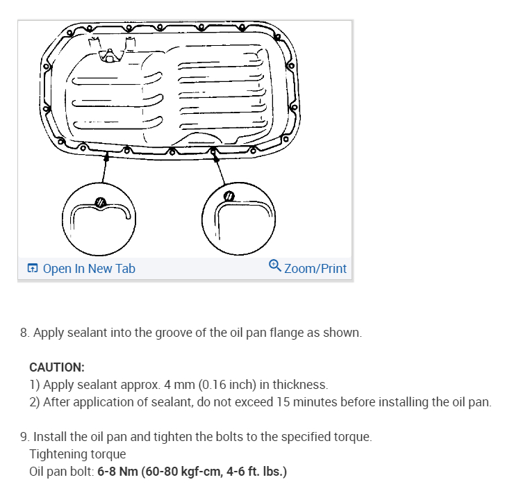

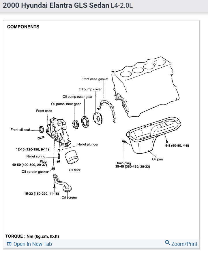

Fixing oils leaks. Just purchased this car. If you can send me torque specs and steps on replacing oil pan gasket. thank you
Aug 18, 2023 at 11:59 AM
Experienced Mechanic
55,746 POSTS
Sure, here is how to change out the oil pan gasket with torque specs. Check out the images (below). Please let us know what happens.
