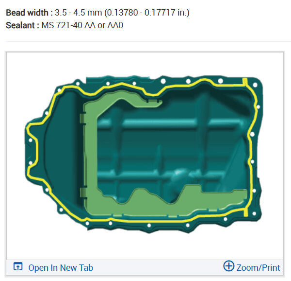

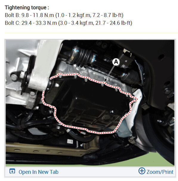

Where can I get these? Ours are missing. How many plastic clips vs bolts? When we got the car only 3 plastic clips were holding it on, and no bolts. It’s hard to see which hold are for which.
Apr 12, 2025 at 6:03 AM
  • 55,433 POSTS
Is this a 2024 and there are no oil pan bolts, did you remove them? Here it shows the number of bolts, their size and how to torque them down. Check out the images (below). Please upload pictures or videos in your response of any problems so we can see what to help you with.
