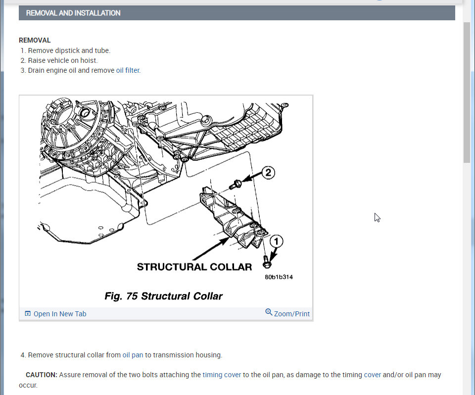

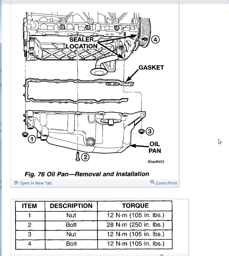

Are the bolts all the same size and are there really two on the front side of motor?
Apr 11, 2021 at 2:41 AM

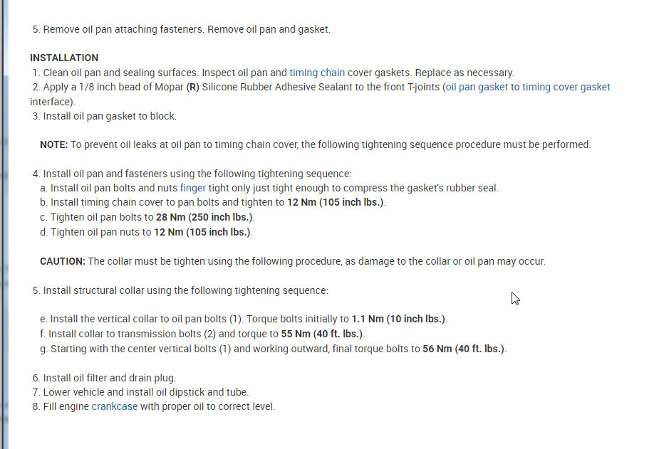

There are bolts all around the pan but the ones in the corners should be nuts that tighten down on studs that are in the block.
I am attaching the process from the manual that will help answer your questions. Please review this material and let us know if you have other questions. Thanks
