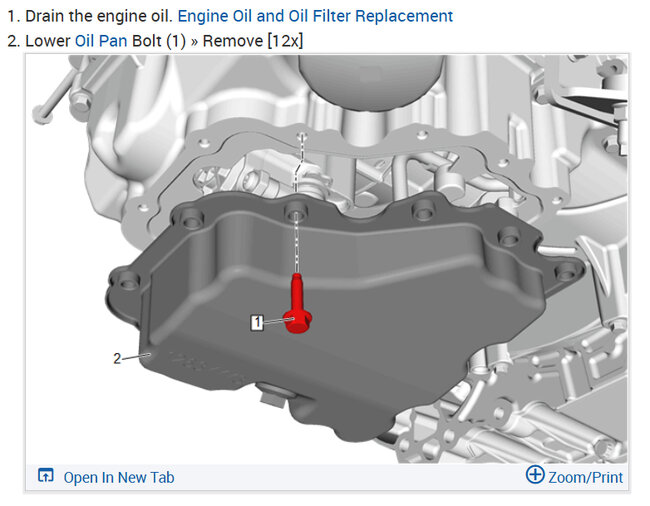

need to recheck those torque valve. I snapped off a bolt head when torquing to 18 foot pounds. so it needs to less than that please recheck 89 pounds is way too high

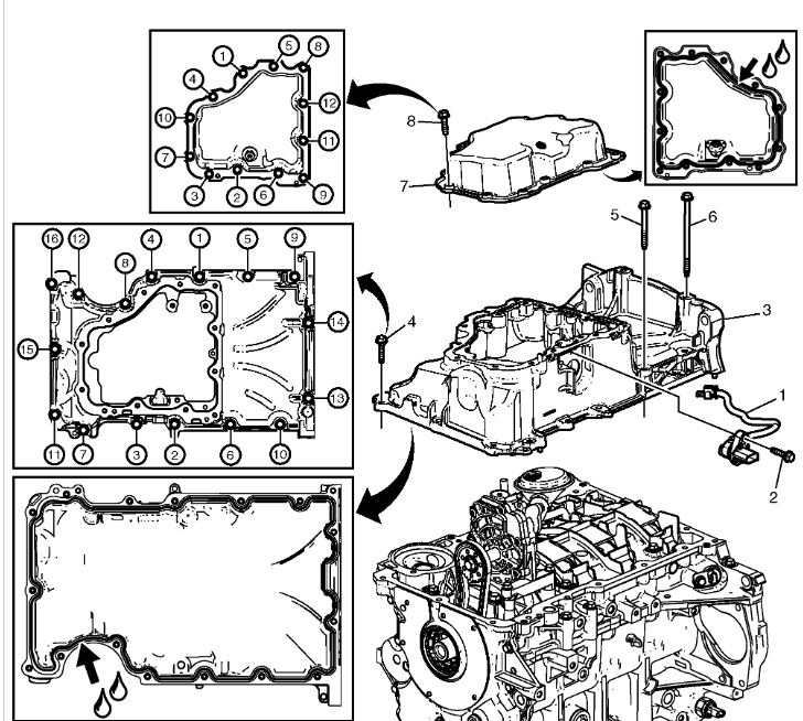

Torque valves and torque sequence of the oil pan bolts

Sure here is the engine oil pan upper and lower tightening sequence and torque spec.
10 nm - (89 in pounds)
Check out the images (below). Let me know if you need anything else.

Yep, you are correct, those are inch pound not foot pounds.
