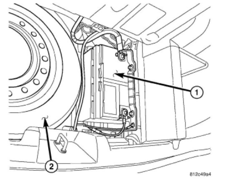

1. Disconnect negative battery cable (1) located in trunk.

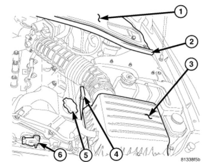

2. Remove engine oil indicator (4).

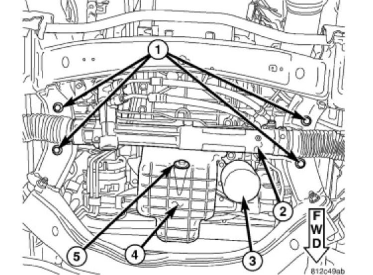

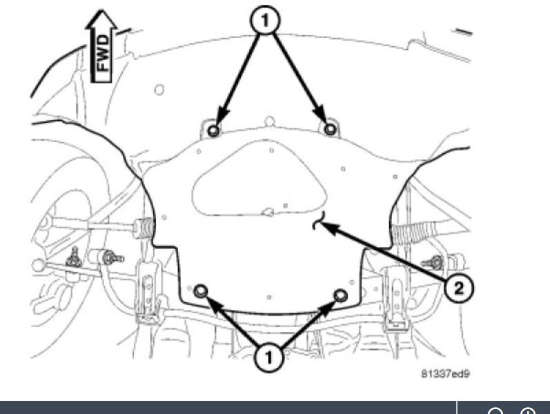

4. Remove lower splash shield retaining bolts (1) and splash shield (2).
ImageOpen In New TabZoom/Print
5. Drain engine oil (5) and remove oil filter (3).

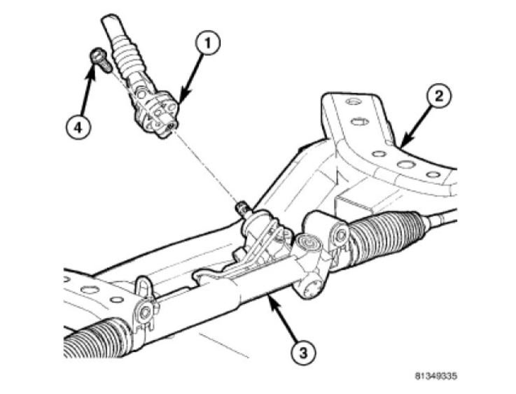

6. Remove the steering coupler bolt (4) and separate coupler (1) from rack (3).

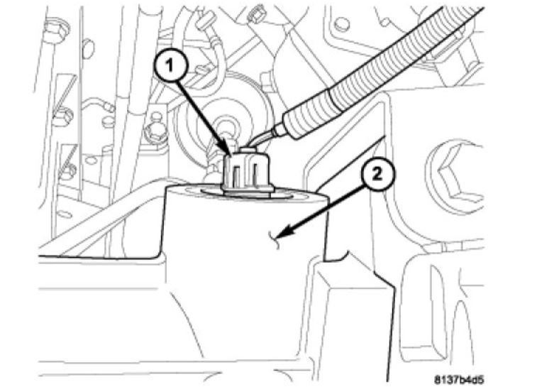

7. Disconnect power steering pressure switch electrical connector (1).

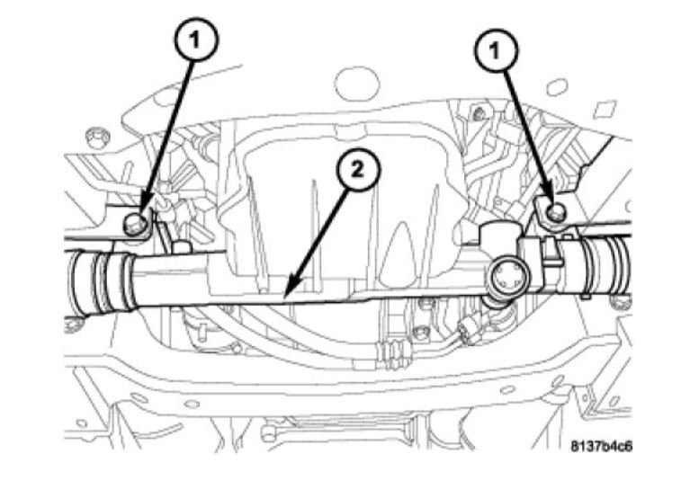

8. Remove steering rack mounting bolts (1).

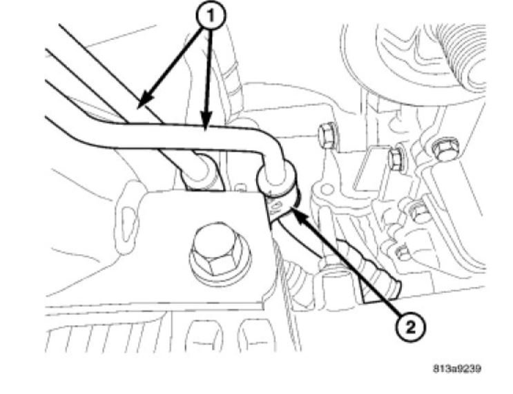

9. Remove power steering line support (2) from frame.
10. Reposition rack out of the way.

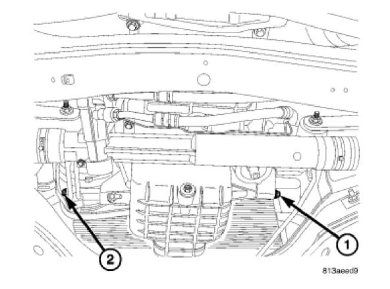

12. Remove mounting bracket to oil pan lower bolt (1).
13. Remove A/C compressor bracket to oil pan lower bolt (2).

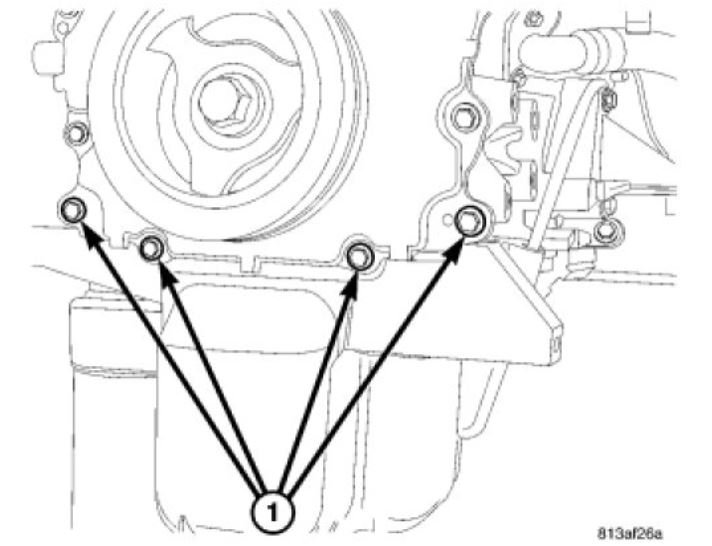

14. Remove lower timing chain cover to oil pan bolts (1).
CAUTION: Assure removal of the four lower timing cover bolts, as damage to the timing cover and/or oil pan may occur.
15. Remove oil pan and gasket.
