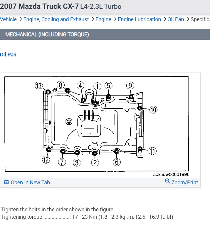

I need to know, how much torque (ft•lbs) is needed on oil pan’s bolts and the order in which should be torque.

Sure, here are the oil pan torque specs and the order in which they should be tightened down:
Tighten the bolts in the order shown in the figure.
Tightening torque .................... 17 - 23 Nm (1.8 - 2.3 kgf.m, 12.6 - 16.9 ft.lbf)
Check out the images (below). Please let us know if you need anything else to get the problem fixed.
