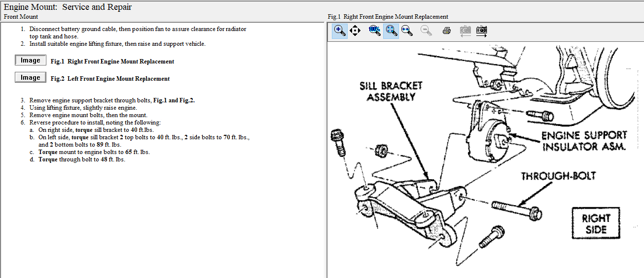

front left side of differential housing rubbing on front of oil pan up and down going to put blocks in springs to lift body/engine up to stop rubbing/hopefully/until i figure out what to do.

hello,
you feel any vibration at idle, it seems engine mounts are defected that its seating position lowered that touches the differential housing. can you send us some pictures? check fig 1 for complete procedure how to replace engine mount.
This is our guide how to replace engine mounts:
https://www.2carpros.com/articles/replace-motor-mounts
let us know what happens with you.
