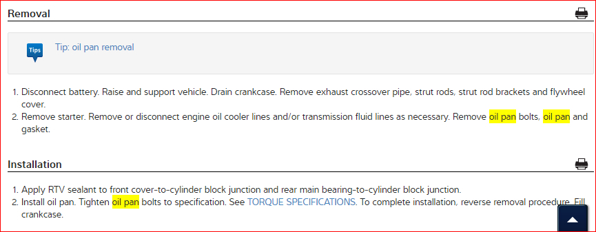

Need a video for replacing a oil pan.

Hello, I am Danny,
I have attached a step-by-step guide on how to remove and install the oil pan. Hope this helps and feel free to ask any questions.Thanks for using 2Carpros.
