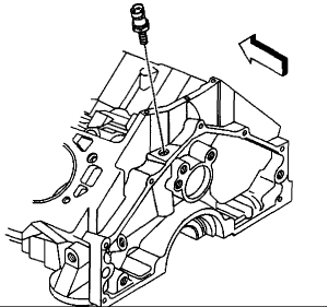

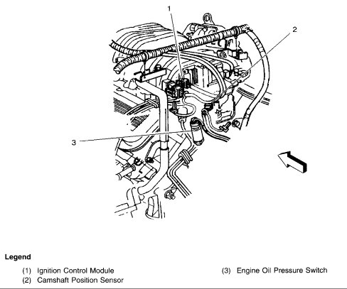

I have a work horse 7.4 liter and had the oil changed it calls for six quarts of oil and they had put seven quarts in it and I did not know until I drove it and it started smoking and leaking oil. I drained about a quart out but now I have oil leaks and my oil pressure gauge shows zero pressure when it idles and below 40 when driving it, plus my check gauges light comes on when it idles.
What kind of damage could this have done?
It seems it is leaking out or around the oil sensor.

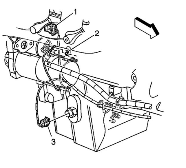

Hi and thanks for using 2CarPros.com. Honestly, it sounds like the oil pressure switch itself has failed. I personally cannot imagine the over fill caused it, but that does not mean it is not possible. What is happening is the sensor/switch is leaking from the crimp. The result is loss of oil and an indication of lost pressure. The pressure should still be fine, it is just reading low because of a leak at the sensor/switch.
Should the shop be responsible? That is a tough call. I have no prior knowledge of the vehicle that could lead me to believe it was or was not leaking already prior to the service. I do not know if this helps or not, but if you were a regular customer at my shop, I would replace the sensor (which is not expensive) to try and make things right. That is me.
If you decided to do it yourself, here are directions and pics to locate the component.

Disconnect the electrical connector from the engine pressure sensor/switch.
Remove the oil pressure sensor using J 25254-10A.
Installation Procedure
Tools Required
J 25254-10A Oil Pressure Sensor Socket
Install the oil pressure sensor.
Hold the oil pressure sensor fitting with a wrench to prevent from turning.
Using J 25254-10A tighten the oil pressure sensor to 30 Nm (22 ft. lbs.) .
Install the electrical connector.
Let me know if you have other questions. Also, I would like to know how things work out for you.

Not that it is not a big deal at all. Over filling the oil is not a good thing, but it will not cause the sensor to start leaking. The pump produces only so much pressure regardless. Now that does not mean they did not damage the sensor in a different way.
If they say bring it back, that is a good thing. That is what I would have done.

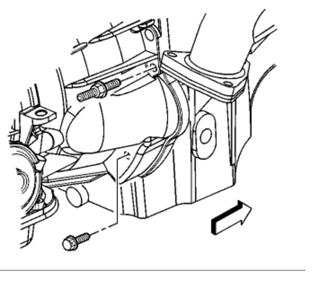

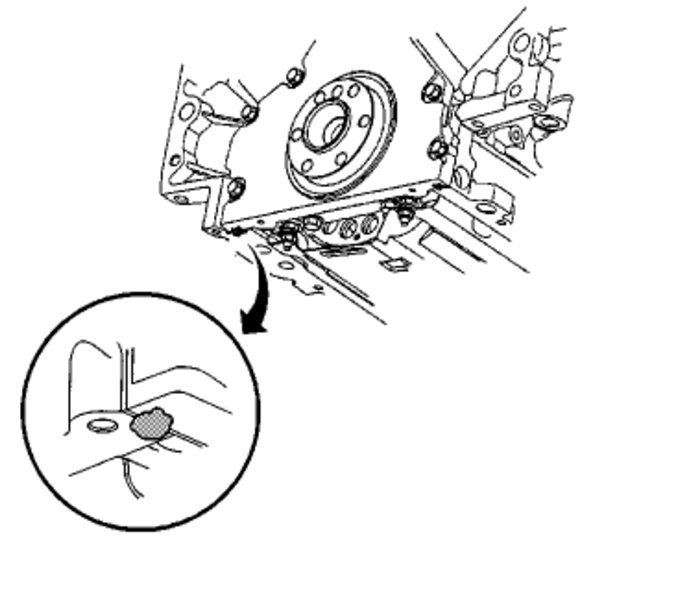

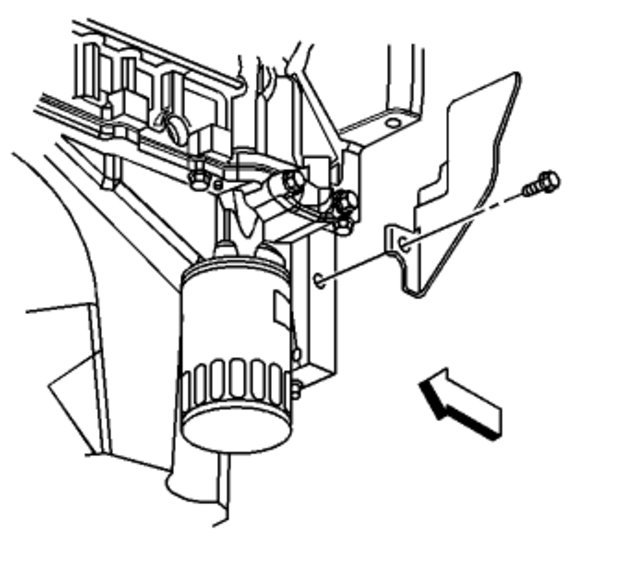

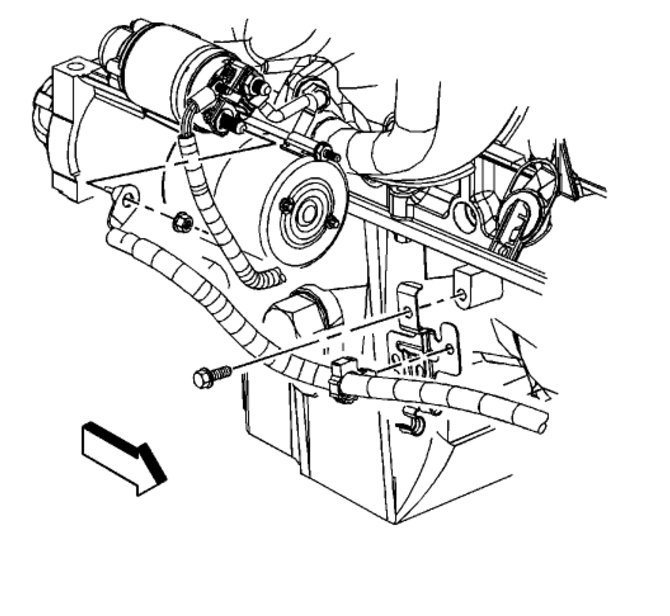

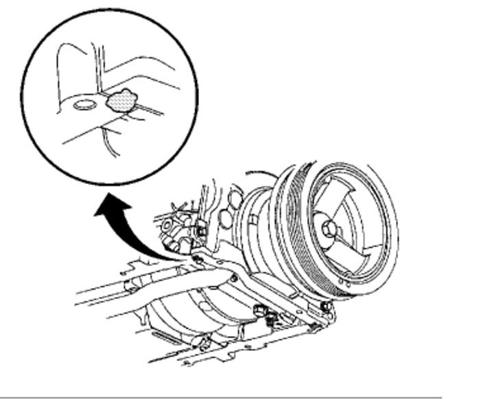

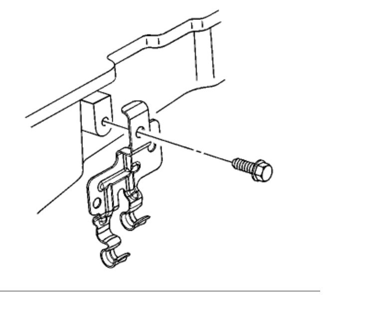

They replaced the oil sending unit, but my oil pressure reads very low after the engine warms up. Starts at 40 and drops down to like 5 or 10 any ideas on whats causing this?
Could the oil pump have been effected?
Everything was fine before I had them change the oil.
They used 5w 30 is this maybe to light an oil?
Jun 17, 2018 at 8:18 AM
  • 55,423 POSTS

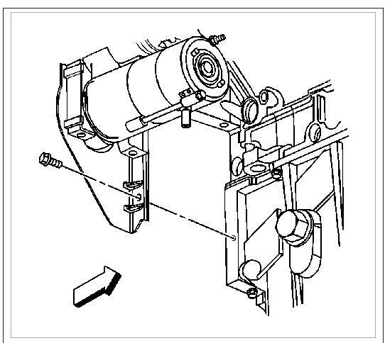

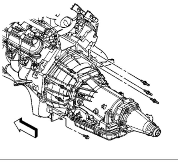

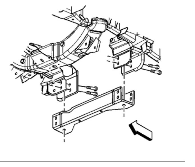

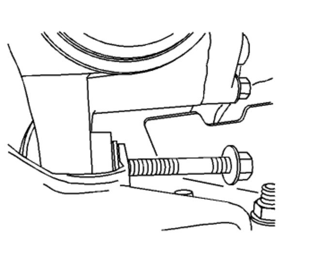

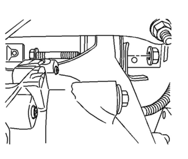

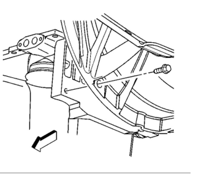

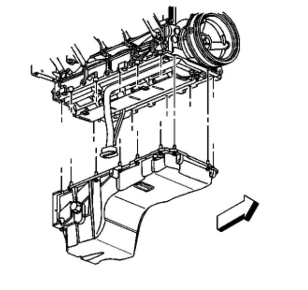

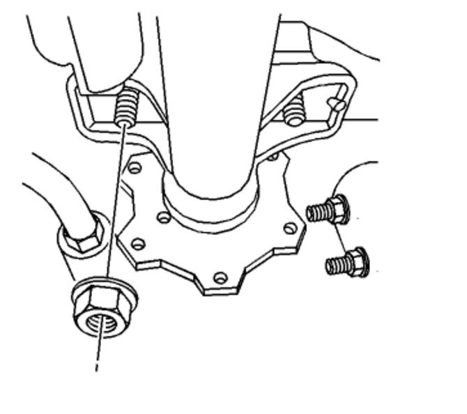

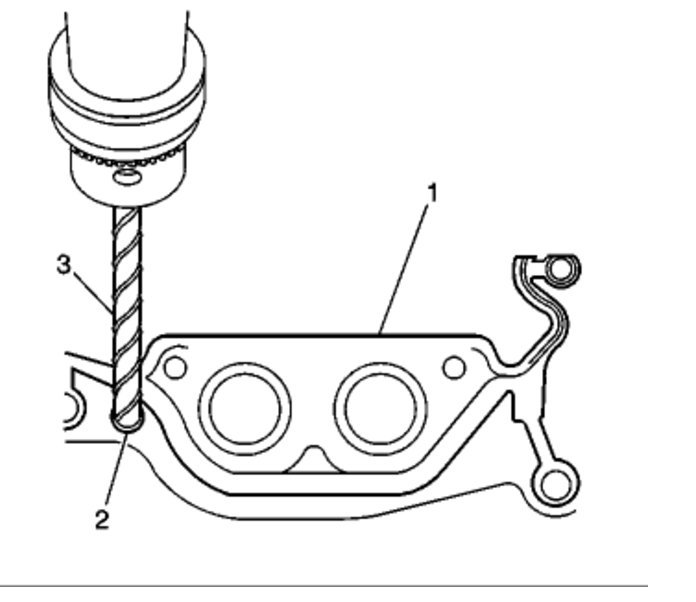

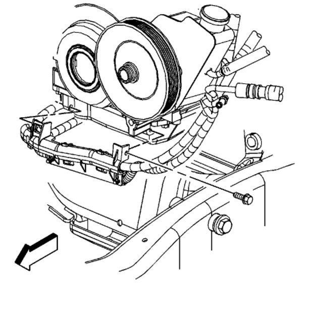

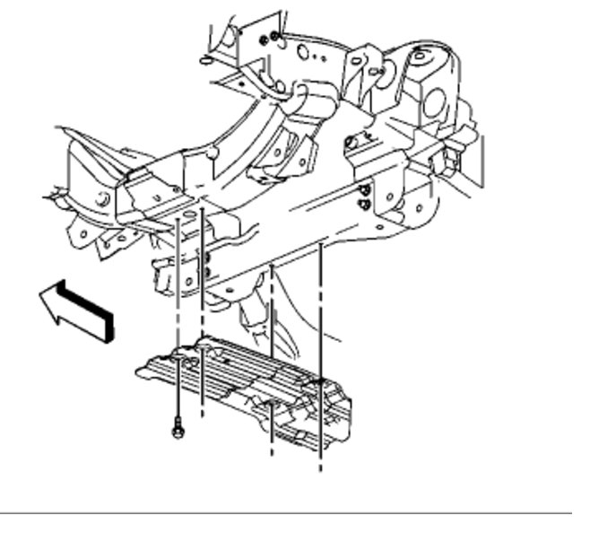

One of two things could have happened either the oil pump regulator spring it stuck or the oil pump pick up is clogged. Either way the oil pump must be changed. Here are diagrams to help you with the job.
Check out the diagrams (below). Please let us know what you find.
