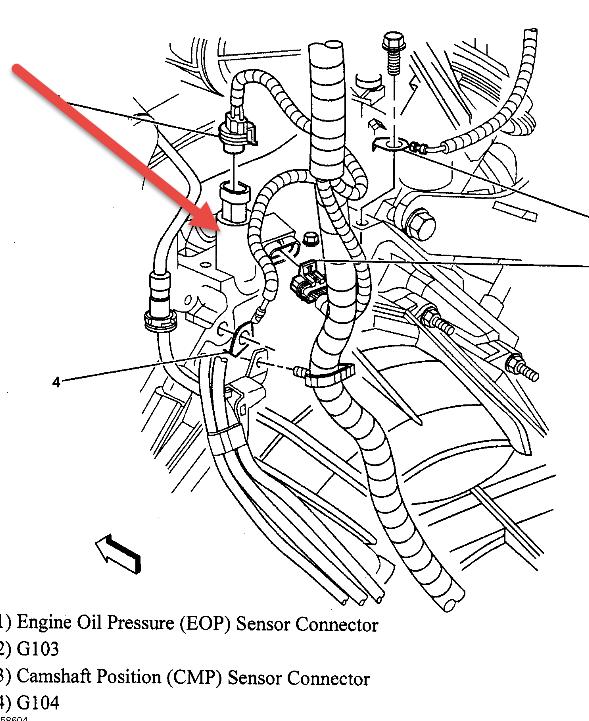

Oil gauge is pegged out and even when its cold it stays that way?
2006 CHEVROLET TRUCK
125,000 MILES • 4WD • AUTOMATIC
CRESH
We were pulling in the brush with our pickup, and all the sudden the oil gauge pegged, we quickly shut it off and checked our oil, it was good we let it cool and when we started it it pegged again and that is where it stays?

check to see if the wire on oil sensor is hitting block or is grounded. otherwise it may be a bad dash

Thank you so much! Now can you direct us to the oil sensor? its location..

at rear of engine block see pic
